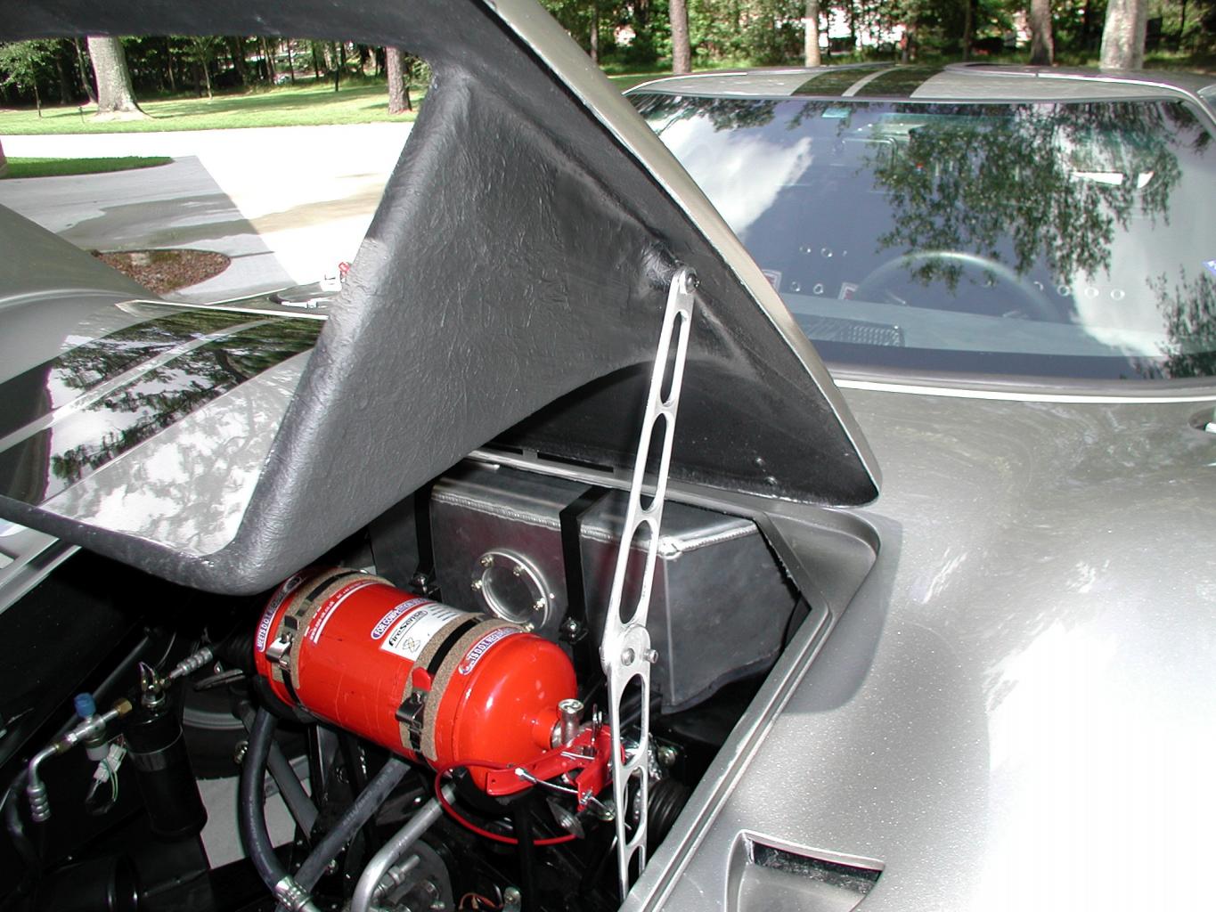

I added a front 'hood' prop on my car. Olthoff sells them, but you can get them almost anywhere. See pic.
Rather than drill a hole through and just put a bolt like I've seen others do, I just fiberglassed in the mount for it. Looks tidy. No holes drilled.
Are you calling me a jerk?
Just kidding... I, too, have taken the front clip off and on myself, but only after I had the prop installed. You definitely have to be careful!
