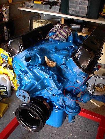

You can also distiguish it by the bosses that stick out of it like mine below (except mine is a D1ZM)

Thanks for the info guys, after further checks it does confirm it to be a "Mexican" ........
