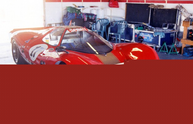

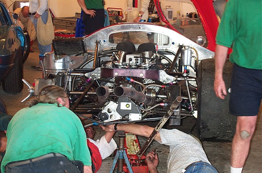

following you find a quite current (three months old) picture of the GTP-13, prior to painting. More current photos are coming soon.
attachment.php
Best regards,
Leo.

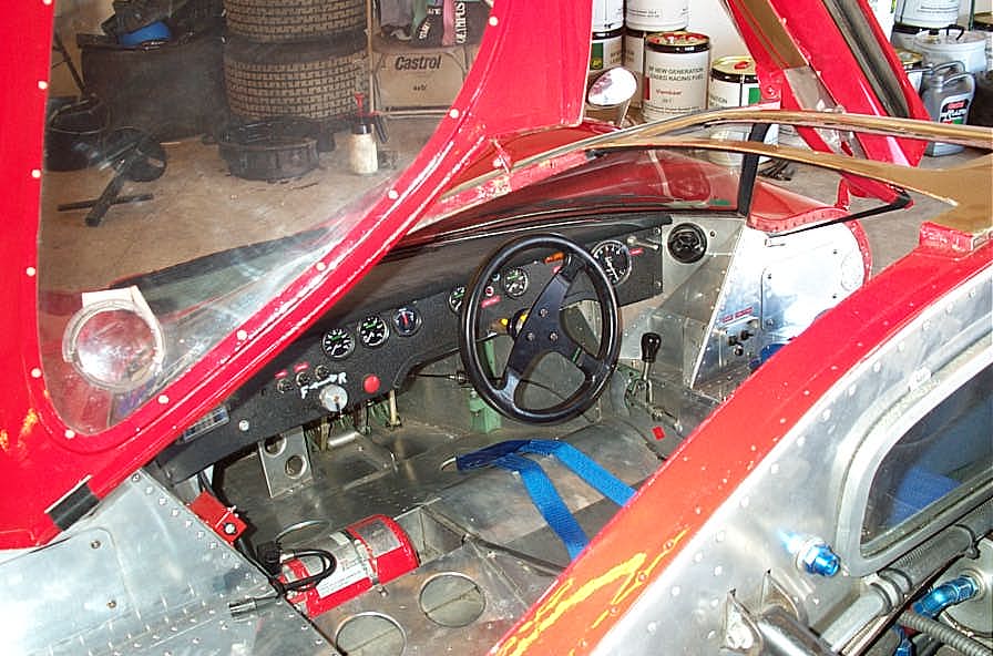

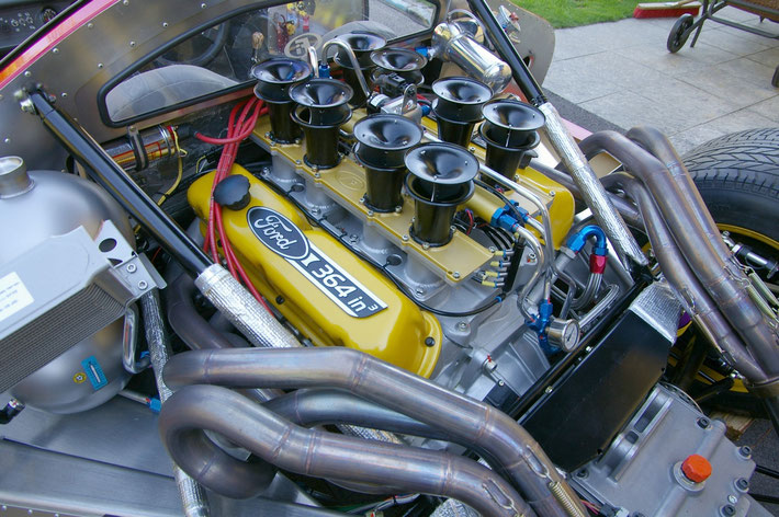

Thank you, gentlemen, for your nice answers.
Since I have been asked a few times now about the major differences between the GTP-13 and the historic Ford F3L: I have set up a > webpage < which compares some facts about the two cars. As you might expect I don't have that much data about the F3L, however I do hope this comparison gives some answers.
As some other news we have finally installed the hoods above the air inlets, which gives the engine bay a little different look.
attachment.php

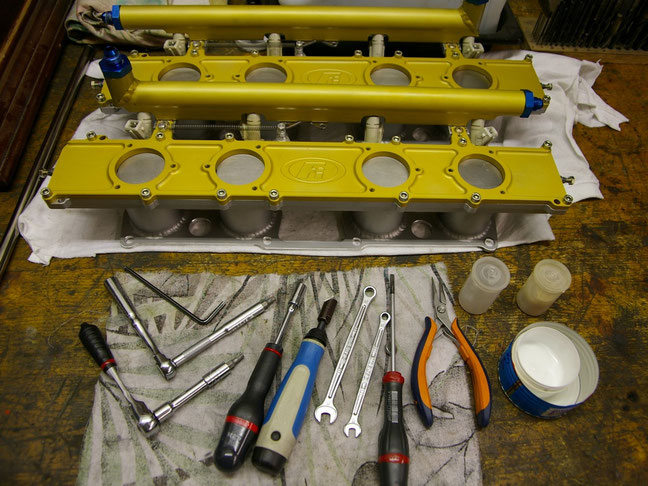

Further since some of you guys asked me for details about the GTP-13 slide throttle: I just recently came across this picture of my 2nd-generation design where you can see the throttle plate, actuator arm and return spring.
attachment.php
