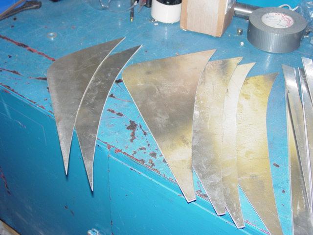

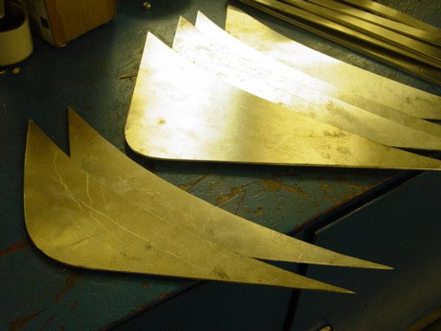

Fran's got an excellent start on what I was planning and will probably buy Fran's parts and modify.
Here's what I had in mind (borrowing Fran's picture):
have a look at the ones on the work bench...they are already shaped like that.......two styles ...look closely
Fran - You're right - I did not look close enough at your semi-finished materials on the bench. The contour I have I think is a little different but accomplishes basically the same thing..

Your canards look a very good interpreatation of what I have seen elsewhere. Can you confirm that I am right in thinking that the thickness of the ali plate (more than 1/16 inch by the look of it) is increased to prevent flex etc as the plane of the canard is flat instead of curved and has no end plate, for a want of a better word?
