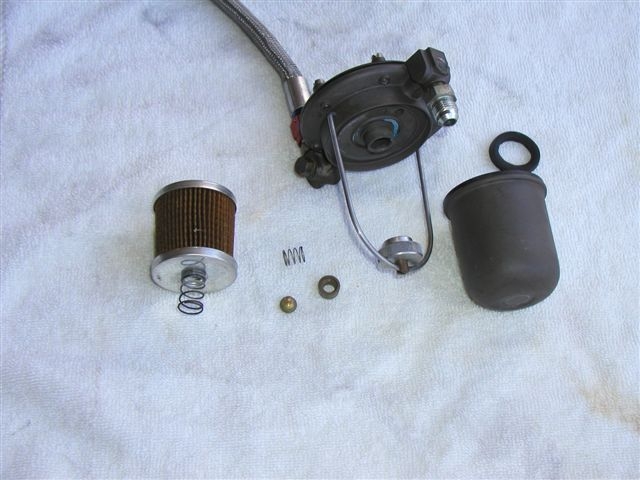

I took the filter bowl off my fuel filter/pressure regulator housing to discover a small spring, brass plunger and sleeve at the bottom of the filter. Obviously this is a problem. If anyone is familiiar with it, can I simply press it all back into the top of the housing or is there something I'm missing? It is an Italian made Filter King unit.

Hi Vekk,
What can happen on these Filter King / Malpassi regulators is that the plastic retaining collar can get pushed out when turning in the fuel pressure adjuster screw. The collar and spring it retains end up in the filter bowl and you have no pressure regulation. No leaks however, just fuel pressure at whatever the pump is doing.
The collar can be reinstalled and carefuly "staked" to hold it in place. A close look at the bore the collar sits in will reveal the original stake marks. I've seen this happen several times, sorry I didn't take pics of the last one I overhauled. You should be ok with three radial stakes to pinch the end of the bore. The spring goes in the top side of the bore, under the diaphram.
It's a bit fiddly a job, unless your plastic collar has fractured you should be ok. The part is available new from www.europaspares.com although I have stock here if you need one.

Thanks Ian, surprisingly, it looks like mine was never "staked" so I guess that's why the push out. Can I assume the concave side of the bushing goes toward the plunger when I reinstall?
There are no marks whatsoever. I spent some time in the the auto parts store and nothing looks like a close match to the filter. I'm now trying to find a car that had the Malpassi Filter King stock so I can reference it to something.

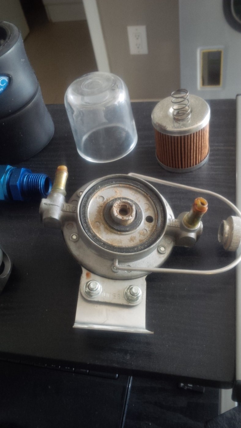

Hi John, always happy to help forum members sort out fiddly bits to avoid a tow home or buying new parts, if a simple repair can restore original operation. Here's a pic of a Filter King regulator showing the "stakes". Pretty heavy hits, cannot say if these are original or some got to this one before I opened it up. Be careful staking the casting to help retain the plastic molding. Uou don't want to crack the plastic part. Cheers
