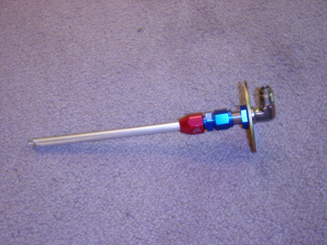

Maybe I should be making something like this? Seems like alot fittings
to make a pick up. But how else do you get to the bottom of your tank?
:shrug: Anyone got any ideas? I like to keep it simple.

Ended up sending picture of pick-up (above) to my local speed shop
and he can supply all needed for $40. Problem solved I suppose.
