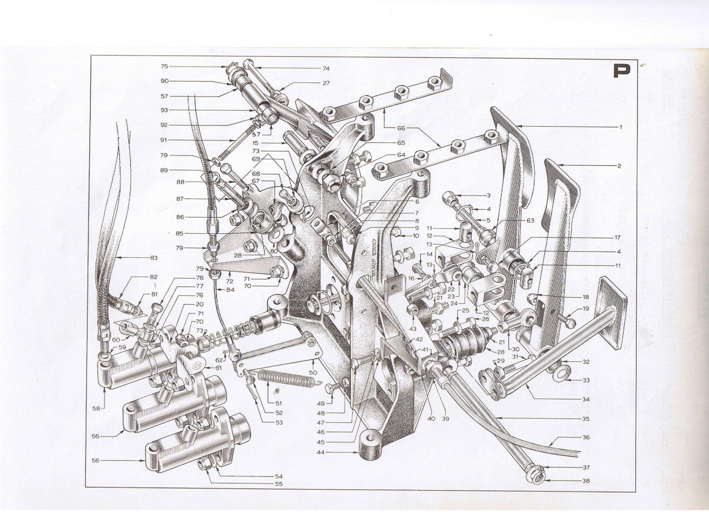

If my interpretation of photographs and drawings is correct the handbrake merely pulled the foot brake pedal down via a cable.

this is copy of the original brake pedals - note the handbrake cable. would not pass modern day requirements!

Ron McCall built an entire separate emergency brake system for my GT40 that works very well and looks great. It wasn't easy nor cheap, but if you want photos and description PM me and I will give it to you.
Hi Peter and Jim. Thanks for your response to my questions :) I see that I will have to "modify" the original system since I really want to use the old Girling calipers ( still need some). I just dont know yet whether I want to use the Anglia or Zephyr handbrake, but I think there is plenty of time to decide that before I actually have to. Jim: thank you for offering the plans of the system you have build, and I am looking forward to the time when I will need it. I have looked at your build log with great interest and I admire those of you that have come so far with your projects. This is without doubt a major job, but it must be all worth it in the end :) my greatest respect Regards: Jonny
