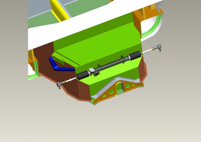

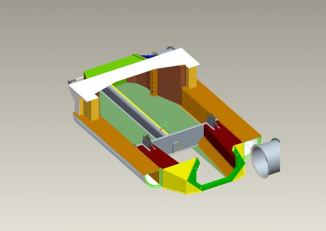

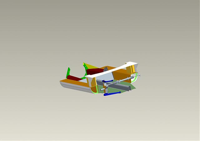

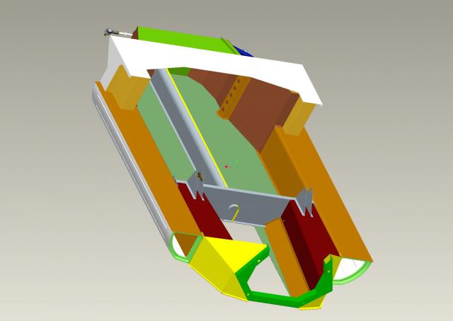

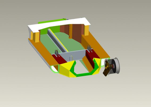

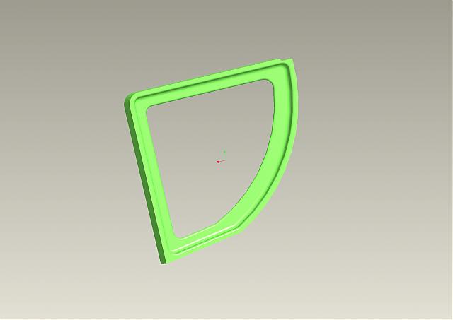

Watch the development of a Mono from CAD models thru FEA, suspension dynamics to finish.

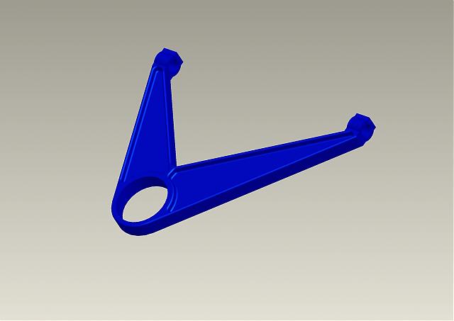

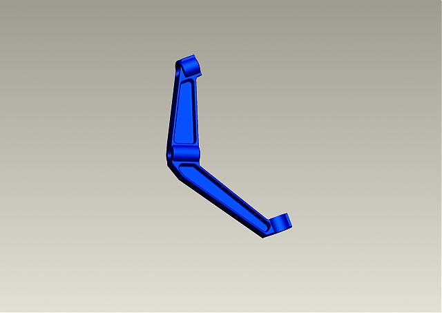

more bits

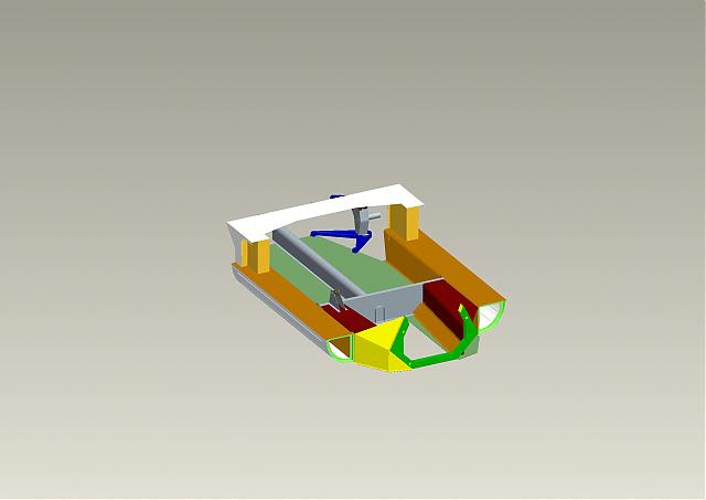

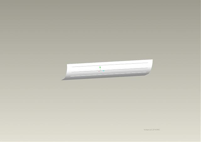

some more progress
Trevor Booth
Pro Engineer WF 3 , ANSYS FEA . The model still has a lot of flanges for welded joints etc to be added and cutouts for overlaps to be tidied up.
I have not made any sheet metal parts as yet. Currently sorting suspension before finalising the pickup points and necessary reinforcing on the tub.

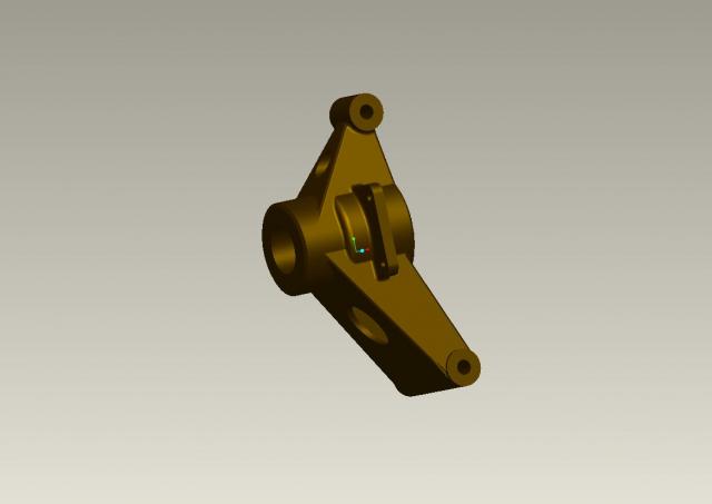

Hi Trevor,
Are those upright's copies of the originals?
Would you mind sharing them for private use, possible for a small fee?
