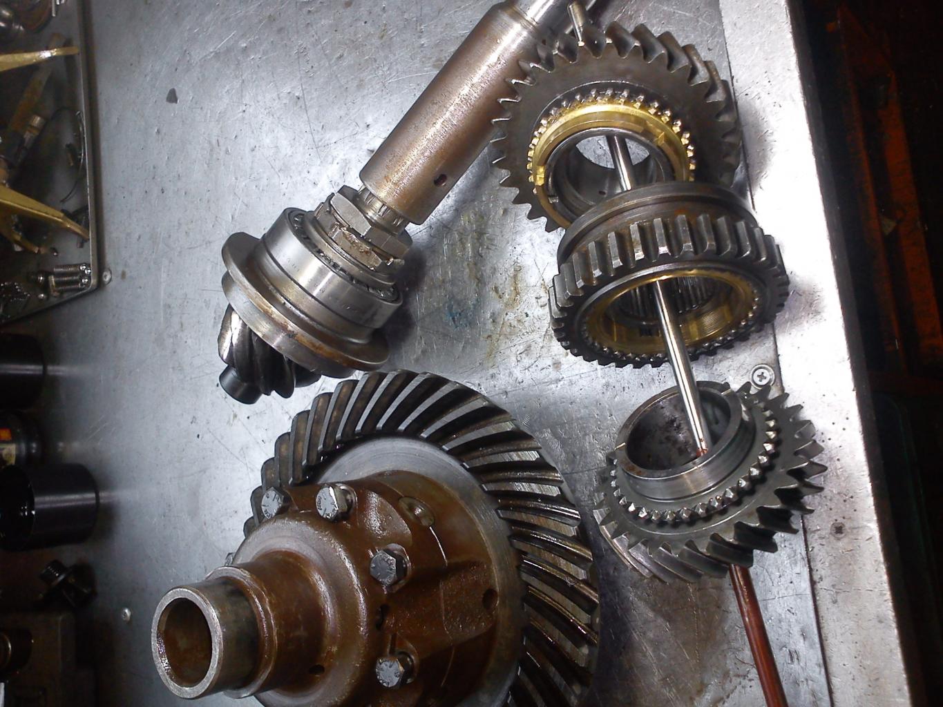

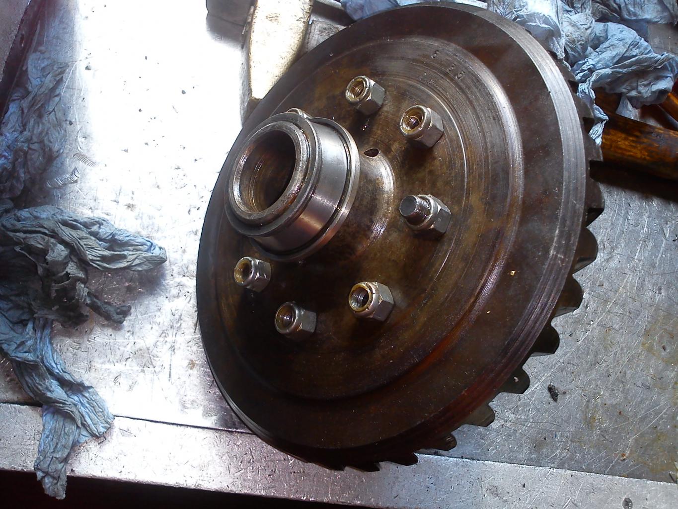

Hi, my name is Martin, I am working on a late 60 ies GT40 replica with chevy small block engine and a unknown gearbox which is broken....
There is a "ford" sign on the crown wheel, but I cant find what model and year is it...
Can anyone help me please identify the parts by the pics

I think you are working on the MKIV Ford GT built by Ross Baker here in NZ many years ago.. The large gears shown are the ring & pinion from an early Ford V8 as in early-1934/39 Side Valve models. These gears are the basis of most Quick Change rear axles as used by Sprint Cars etc in Stock Car racing today. Do you have pics of the input & layshaft gears plus housing to help ID the rest of the parts and which parts do you require? I wont or don't have them but if I can ID them will point you to a source.

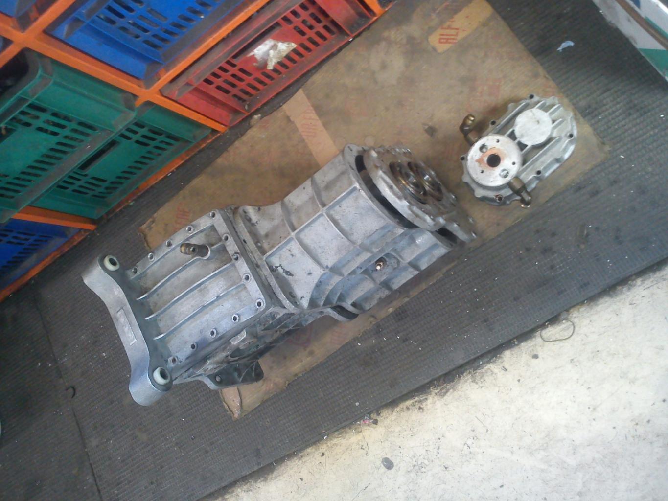

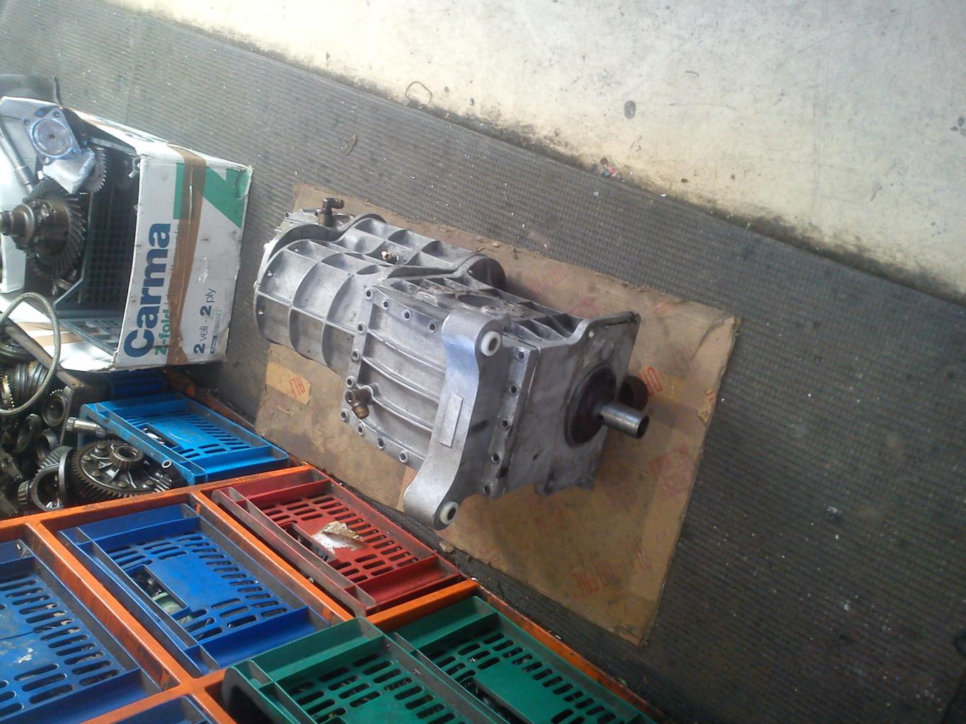

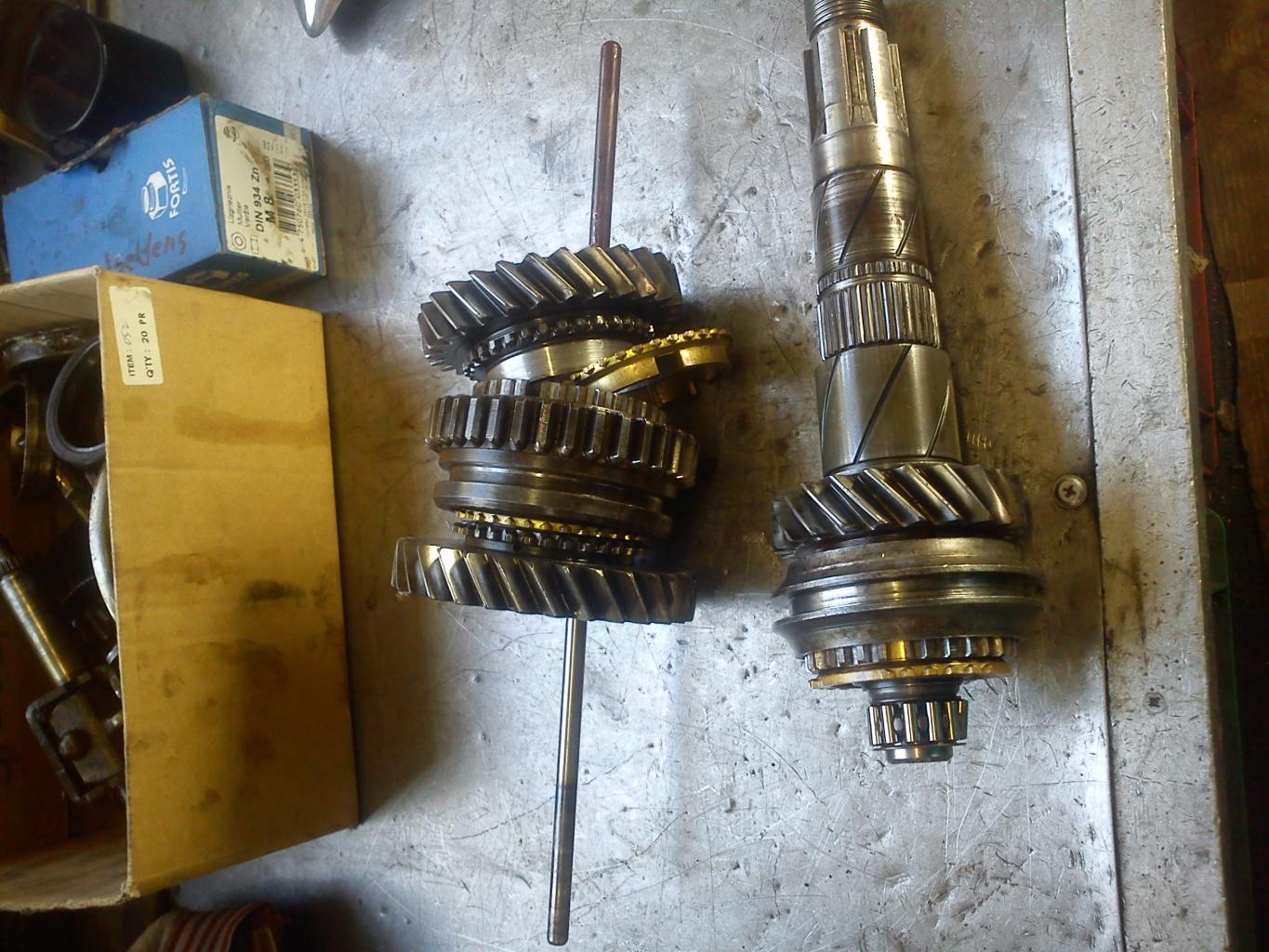

Some more pictures....
input shaft have been extended, splines are like ford, jaguar....
You can see that it is not factory made and the case casting is quite rough too

Hi Martins, What has actually failed in the transaxle that you need to fix or repair??? is it jumping out of gear or making odd noises etc? In the photos above the 4th photo is the mainshaft from a Ford MK4 Zephyr & gears.. this shaft has been shortened & re-splined to take the drop gear set that fit in the small housing of pic #1.
The last pic is the original Mk4 input shaft that has been extended with that longer shaft to pass thru the R&P section into the clutch assy.
In the 4th pic there is some wear on the mainshaft where low gear spin's which was an occasional problem with MK4 gearbox's, can you draw on the pics pointing out the areas you are concerned about or show us the broken parts if any?

It looks like the Ring has a lot of wear on the back face from the photo. Does it have a brass or a steel button on a stud that keeps the pinion from climbing like a quick change? You can see the stud on the bell in this photo.

The problem started with the oil pump- the pin snapped so the ring and pinion were running dry. they are worn out and blue (overheated). The rest of the box is ok except bearings and some sinhros.

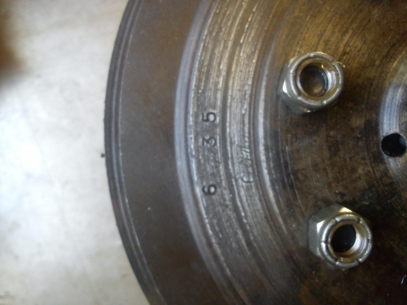

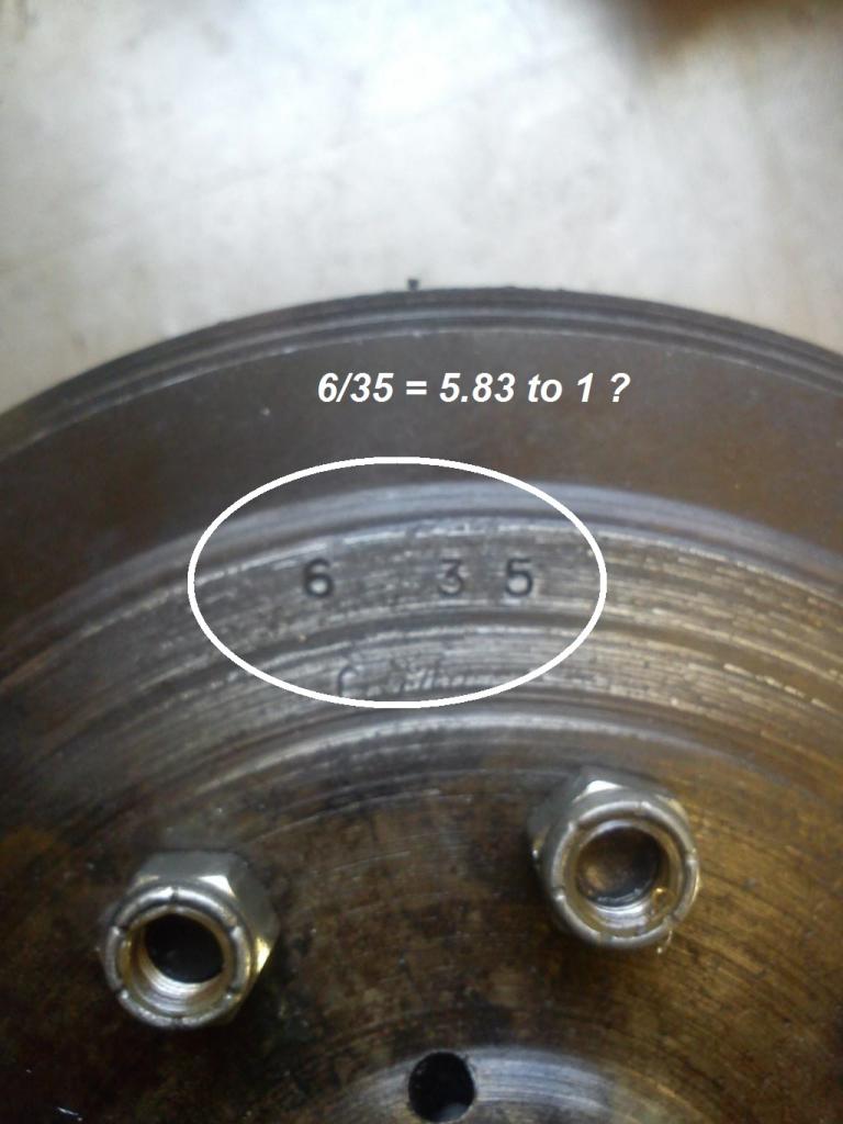

Martins, I have been doing some research.. Your CW&P appears to be 5.83/1 ratio ( 6 /35) tooth count. That appears to be a 'Truck' ratio- not a car item? Can you measure the diameter of the Ring Gear and count the teeth on both R & P to be sure, plus number of splines on pinion. Also the distance from center to center of the two bearings in the bearing plate 2nd from rear. If that distance is 3.5" (~89mm) maybe you can use the six spline series of quick change gears to alter gear ratios.

I wonder if Mr.Baker actually used two rings to make the carrier. That is maybe why the carrier seems has ratio numbers on it and wear from the thrust button Jac.
Maybe, but in this pic I think the pinion is more likely to be 10 spline and the ring gear appears to have one half of the diff/spider gear attached as one part..eg the split is at the cross pin for the spider gears. The ring gear in your post #12 above does not have the spider carrier as an integral part.

The ring and pinion is 9/37 so it is 4.11, tried to find one like this but they are all 6 splines but mine is 10....
