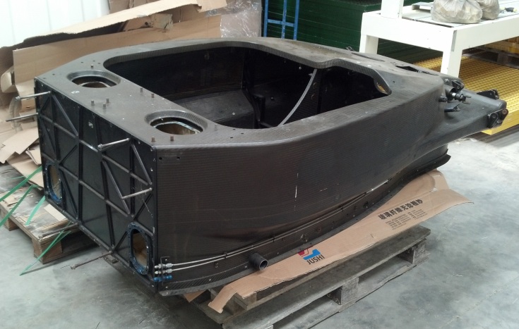

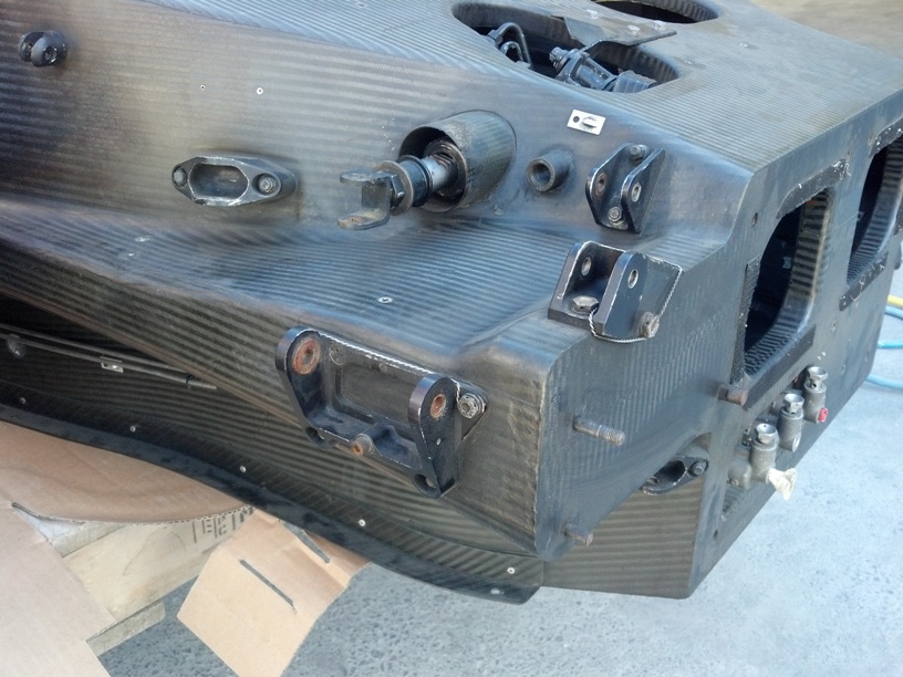

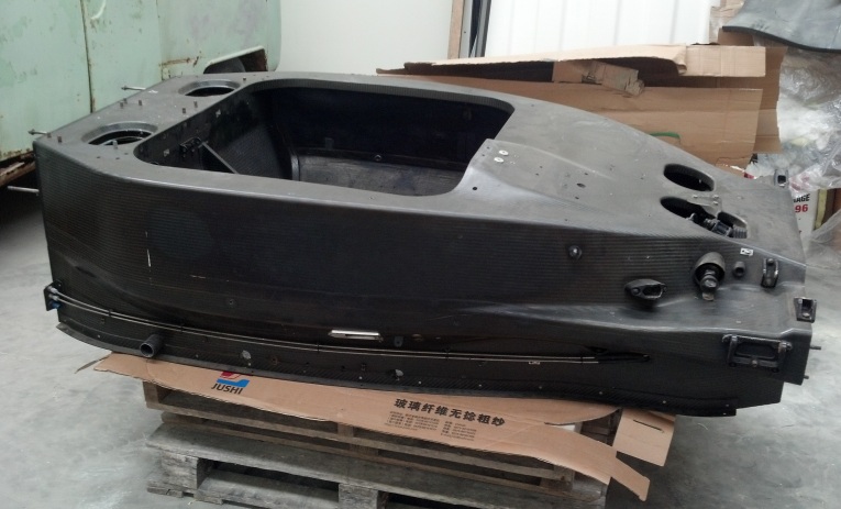

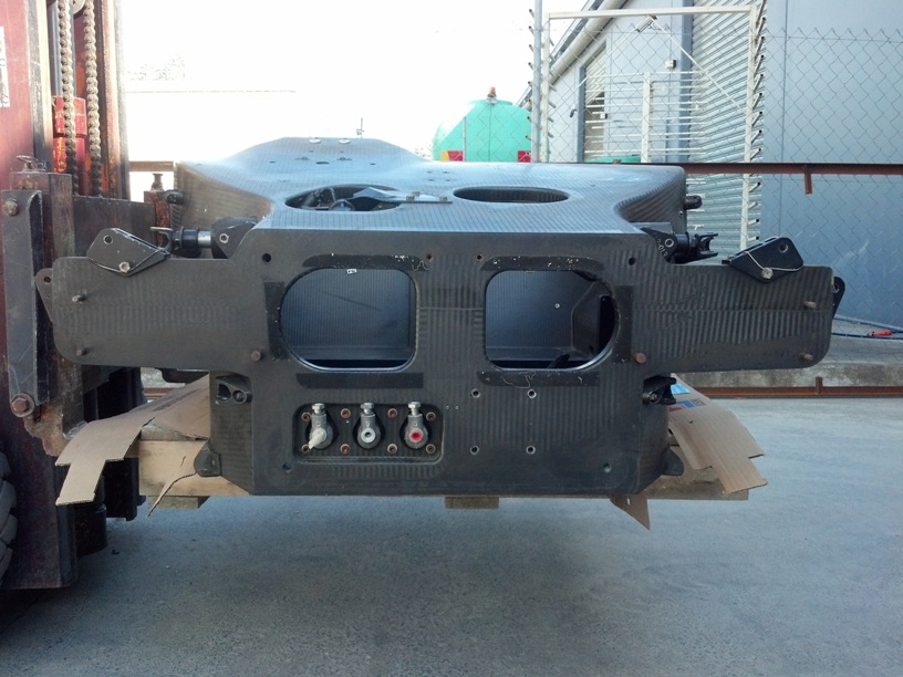

CAD modelling of the chassis is now almost complete. Out of interest, I weighed the tub yesterday. She came in at 96.1kgs with steering rack, fuel cell, suspension mounting points, gear lever, master cylinders and aluminium bulkhead plate fitted.
If you've not been following the RCR LMP thread, here is what my chassis looks like. And the last pic is of the actual car that this chassis is from. The tub sustained heat damage to sections of the skin and core on the left hand side which are currently being repaired. The damage was caused by an incident at LeMans in 2001.

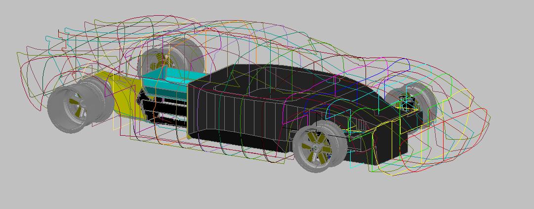

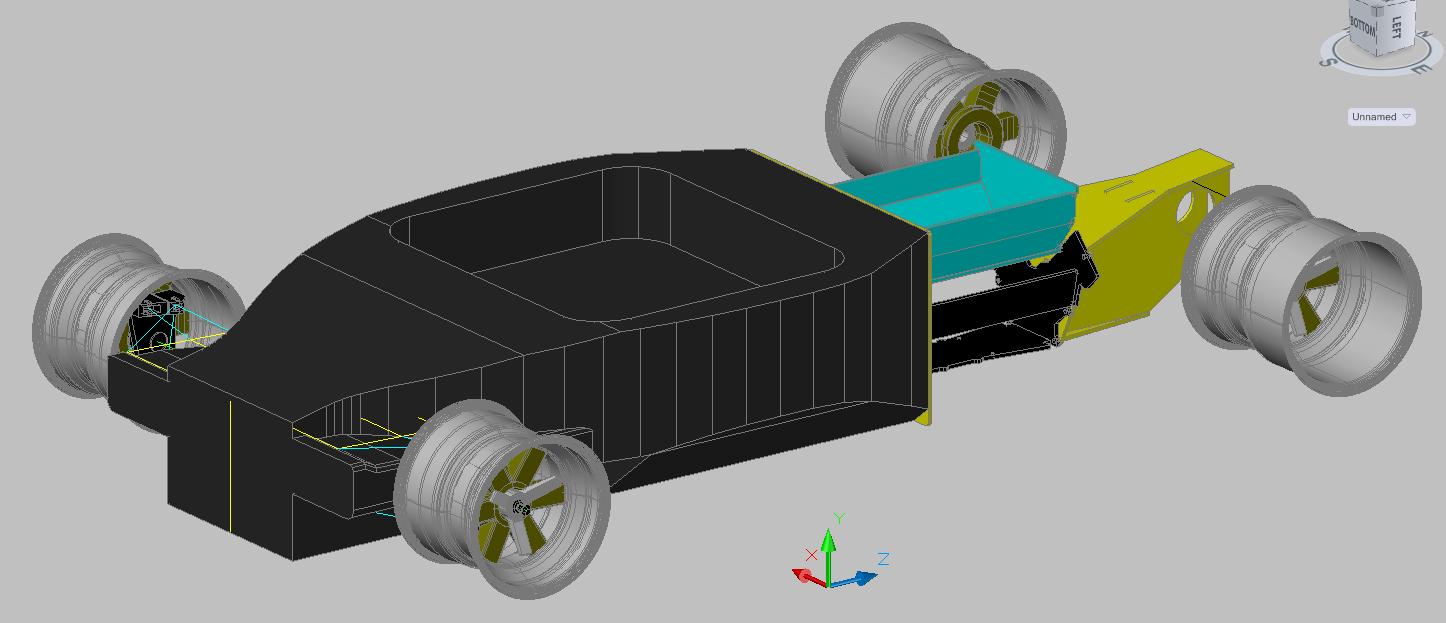

Here are a couple of the less detailed CAD models of the tub integrating with the engine / trans mock up. The front suspension geometry is vastly different to how this car was originally designed, and is posing some extra challenges with steering track rod placement - given the adaption of the Renault F1 uprights.
Packaging the components within a 1968 GT40 body's constraints is the other issue we have. The LMP cars had a wheelbase of 2920mm, where a GT40 is only 2438mm - That's 482mm I have to lose! Even though the V10 is only 591mm front to back, the transmission's to suit these engines have their gear clusters inboard of the differential, making for a longer transmission case. Oh, did I mention that the input shaft height is only 58mm? (same as the crank centerline height from the base of the engine)!

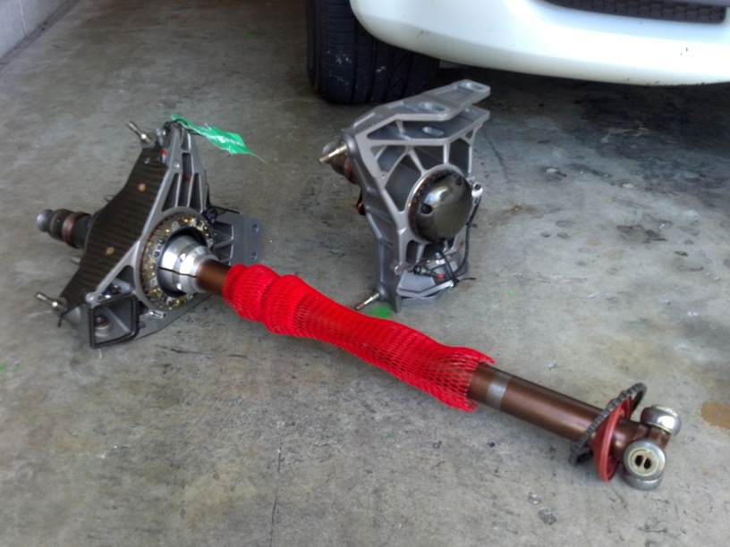

The uprights themselves (Titanium) are very cool pieces. I have added a couple of pictures of 1x front and 1x rear. Much care (and extra $) were spent ensuring matched pairs front and rear. F1 cars being prototypes, are constantly evolving throughout each season, and finding matched stuff like this can take time. The drive shafts and tripod joints on the rears are extremely light.
