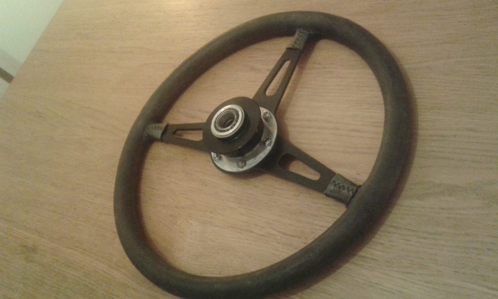

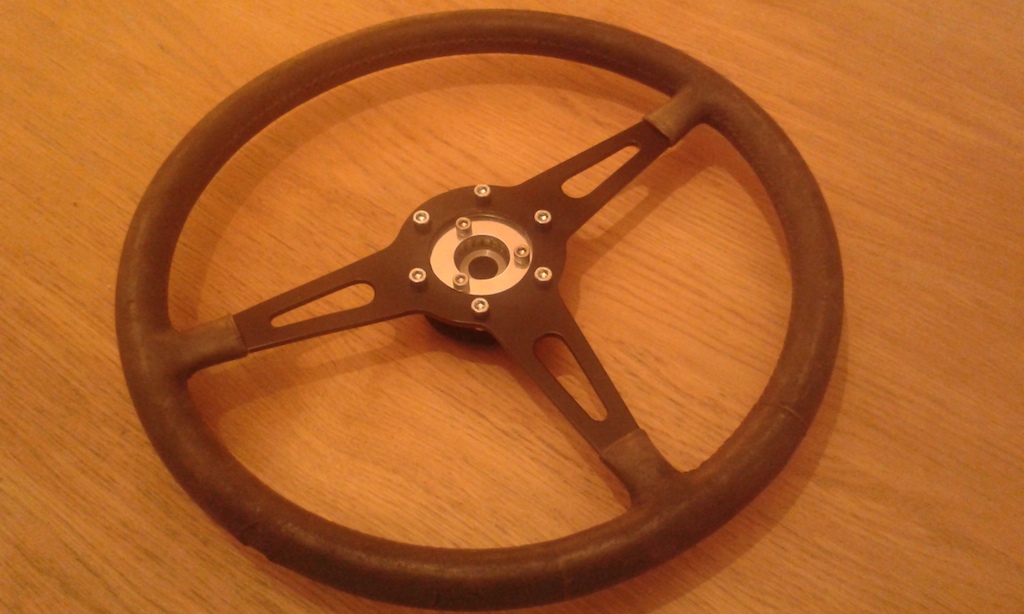

I have changed the steering wheel too (as I found the GTD provided unit quite ugly), and used a 15' vintage wheel, mounted on a quick release boss ( + home made adaptor). I cut the top end of the column, machined it a little bit and welded the QR spline. Changed my life for getting in and out of the car...
