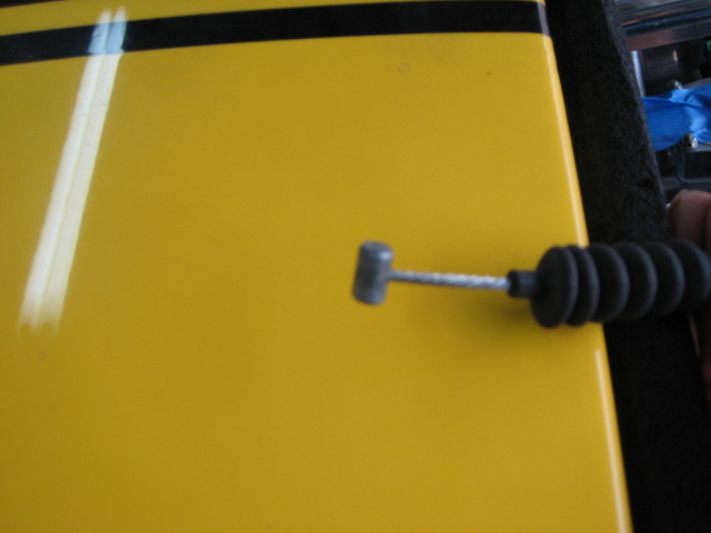

As you can see in the attached picture, the end of my throttle cable has a 90 dagree ferrell on it. I need to connect this to the throttle on the manifold as shown in the second picture. The problem is that I cannot find anything that connects to the ferrell and would allow me to conect to the throttle arm.
I checked with Lokar and was told about a universal part that I could use but it would require cutting the ferrell off of the cable and inserting the cable end into this part were it would be held with a set screw. My concern is the set screw slipping and the cable being pulled out at a bad time.
Any suggestions?

How about soldering an appropriate fitting that would be more secure to the cable (after removing the offending ferrell) and then attaching it to the Lokar piece? If I recall correctly, throttle cables are fairly easy to attach to with solder (did it once on a motorcycle throttle cable and had no problems with it for a long time).
Just a thought.
I hesitate to mention it, but perhaps sourcing a different throttle cable and fishing it through the tunnel might be a better idea. Sure sounds like a lot of work, though.
Doug
Lokar makes a cable end w/ 2 set screws I used one my Cobra never had a problem, but soldering would be a better way to go.
