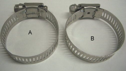

Clamp A is an off the shelf typical auto parts clamp. Actually it's their higher line clamp. It's 1/2 wide and the screw holder is one piece and is crimped around the clamp/screw. It's torque rating is about 30 in/lbs.
Clamp B is also 1/2" wide but the screw holder is two piece fastened with bent over tabs. Torque 40 in/lbs

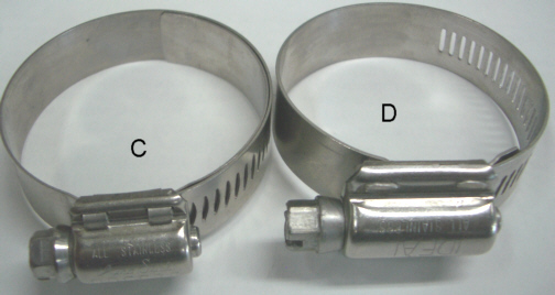

Clamp C is 9/16" wide with a similar 2 piece bent tab construction. Torque 50 in/lbs. This clamp also has a longer length band on the ID that keeps the slots from digging into the hose.
Clamp D is 5/8" wide with a 2 piece swaged tab construction. Also note the longer length bolt for more thread engagement. Torque 80 in/lbs.

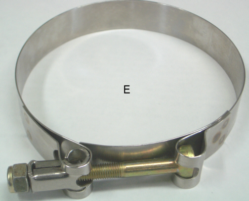

Clamp E is 3/4" wide with a bolt and nyloc nut. While it's also 80 in/lbs it probably is more re-usable and vibration proof.
There is another stronger bolt/nut clamp offered at 110 in/lbs. At this torque you may be approaching collapse of thin wall tubing.

The Type E clamps look to be by far the best - the challenge will be to find a distributor here in Oz so that I can replace my existing Type B clamps.
Do you have a brand name or manufacturer for the Type E's ?

Try a shop that deals specifically with marine diesels. They are sure to have T-bolts on hand or know where to find them locally. Your yachting mate should be able to steer you in the right direction. T-bolts are practically impervious to vibration(never say never), so they'd be perfect for a limited access situation, like a water pump or coolant tube hose. I've had one T-bolt break on me in 20 years of using them, but have never had one vibrate loose. They aren't exactly cheap, but for peace of mind, they're well worth the extra $$$.
Peter,
Any good ENZED, TYCO or hydraulic fitting business here in OZ will have the T bolt type clamps. They are substantially higher in price but very reassuring. Hope this helps,
