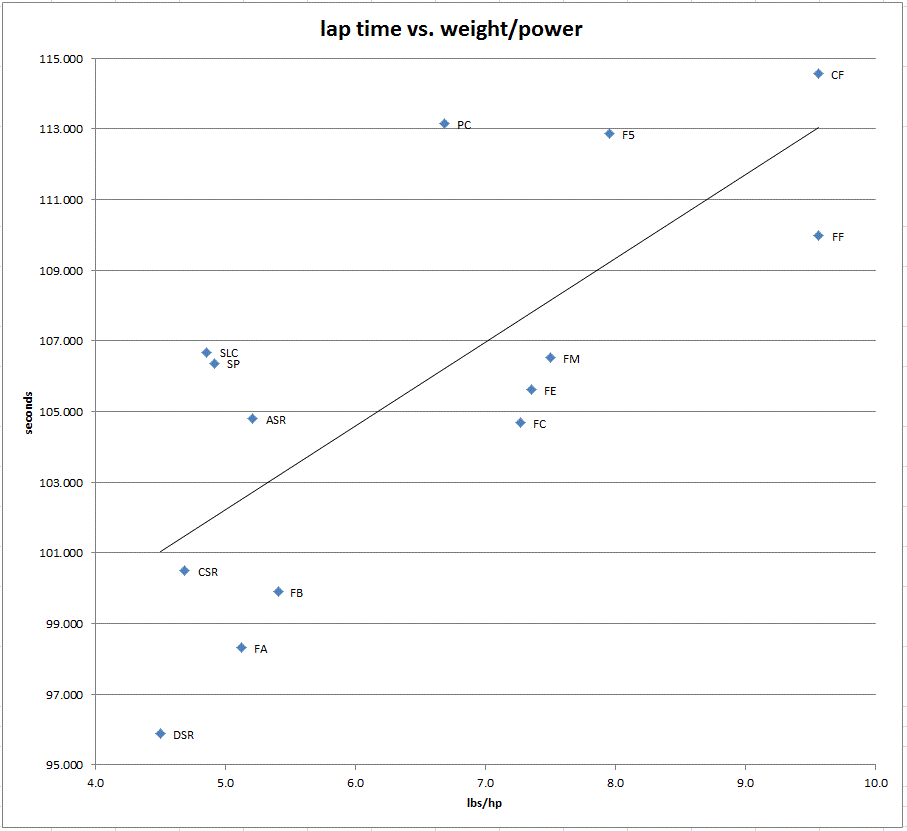

Incase you missed this over in the clubhouse
Ted just said THE WORD, TIRES!!!!!! IMHO the first $100K will get you a really fast car that weighs 2500 pounds. If you want to get another 500lbs off, it will cost another $50K at least. But you just might get the same performance increase with $2000 worth of tires.
Lastly If I did build a SLC that was 2000 pounds, had 800HP, and ran real race tires instead of Hoosiers would I be able to drive it at 100%. Not really if I am honest with myself.
What do I mean. A really well driven top prepared spec Miata can be outrun in my GT40 on street tires..........barely. I can put about a sec to a sec and a half on them if I push out of the fun zone and into the sweat zone. That gets me to about 2 min 16-18 at my favorite track. I would love to run at about 2 min flat and keep it in the fun zone so I am building my SLC. I think I have a proper grasp of the required skills and car performance to achieve this goal and that's what I am shooting for.
Teds car runs a nice fast pace 1:45 lap with 40s in hand. The car is faster, more developed, and has better drivers.
Given the examples we already are running about 30 secs a lap faster than my GT40 in Teds car and again if I am being honest that's beyond my personal pucker factor. What in the hell would I do with another 300HP and 25% weight reduction. Sub 40's, mid 30's, That just isn't gonna happen. Maybe 30 year ago but not tomorrow. It just does not make sense..........at least for me.
Put big ass tires on it, run a tidy line and don't slide the car around. Listen to Ted.
