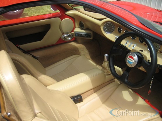

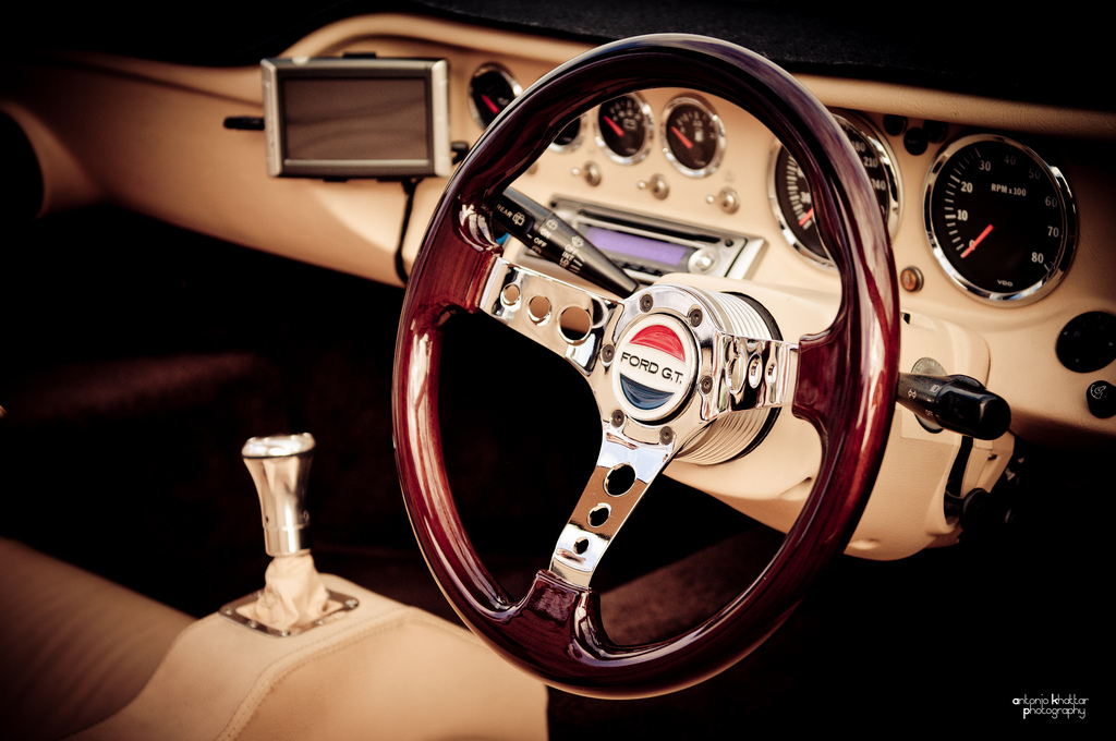

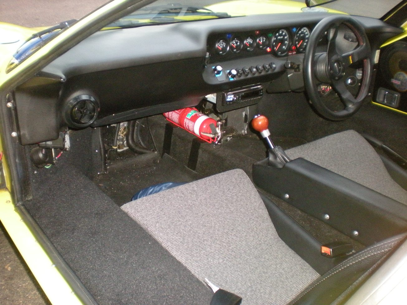

DRB's tend to have speakers in the top forward section of the door, above a handy remote interior door latch. Stereo head units tend to be central under the dashboard, although one in the attached pics is to one side. I've also seen the head unit installed in the driver's door.
