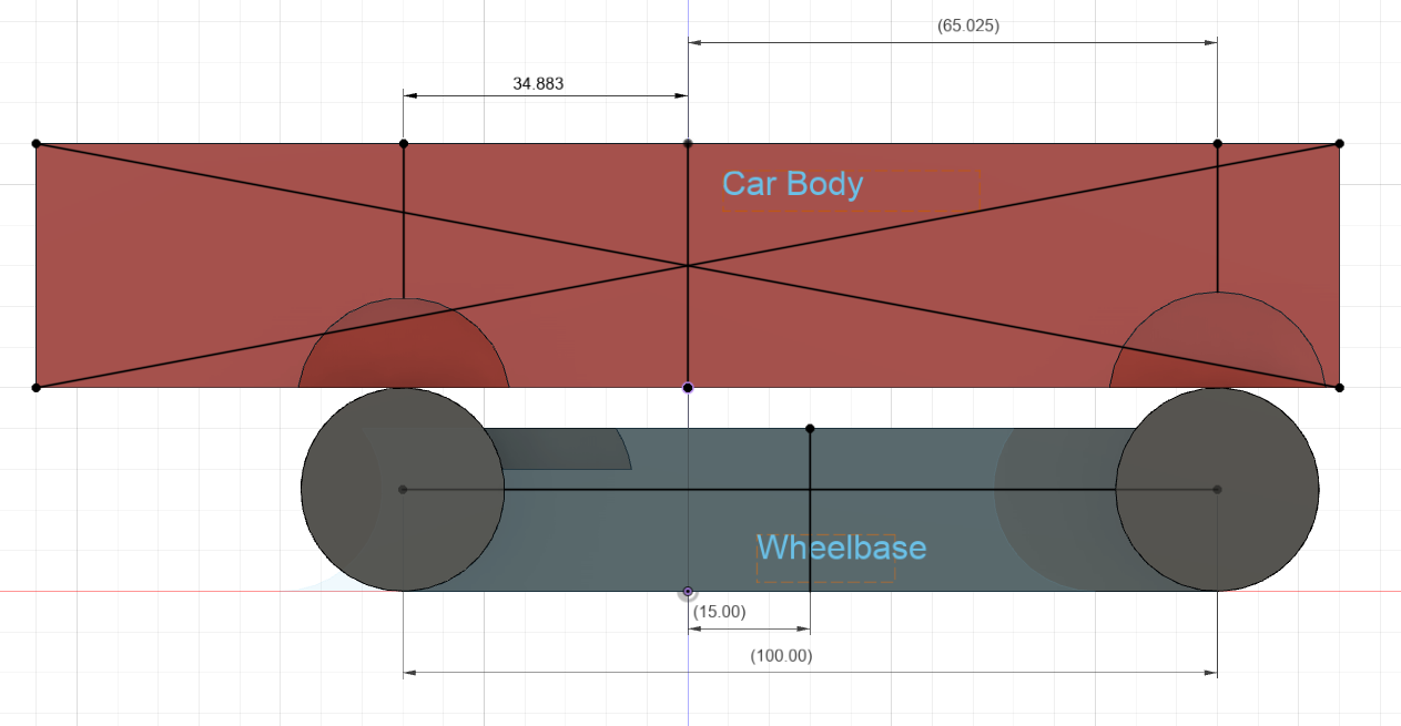

So check this out guys. You know what they say, a picture is always worth a thousand words!
So in these in picture you you can see what I call the chassis rectangle. Its just a geometric block representing the wheelbase
In this picture I made the assumption that the MK4 body center would share the same center as the chassis rectangle. I think this was just simply a poor assumption on my part. There is nothing that says those two have to align ( I think) !The numbers are NOT MK4 numbers but just something I made for a quick sketch.
So in picture one this is what I assumed to be the case.

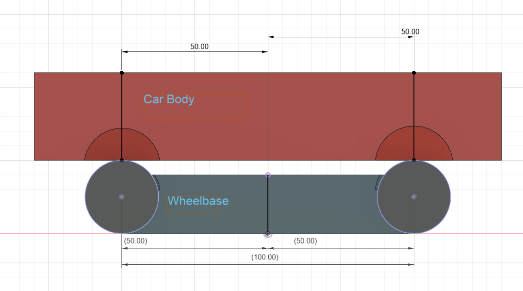

Now for picture 2!
This is what im finding to be ACTUALLY the case of a MK4. Still fake numbers just for reference here.
As it turns out , the geometric chassis rectangle center in order for the wheel wells to align on a 95 inch wheel base that has the car at roughly 172.1 inches long has to actually be set back just a tad in order to get the wheels to align with the wheel wells. Well? Why do you ask? I think the answer is simple. The wheel wells on the body are not symmetric. They are off set a tad from the body center. As it turns out to be 1.03025 inches set back. In the below picture I use 15 inches of offset to make the point im trying to demonstrate. Please see picture two. The point is the wheel wells don't have to be symmetric with the body center. And that is what causes the slight offset. I wonder why this was done this way though.
The question I ask to myself is? Does this matter? I think not but I have learned something a bit with this experiment. This is what happens when you are divorced and have no kids. This is how you spend your Christmas. :rolleyes:

At any rate! Here is the corrected model. Im pretty happy with it. Now the next question to ask myself is???? Do I go build a virtual P 917 or do I break out CNC router :)

As you've discovered, geometric center of the body does not necessarily coincide with center of the chassis. As above, designers contended with packaging mass items (engine, trans, driver) in the chassis, and try to establish good weight distribution. Driver position dictates where the visual mass lies in a closed coupe. The rest was designed to look good, and at least try to establish reasonable lift/down force distribution. These things are better understood now, 50+ years later, so designers look at aero in tandem with centers of mass, and work hard to keep those maximized and synchronized so the car doesn't pick up aero push or oversteer, while maintaining efficient cooling. Look at how much kerfuffle there was about team Racing Point using Mercedes front brake ducts in their F1 car, and that's a tiny (but important) piece of the aero puzzle.
Terry Oxandale
Skinny Man
As an example, look at a McLaren M8 where there is a very short rear overhang, but almost 2 feet of front body overhang. Compare that to a Cobra, which as a lot of rear overhang, and very little front overhang. There is really no relationship, either by wheelbase, or overall body length.
