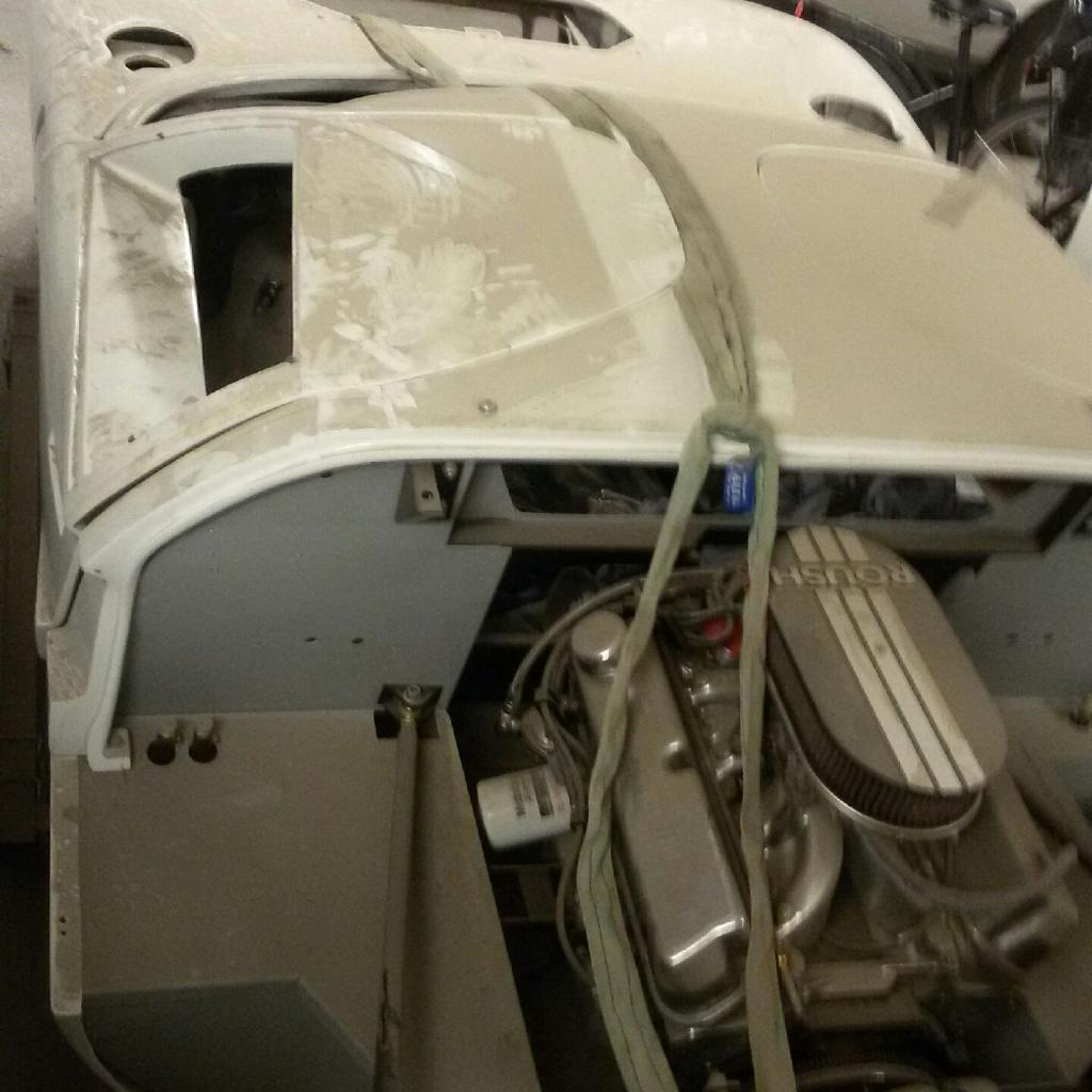

Car when sitting in the garage dust for some years...spring 2016

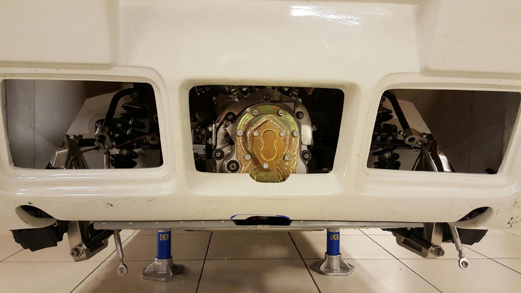

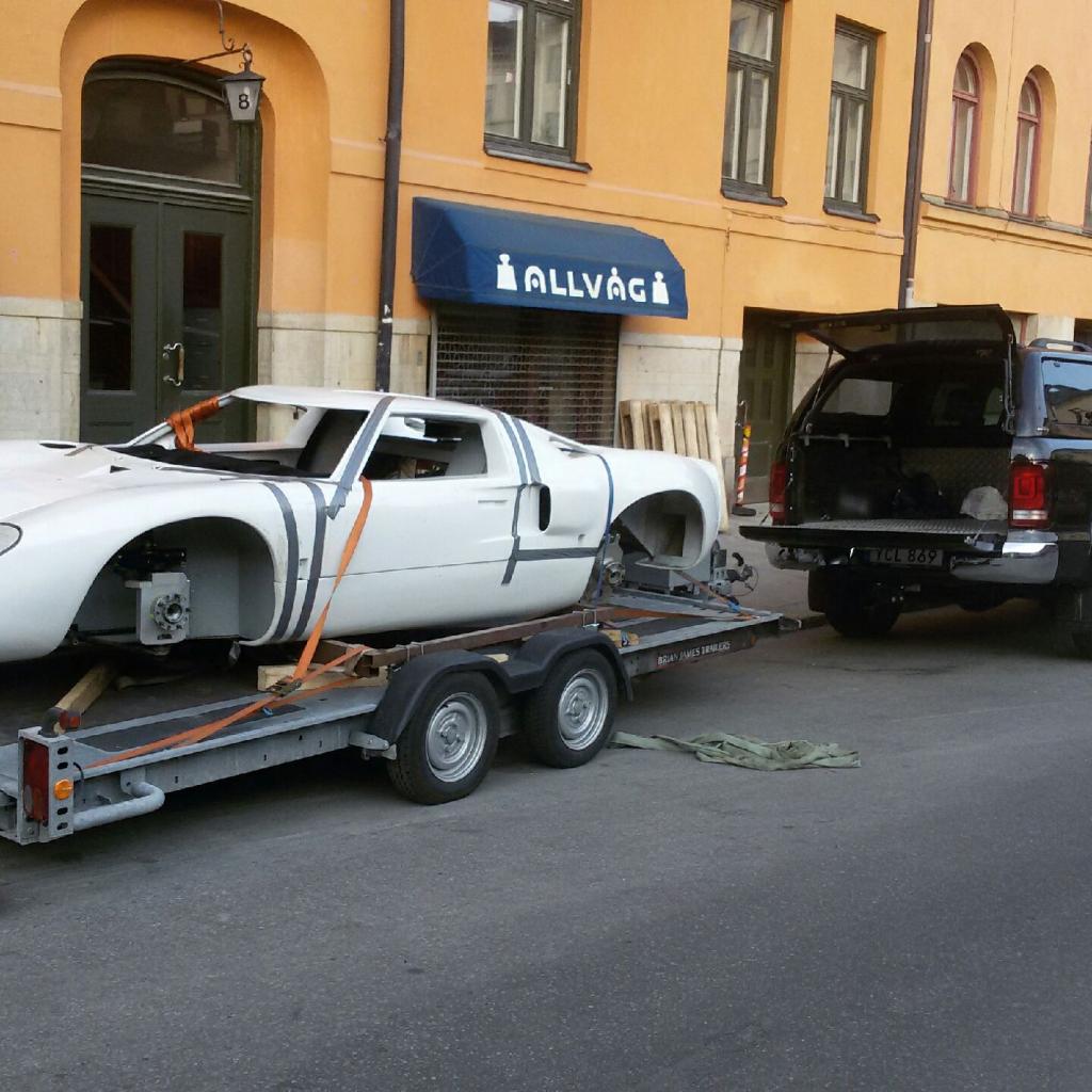

Off to a real garage / workshop. Took 4 hours to get it out of garage, up ramp and and up on truck.
The wheels did not not fit on the uprights....vintage wheels US 17" Halibrands got too small inside diameter to fit on the BEC uprights. So new wheels are coming from BEC and the vintage ones will be sold

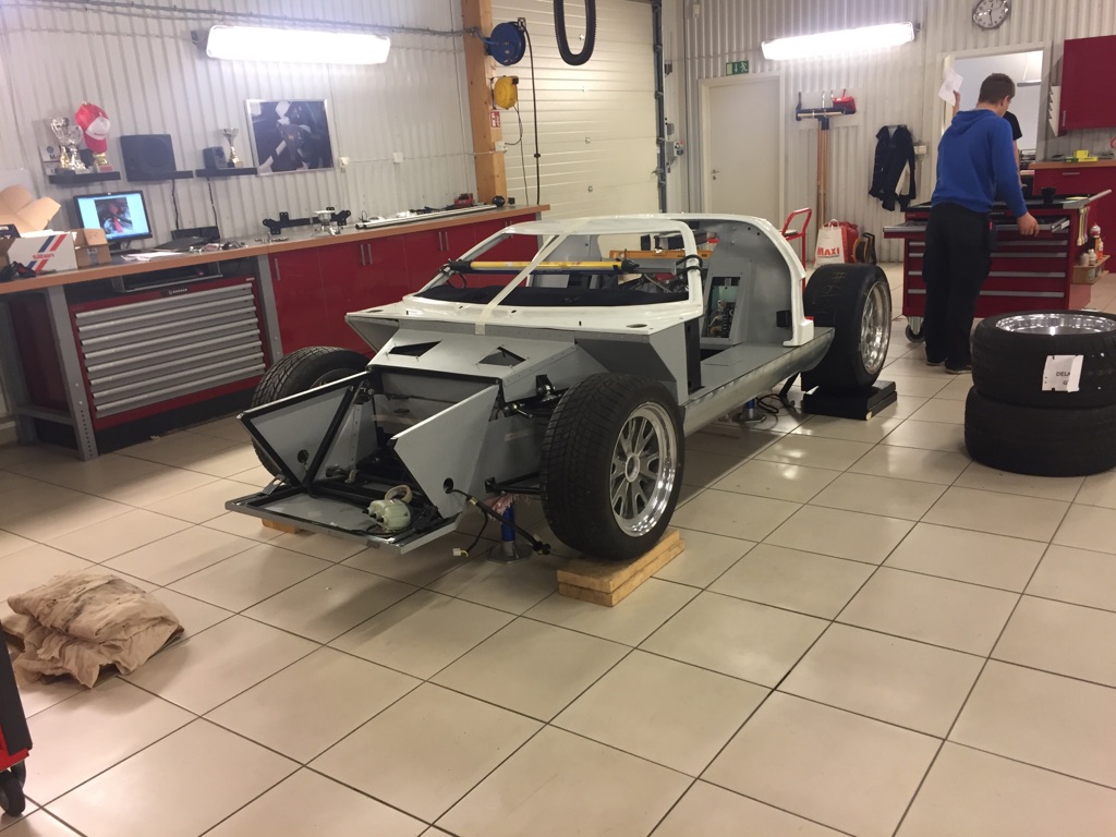

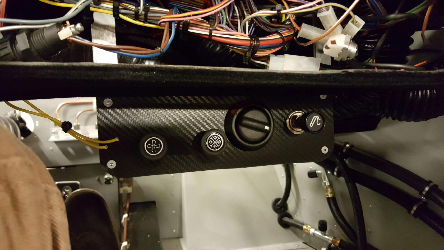

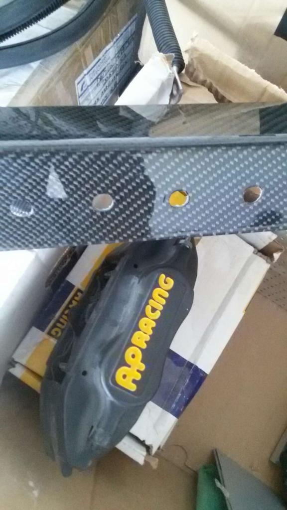

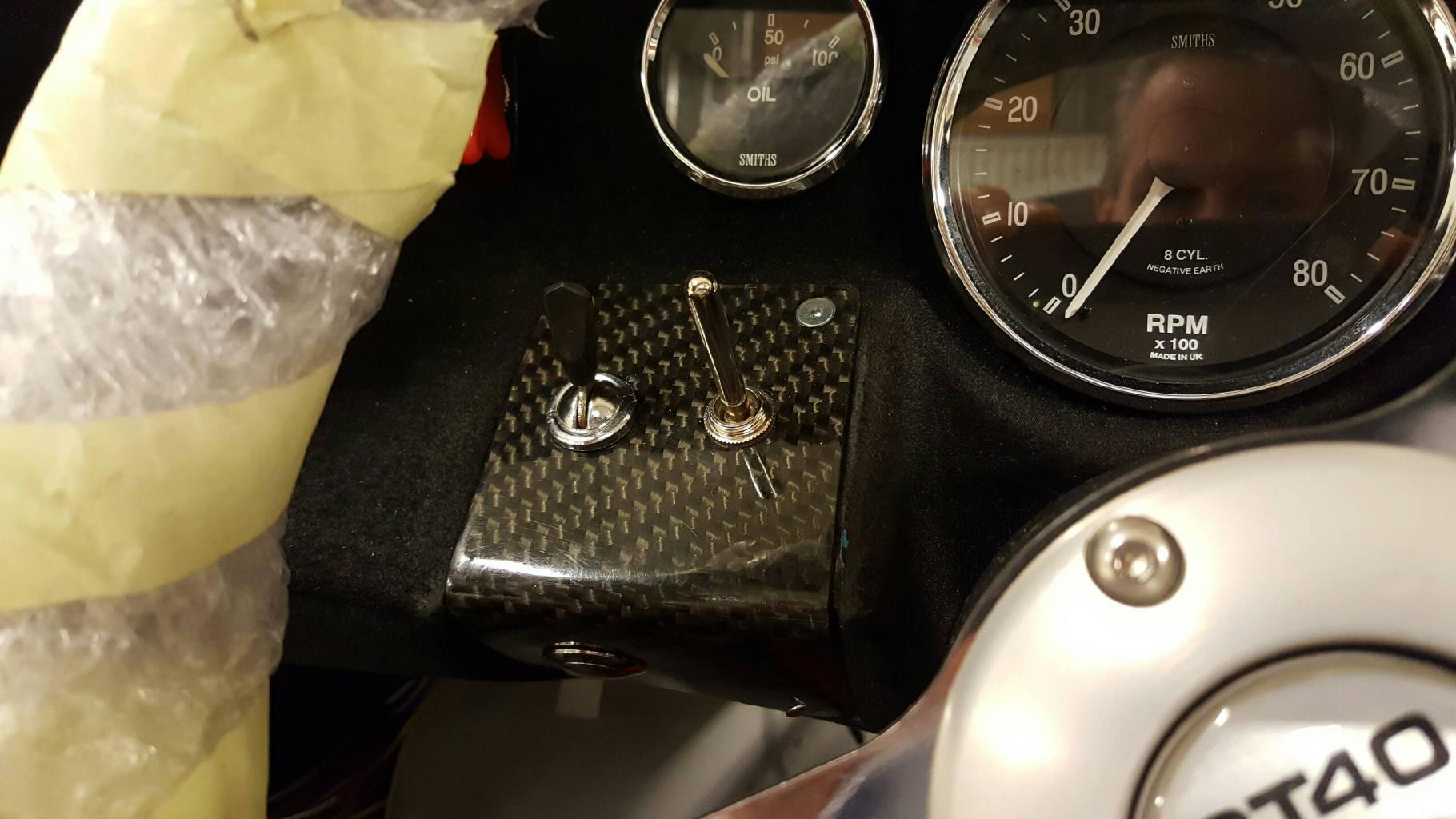

made the lower parts of the instrument panel from carbonfiber. AP racing calipers as recommended by BEC.

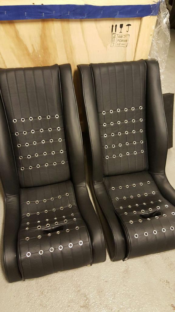

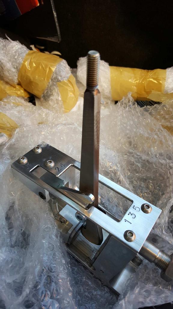

Gearshift for ZFQ and seats from Southern GT. Got these yesterday as late Christmas presents :)
Great quality! and nice packing in sturdy wooden crates from Southern.

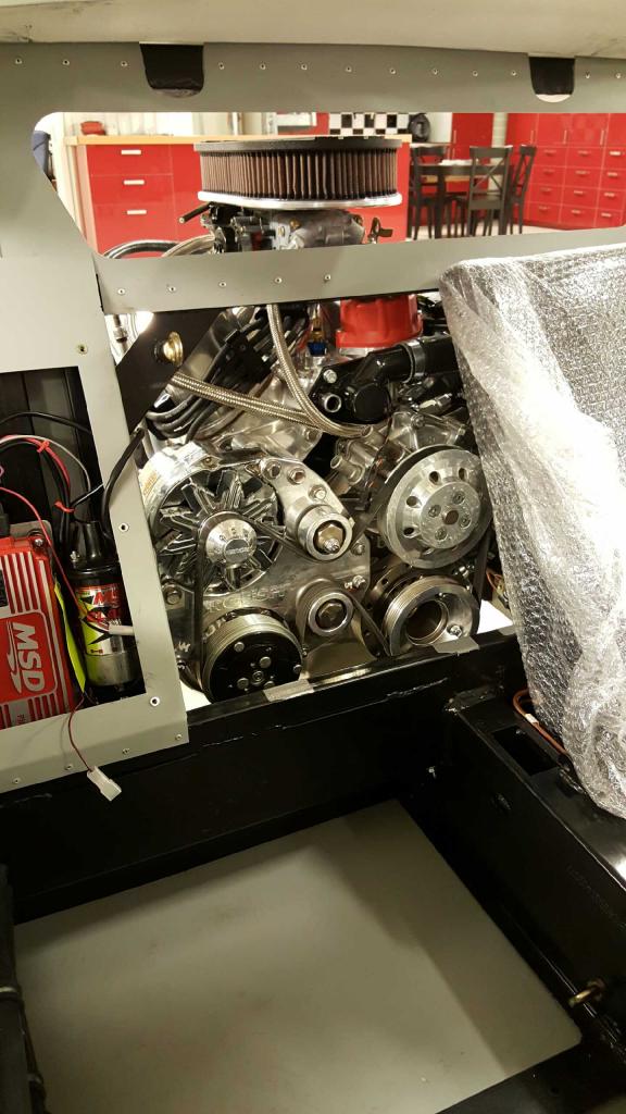

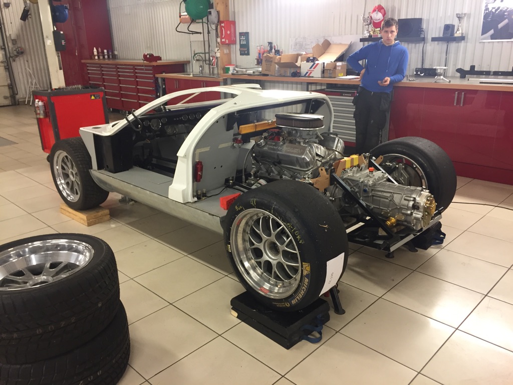

ZFQ in place. Slicks are not mine, just put there for show. Waiting for a new set of Halibrands that will have street tyres

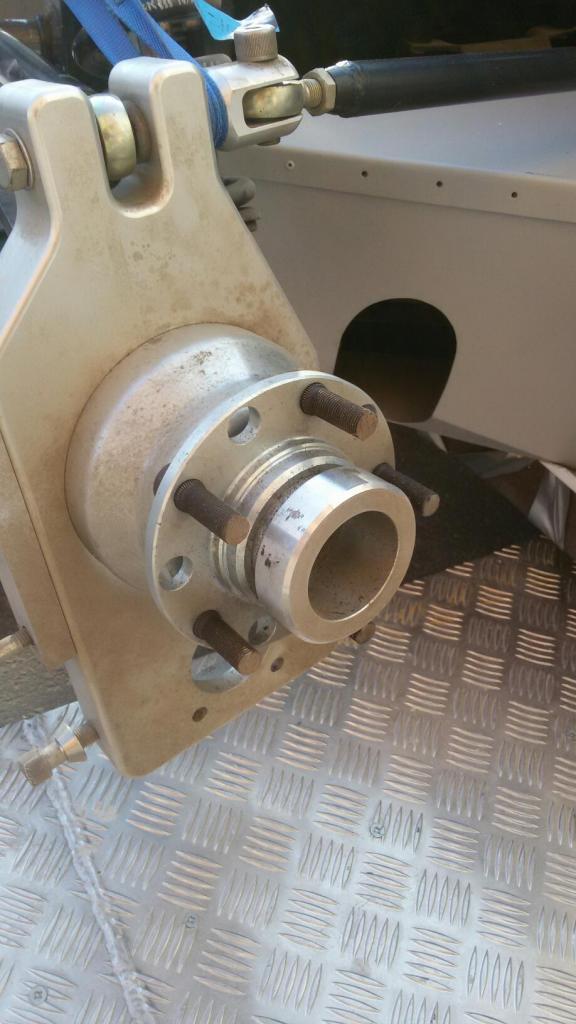

BECs rear uprights....really nice work on these but they are really high so check wheel inner-diameter before ordering! All 17" do not fit

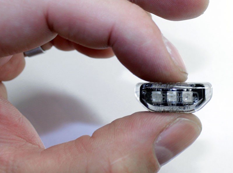

Side-mounted turn indicators needed here in Sweden, local law.
Found these small lights from Electrolite.
Ordered with smoked glass so blend in very well with the car paint (gunmetal grey is planned). 30 Euros.
Another option is the carbonfiber mirrors with integrated light with from Audi R8 GT. Considered them until I saw the price of 3900 Euro for a pair...that was used.

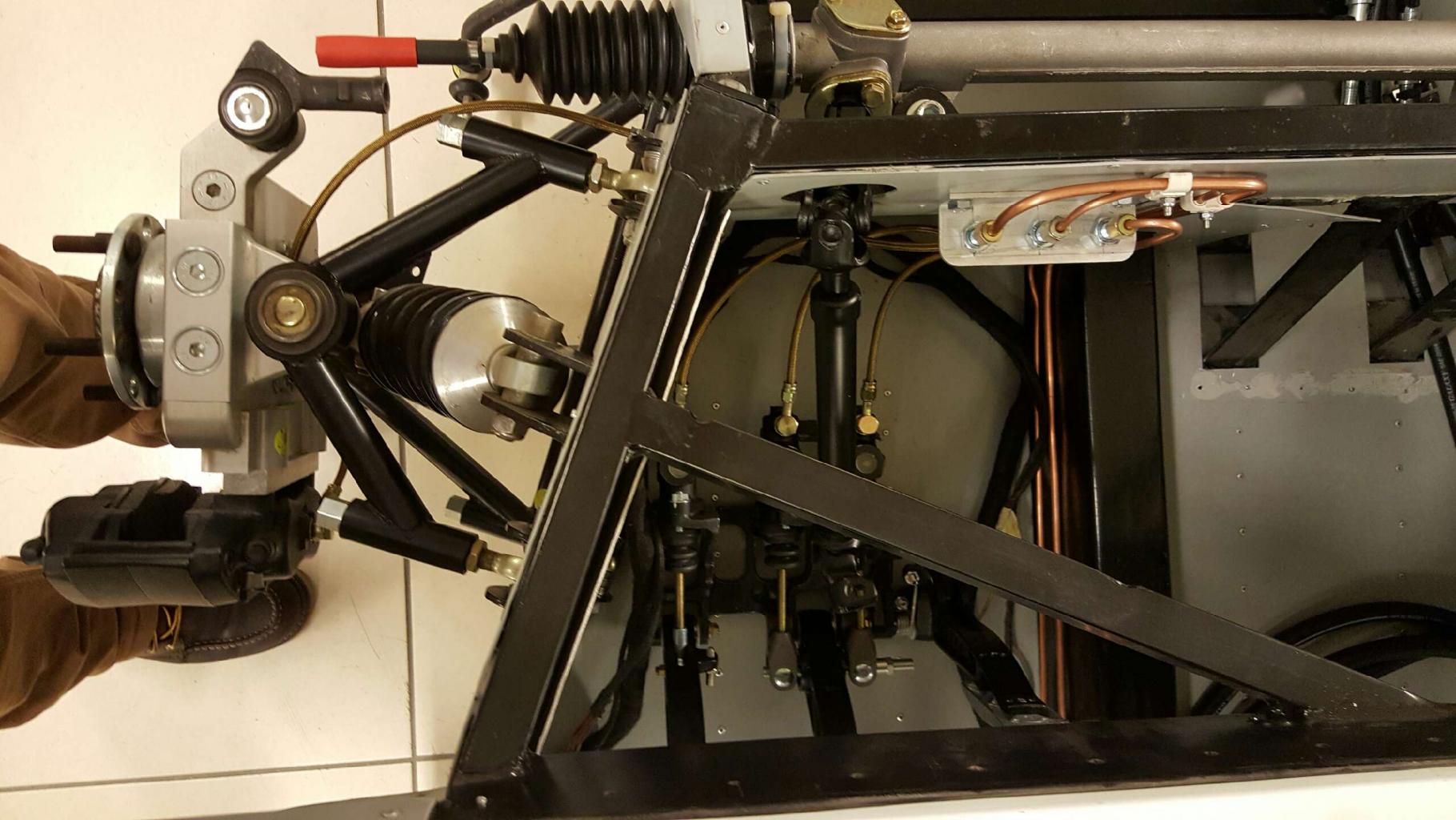

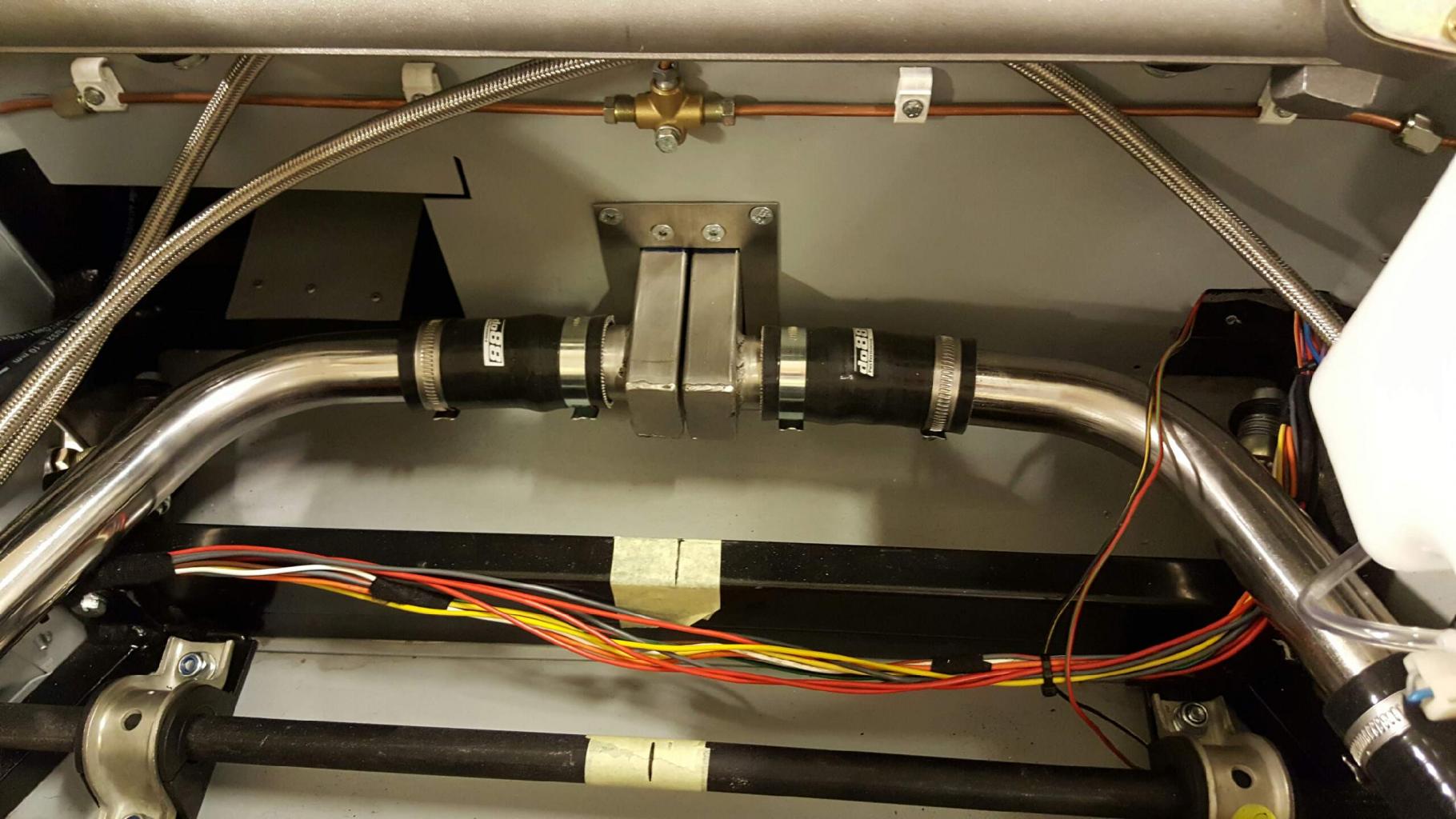

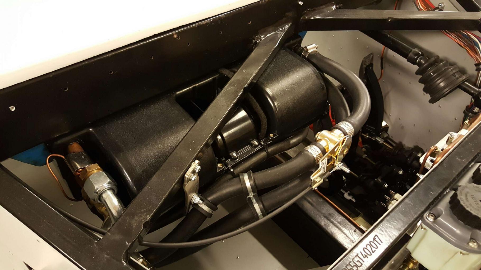

BEC coolant system, square panels instead of round pipes through chassie
