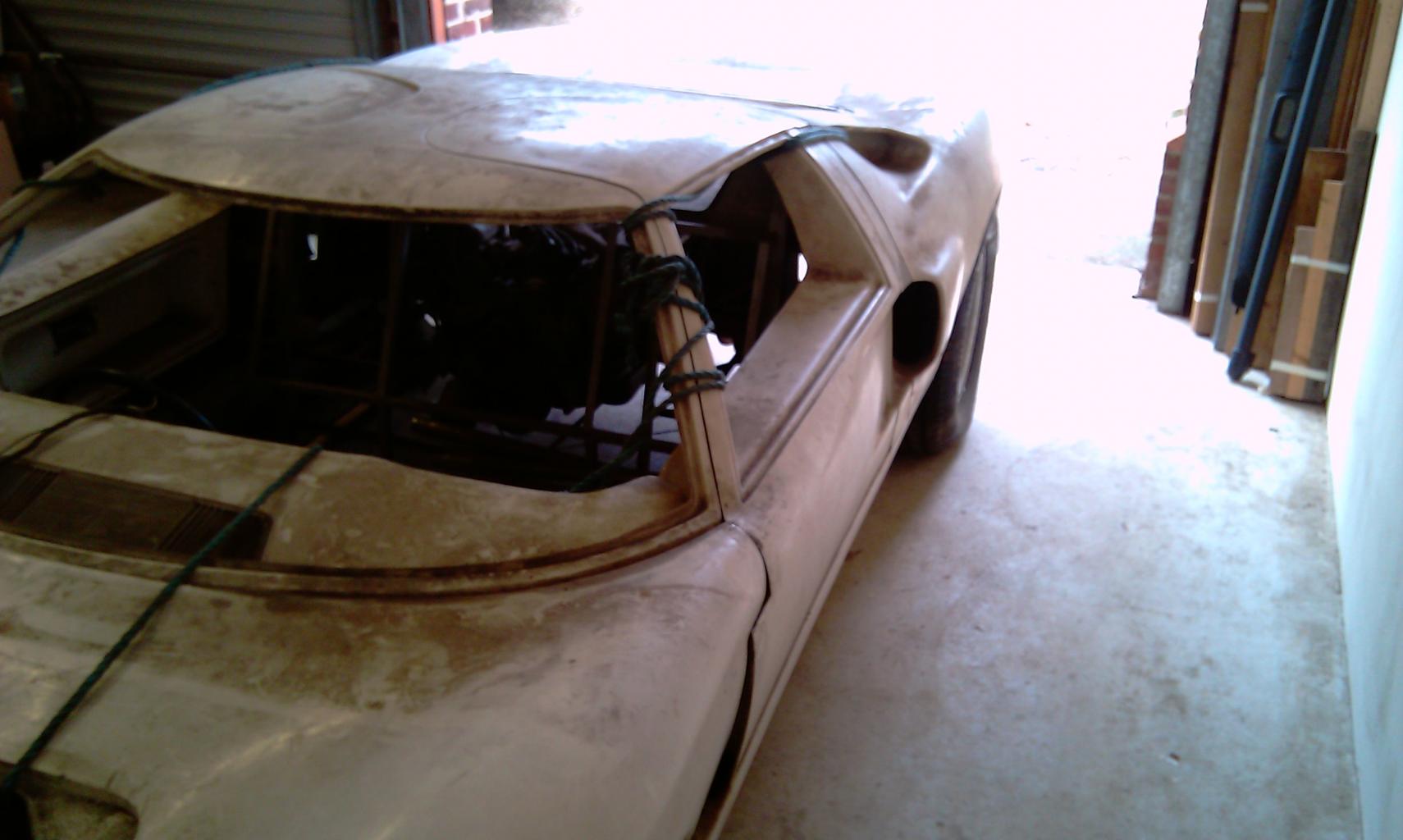

I collected my KVA GT40 replica this morning, I am the 3rd owner, with the previous owners having given up/lost interest, the last owner stopped working on it 10 years ago and left to sit in the corner of his garage to gather dust and become a storage repository - hence the rather grubby looking car when collected.
3 hours where spent giving a clean once home, overall not too bad with a few small areas of damage to the body, but nothing insurmountable.
Looking at the rear suspension I believe it is one of the original design chassis (A type rather than the later C type) - please correct me if I am wrong here.

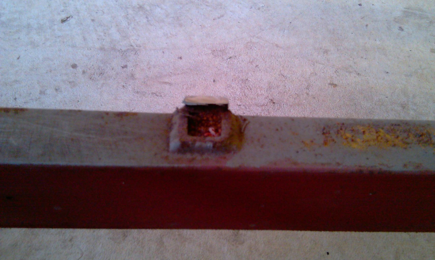

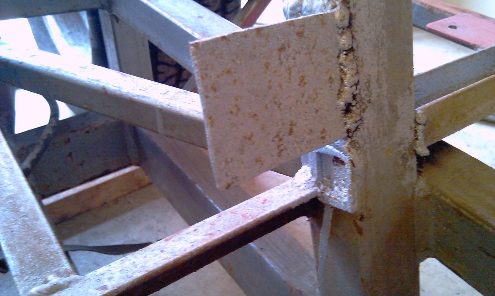

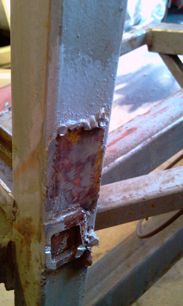

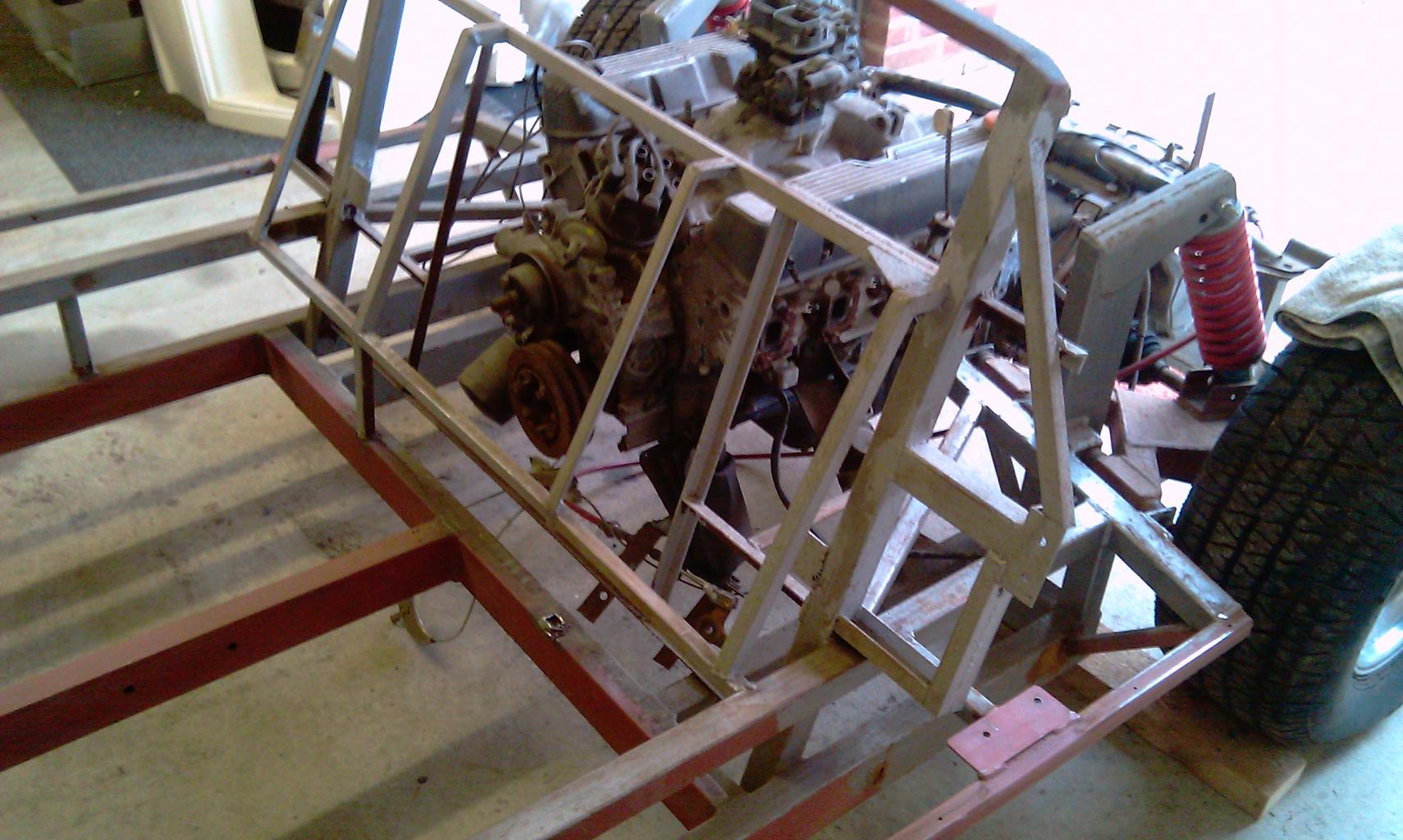

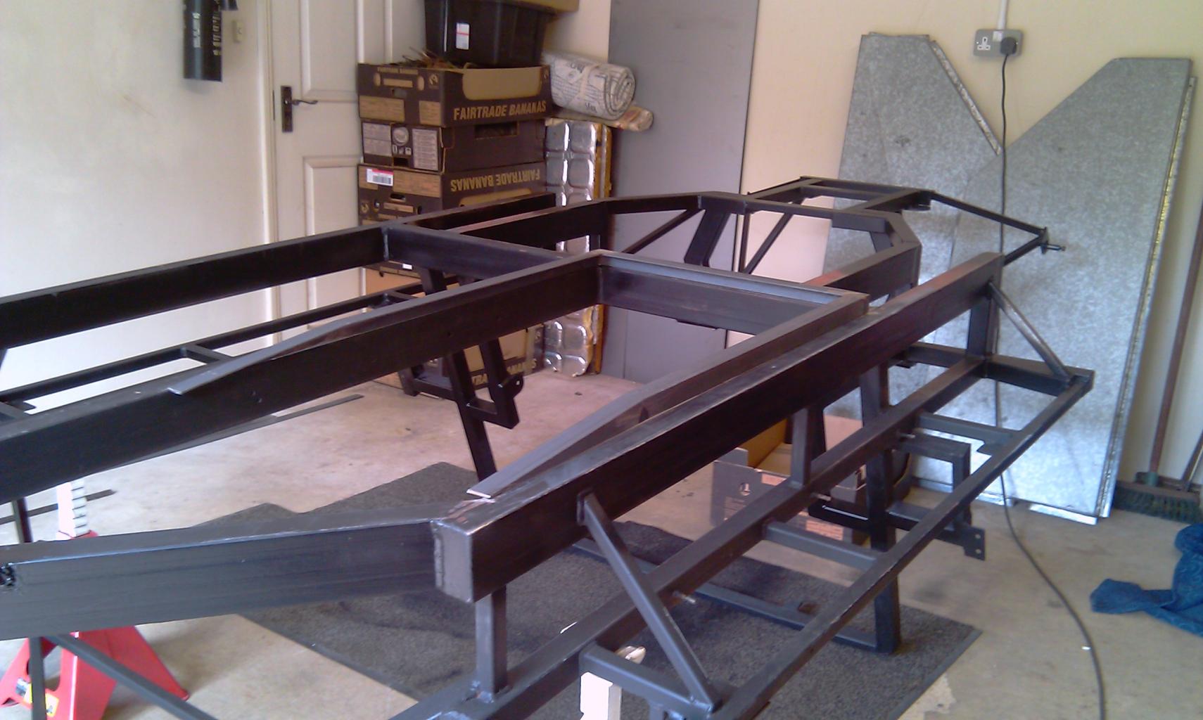

On close inspection of the chasis it had previously been modified/addapted with some of the upright box section supports having been cut out on the near side to accomadate the SS pipe work from the radiator and 1/2 inch angle welded in to fit around the Rover engine.
Most of the welding had not penertared, probably due to the coating still in place - hence the weld splatter.
The added metal work was removed faily easily and all remnates of the welding ground back, the chasis is in the process of being rubbed down and zinc primed and stone chipped - will give it a final gloss spray at a later stage once further welding/modifications are completed.

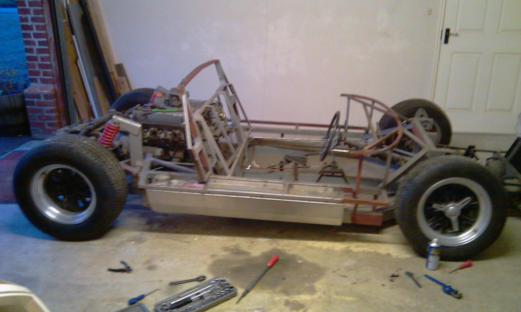

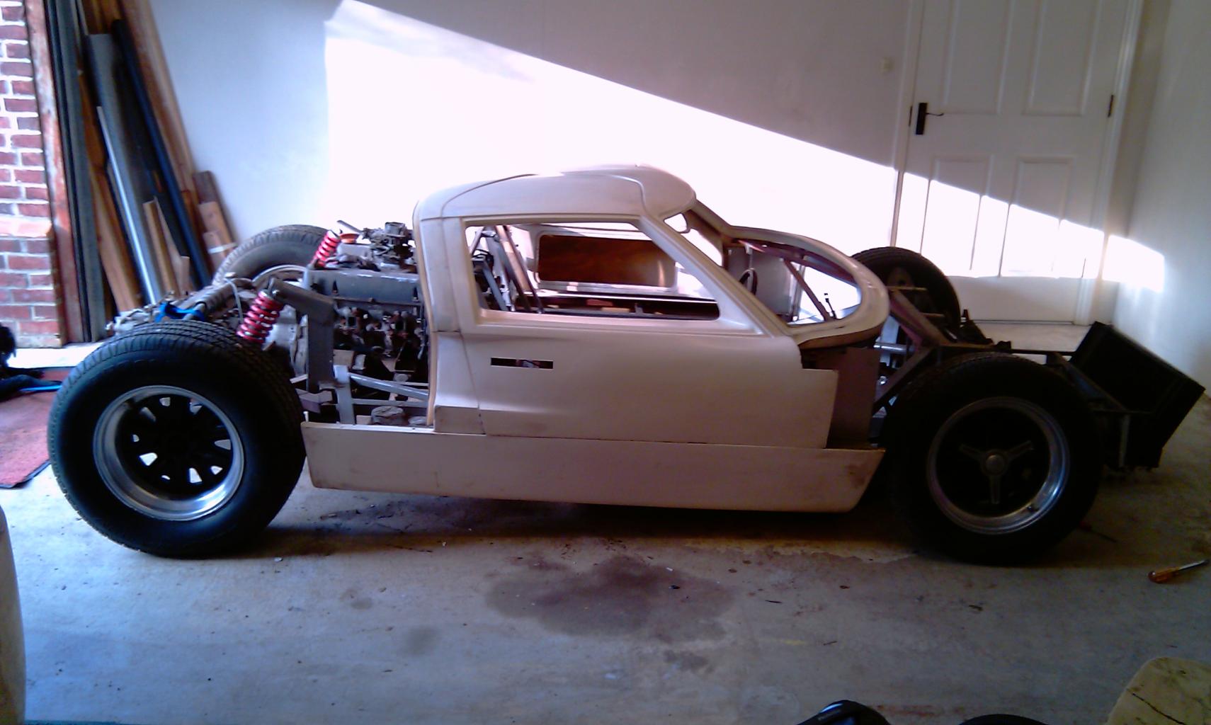

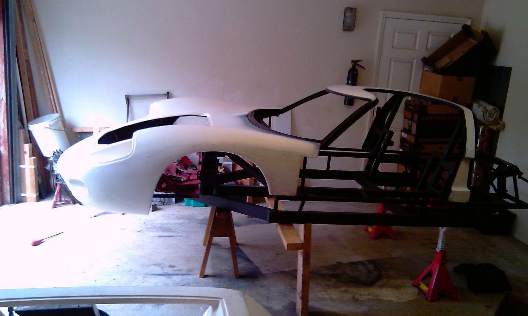

March was not a good month for progress with the GT40, as is always the way, just as you want to get immersed into the project other things in life have to take priority (Family and work commitments)
Although being stuck in a hotel every night did give me time to plan the exact direction of how I want the car to be and the final specification, having decided that the car will be 302 powered with a planned 350 BHP and a Renault UN1 transaxle, thoughts then turned to the rear of the chassis.

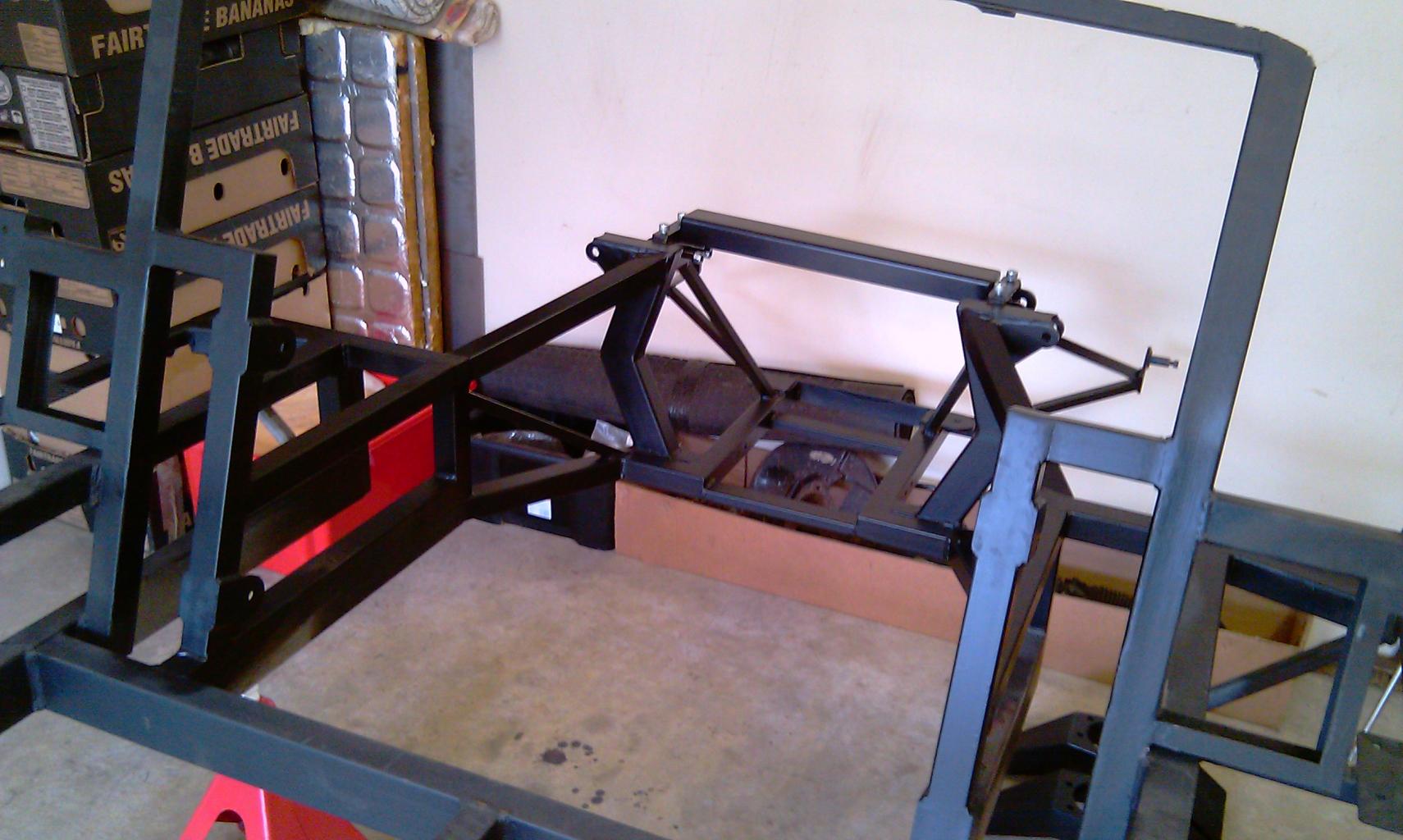

As the chassis was an early KVA design the plan was to change it to allow for a better suspension setup and be able to mount the engine/gearbox lower - I had planned to design it myself and fabricate but with limited time this was not going to happen for a good while, so after a discussion with Mick at Southern GT about them fitting one of their rear ends to the KVA chassis it was booked in for early April and a 400 mile round trip was made on an early Saturday morning to deliver the chassis to Mick,
Another 400 mile trip this morning to collect the chassis - WOW - it looks absolute fantastic (I could never have achieved such a good quality) - If you read this Mick - thank you very much.

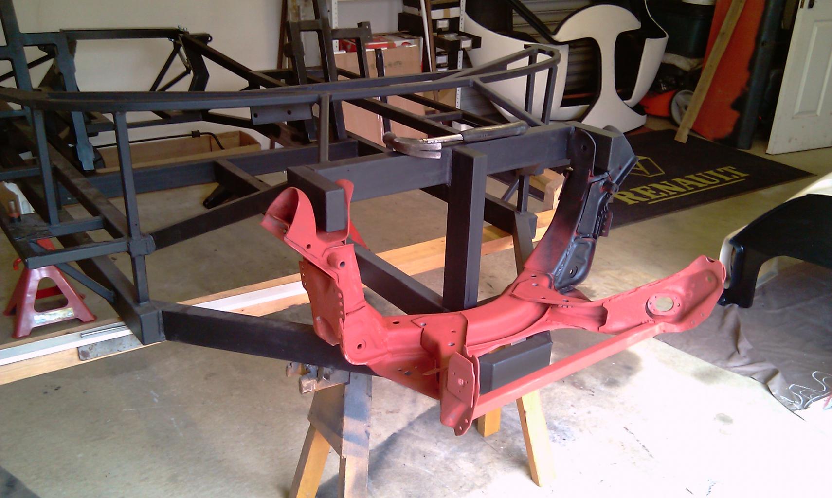

The front sub frame has been shot blasted and modified ready for the fitment of coilovers.
The next tasks are to fabricate a new front end frame that fits flush to the bottom of the chassis and then flip it over to fit a new floor, rather than using the original KVA trays that drop in from above.
Here are some pictures of the chassis with the new rear end and trial fitting of body & front sub frame.

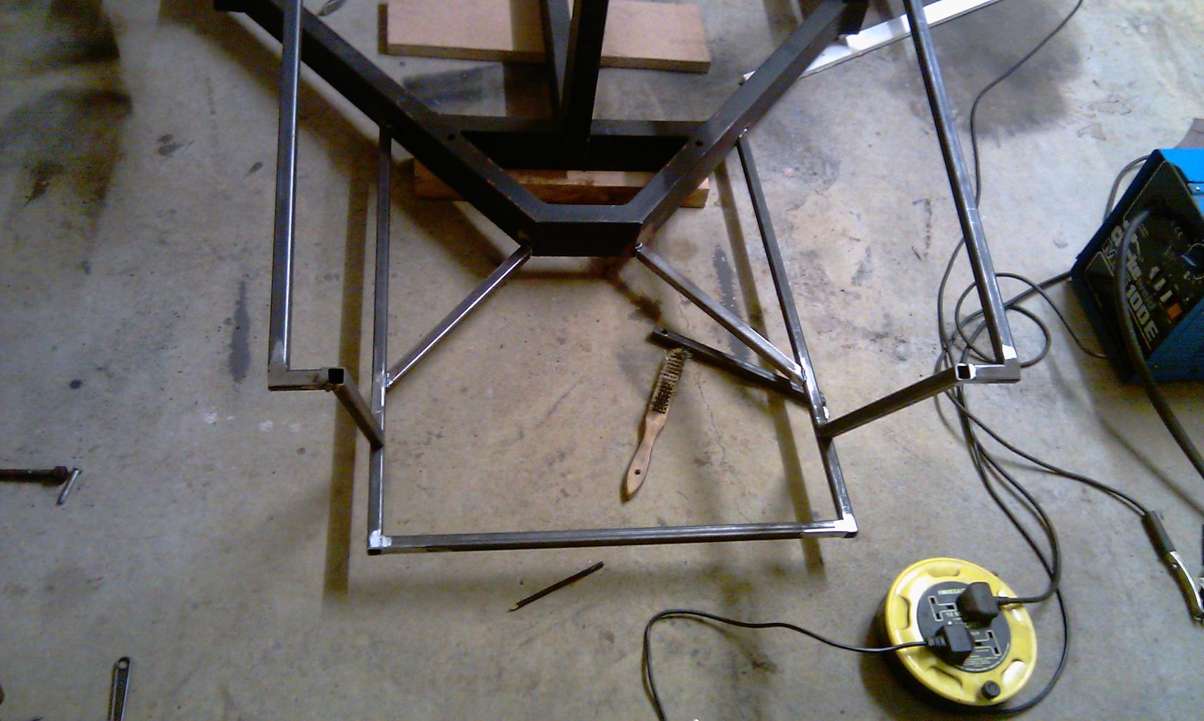

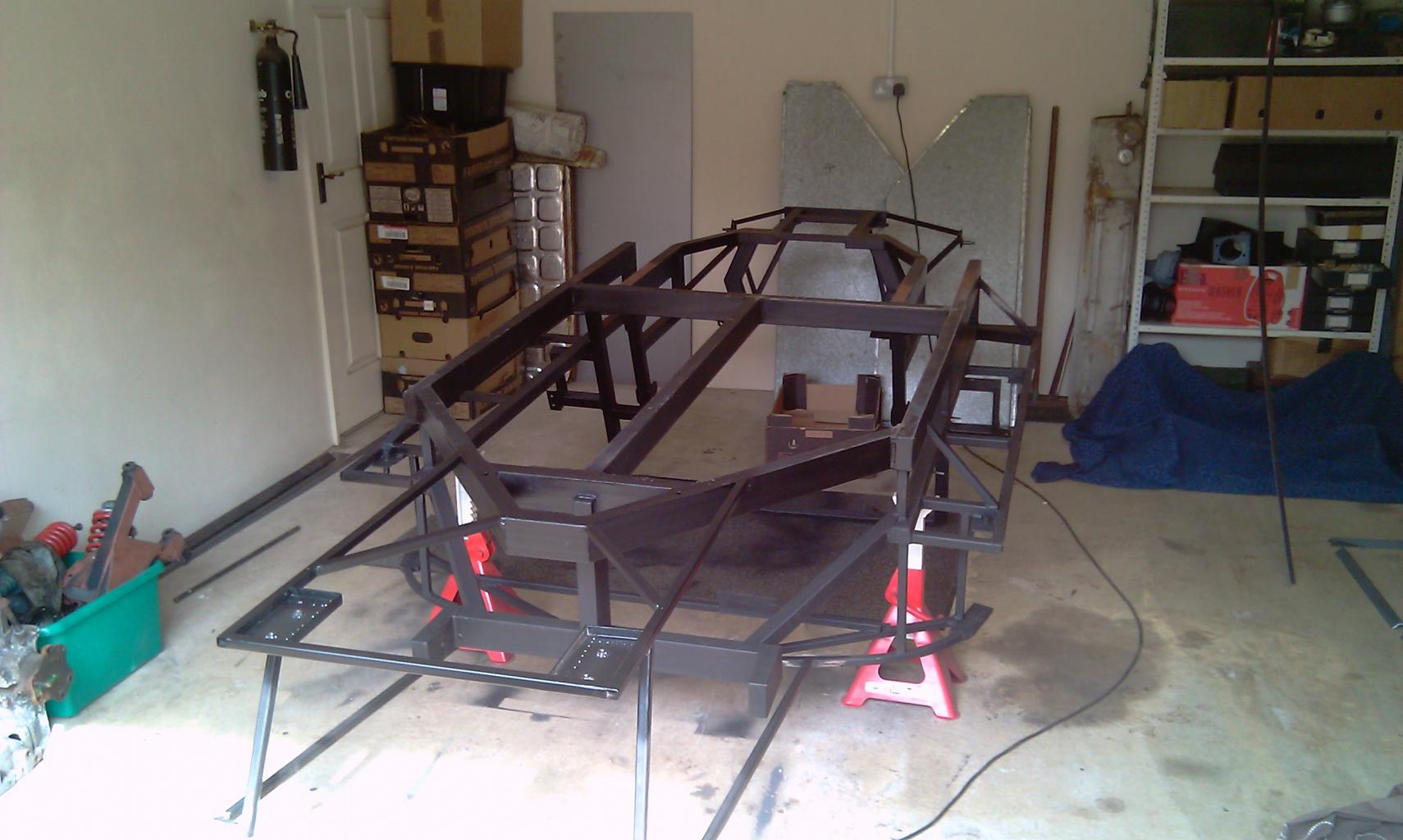

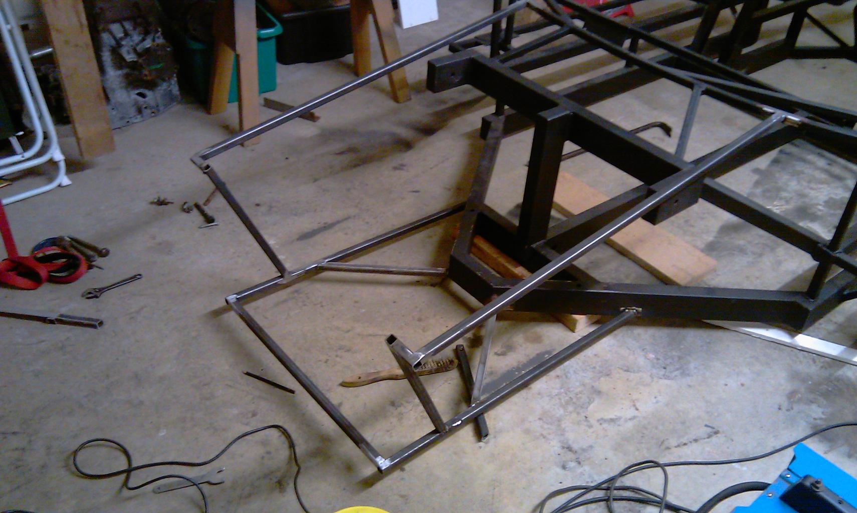

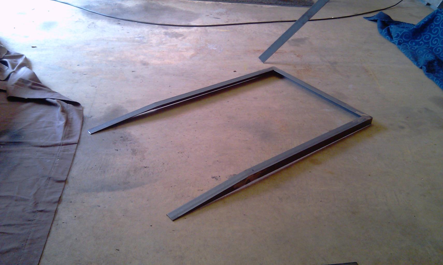

Started on fabricating a new front end frame today, the objective was 2 fold:
  1. To have the bottom of the frame site flush to the bottom of the chassis so that the floor can run flat all the way front to back.
  2. Fix the frame direct to the chassis (The original was only fixed to the sub frame) and design the frame so that the sub frame can be fitted independently and removable without having to take the whole front end off.
Spent the morning measuring and re-measuring, fitting and taking the front end of to many times to remember before any metal was cut and welded.
The frame has been made from 20mm box section, by the end of the day the main shape and structure has been made and welded to the chassis from the top, still need to fit some additional strengthening in the corners and then turn the chassis over the weld the underside.
Tony

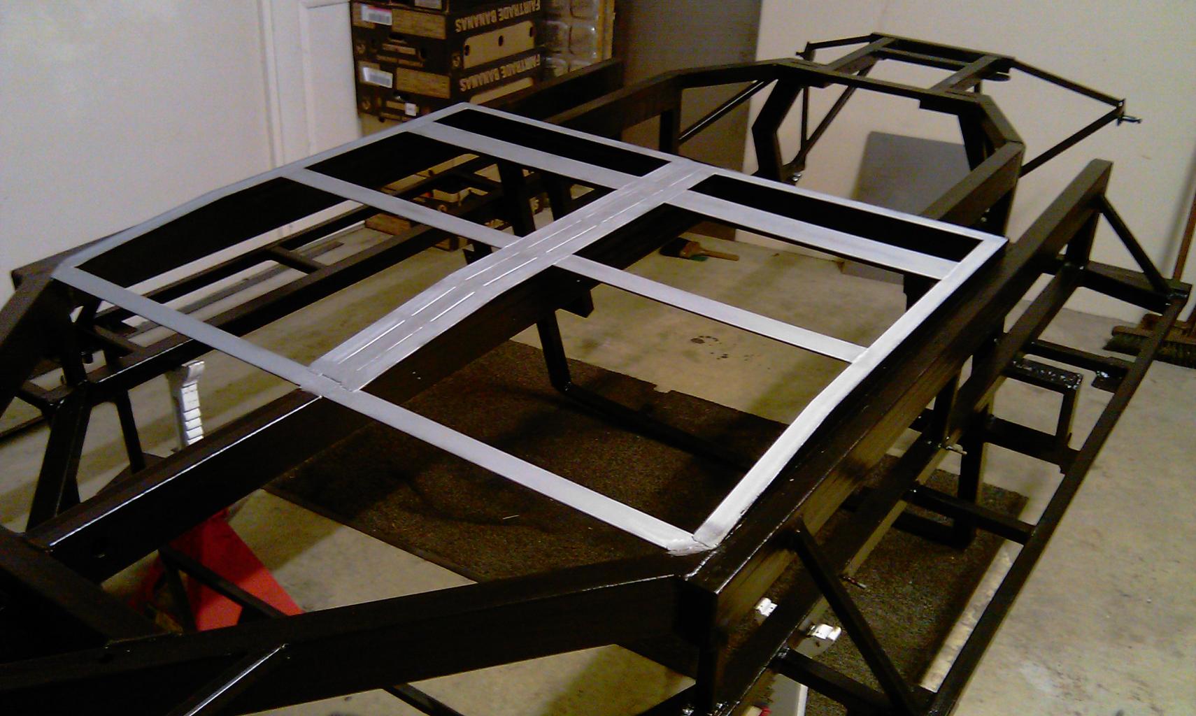

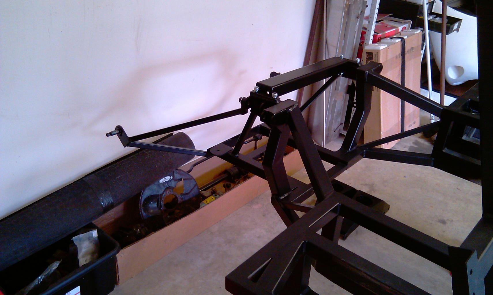

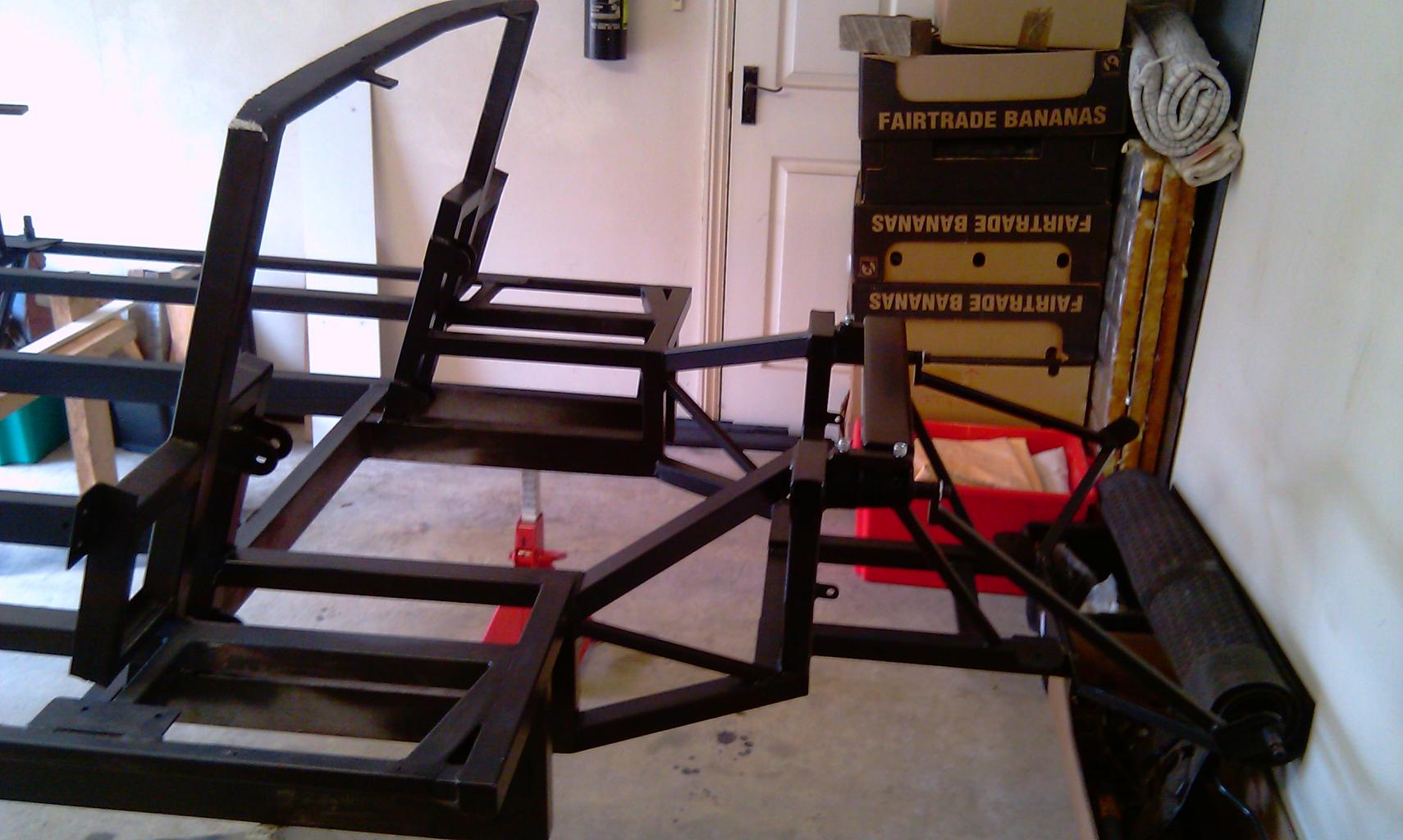

Got the front frame completed at the weekend and made some new hinges for the front, the originals were fixed, the new ones have adjustment up/down, forward/back and sideways.
I have now turned the chassis upside down to lower the seating area 30mm and fit a new floor.
Tony

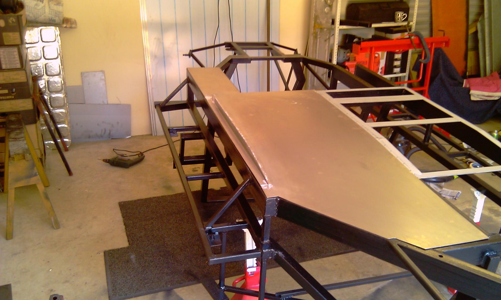

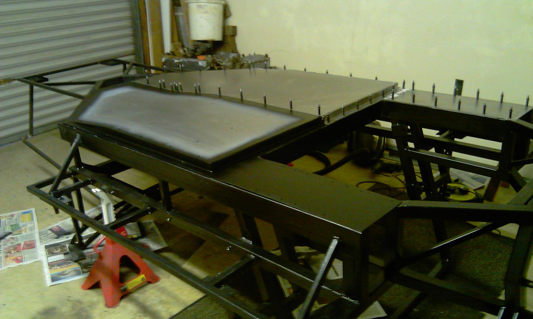

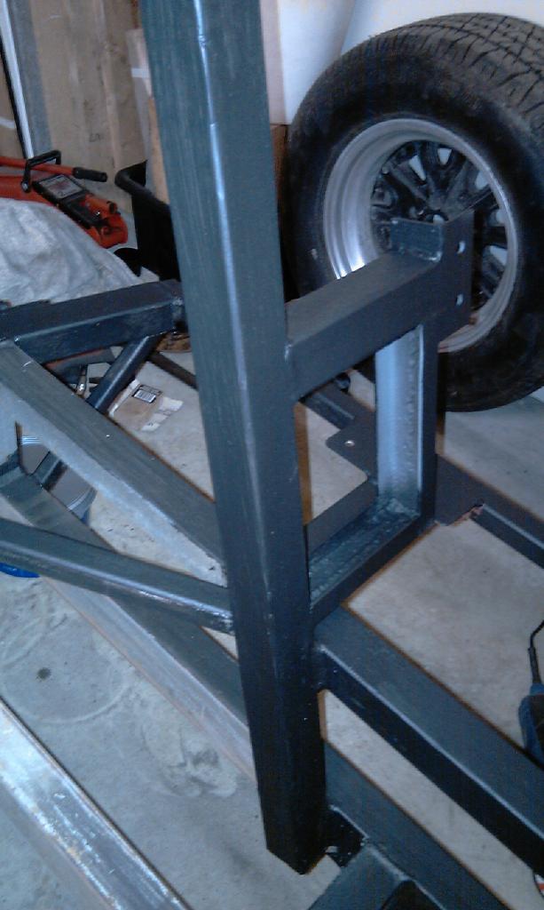

Two productive weekends have seen the seating frames completed and welded into place. The floor panels have been folded and formed to fit over the frames like a glove and all drilled ready for riveting.
Tony

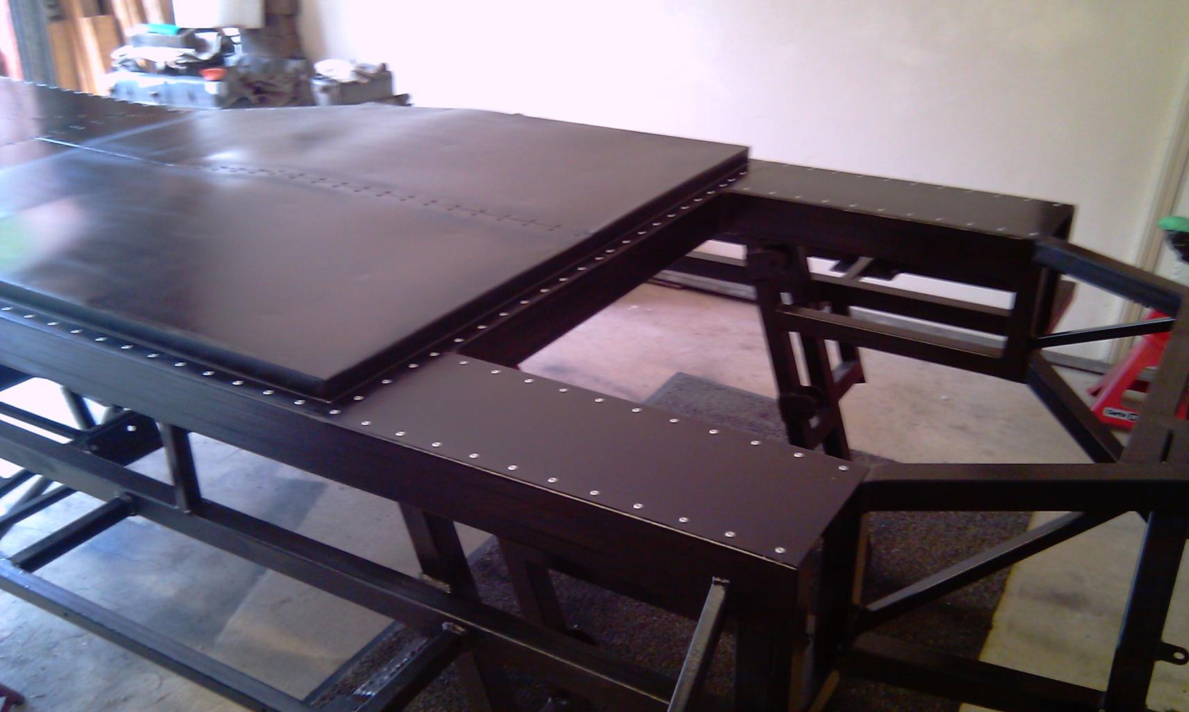

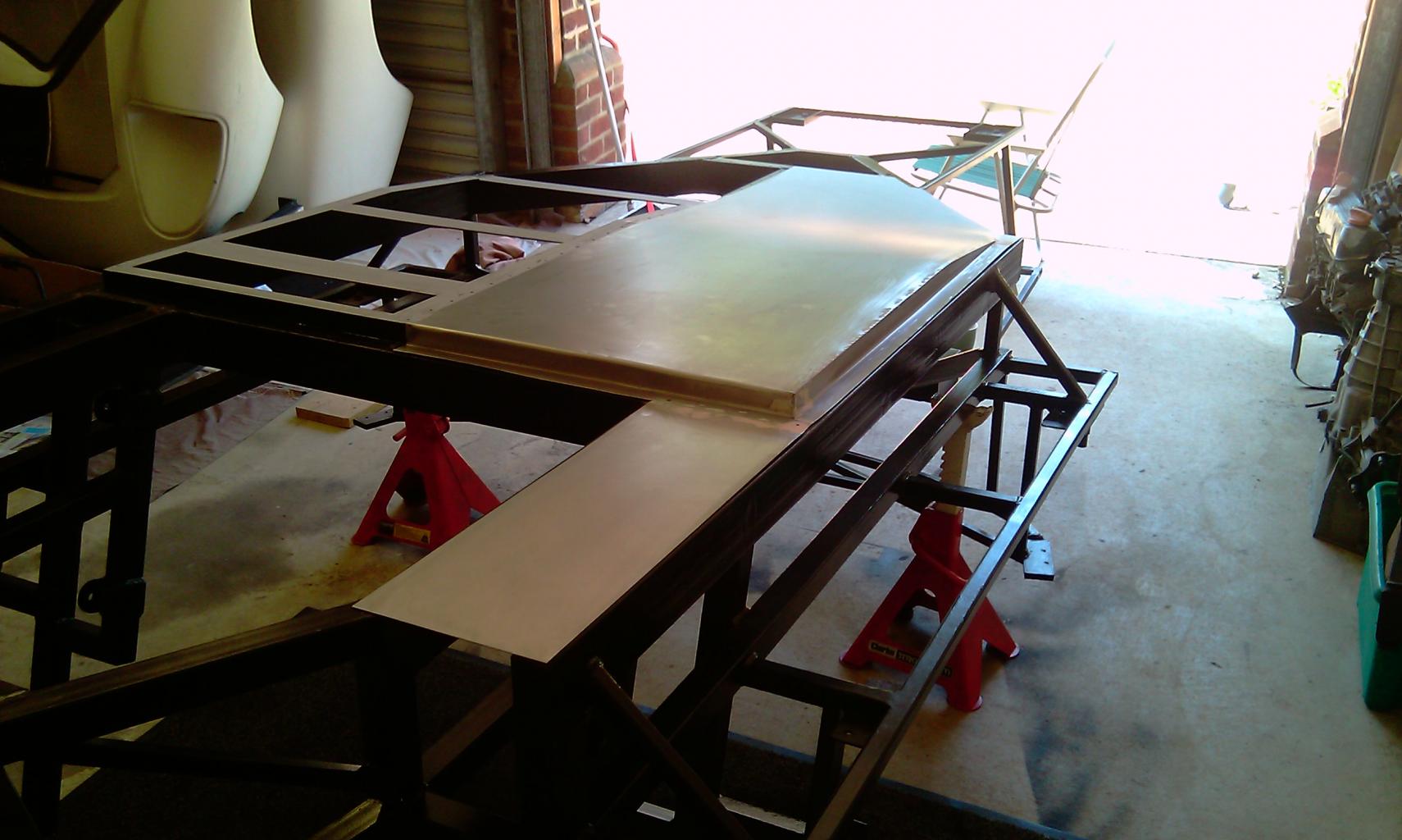

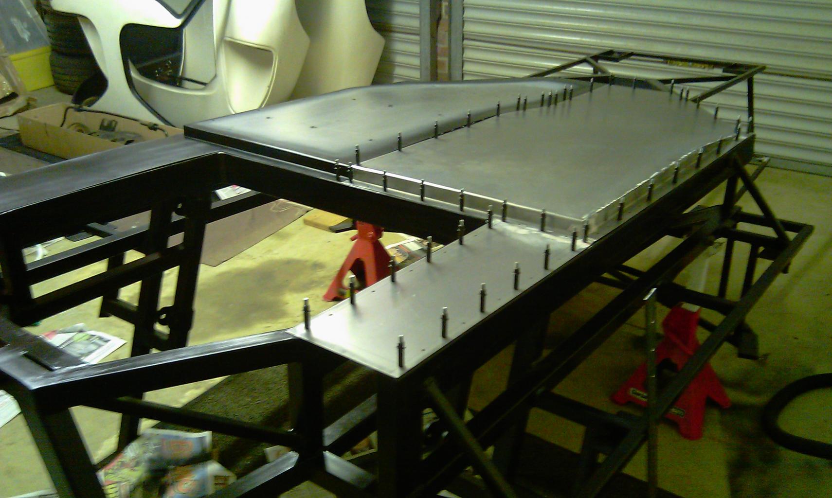

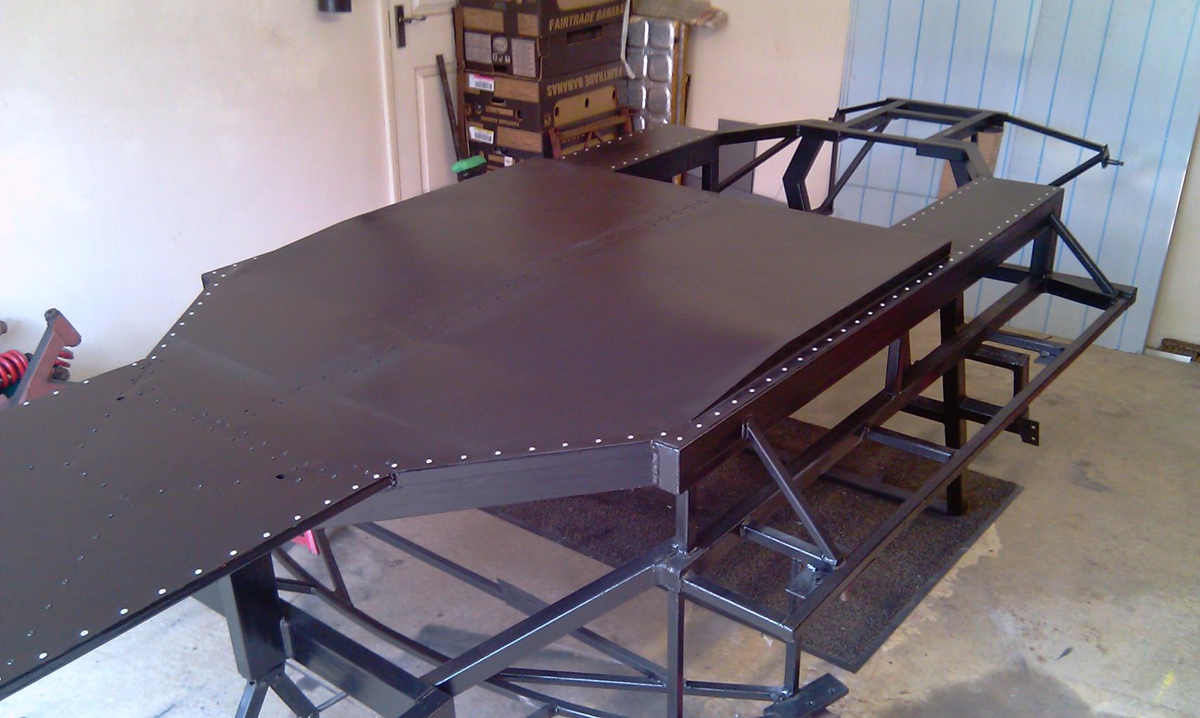

Got the floor all sprayed, bonded and riveted in place over the weekend.
Never moved and worked so fast, with 300 rivets to fit and the bonding adhesive only giving 10 minutes before it starts to set.
Tony
