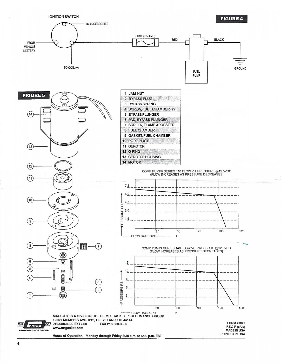

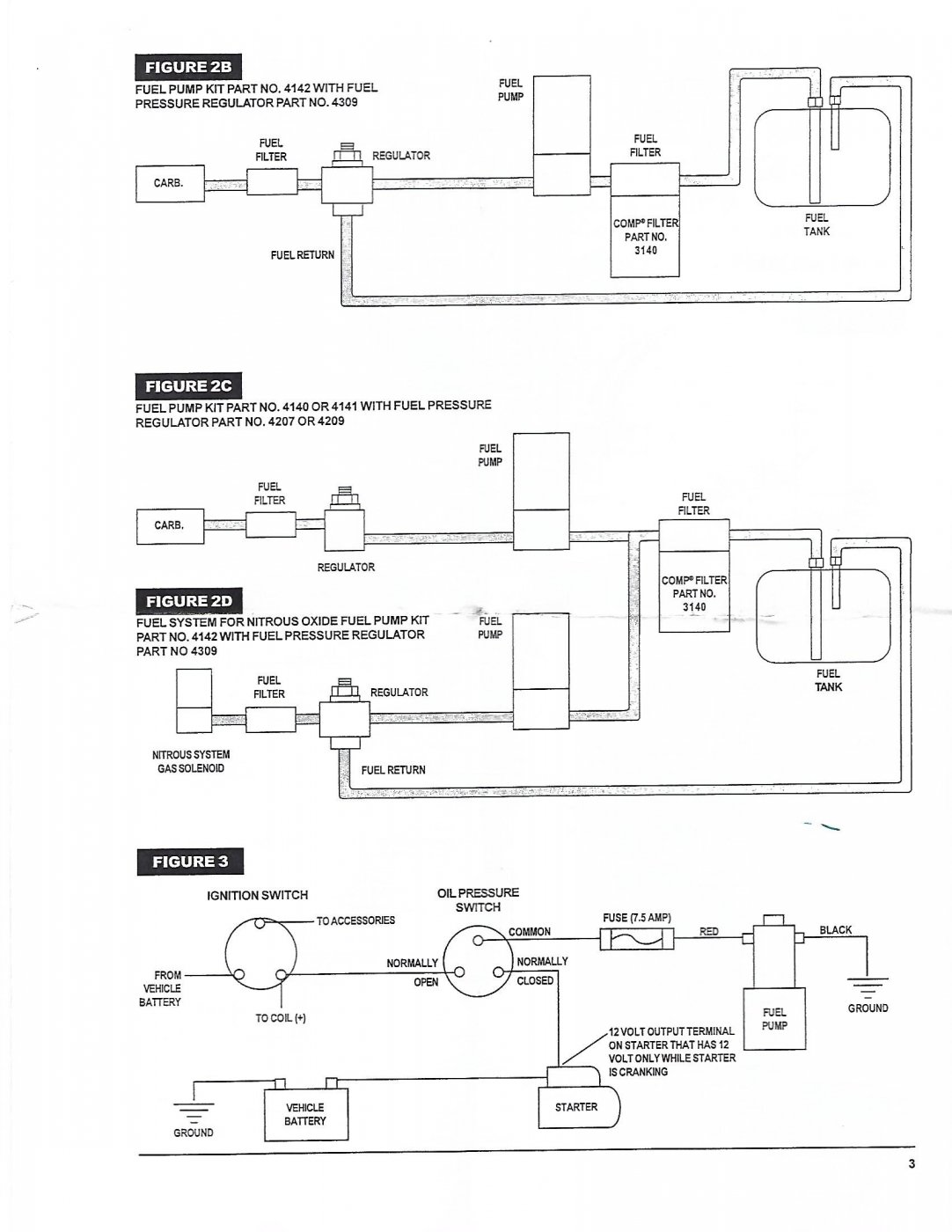

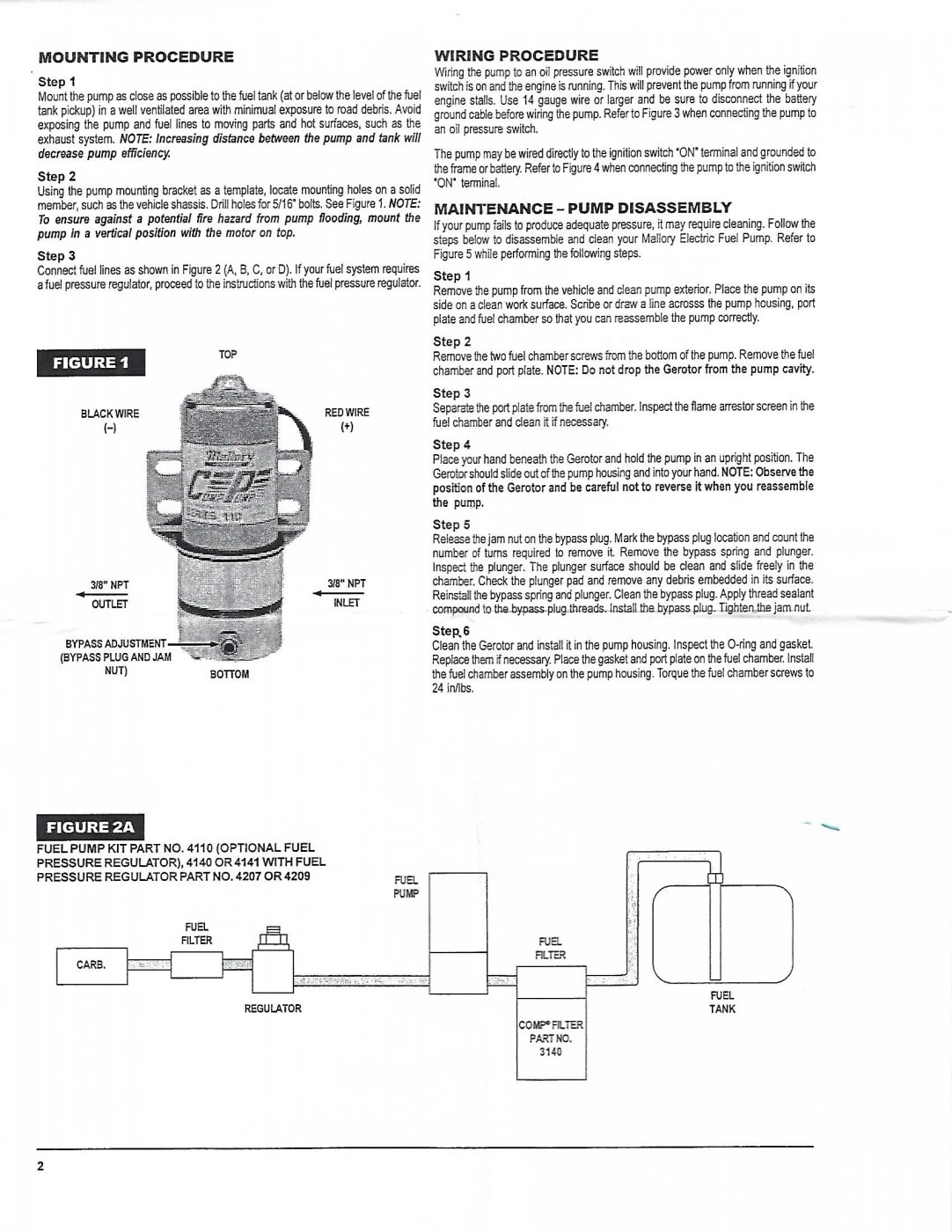

I have not seen the Mallory name mentioned here before. These are very good gerotor fuel pumps. They are available in two models, a 110 and higher output 140. I've attached the instructions for Mallory pumps below.
Notice that Mallory publishes their flow vs pressure curves.

Mallory Comp 110, 110 free flow, about 90 Us Gph @ 6psi. about 95+ Us Gph at 4 psi. Factory preset at 7psi @ 20 Us Gph.
Mallory Comp 140, 140 free flow, 120+ Us Gph @ 6psi. 135 Us Gph @ 4psi. Factory preset at 12 psi.
