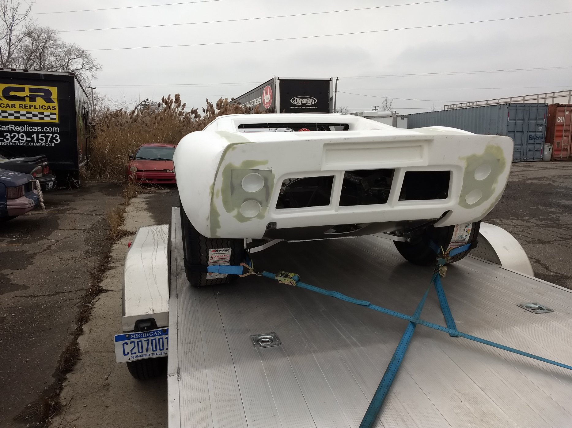

This was one of the options I decided on for the Mk1 kit I just picked up from RCR. I'm not sure where he gets them from but I like the look.

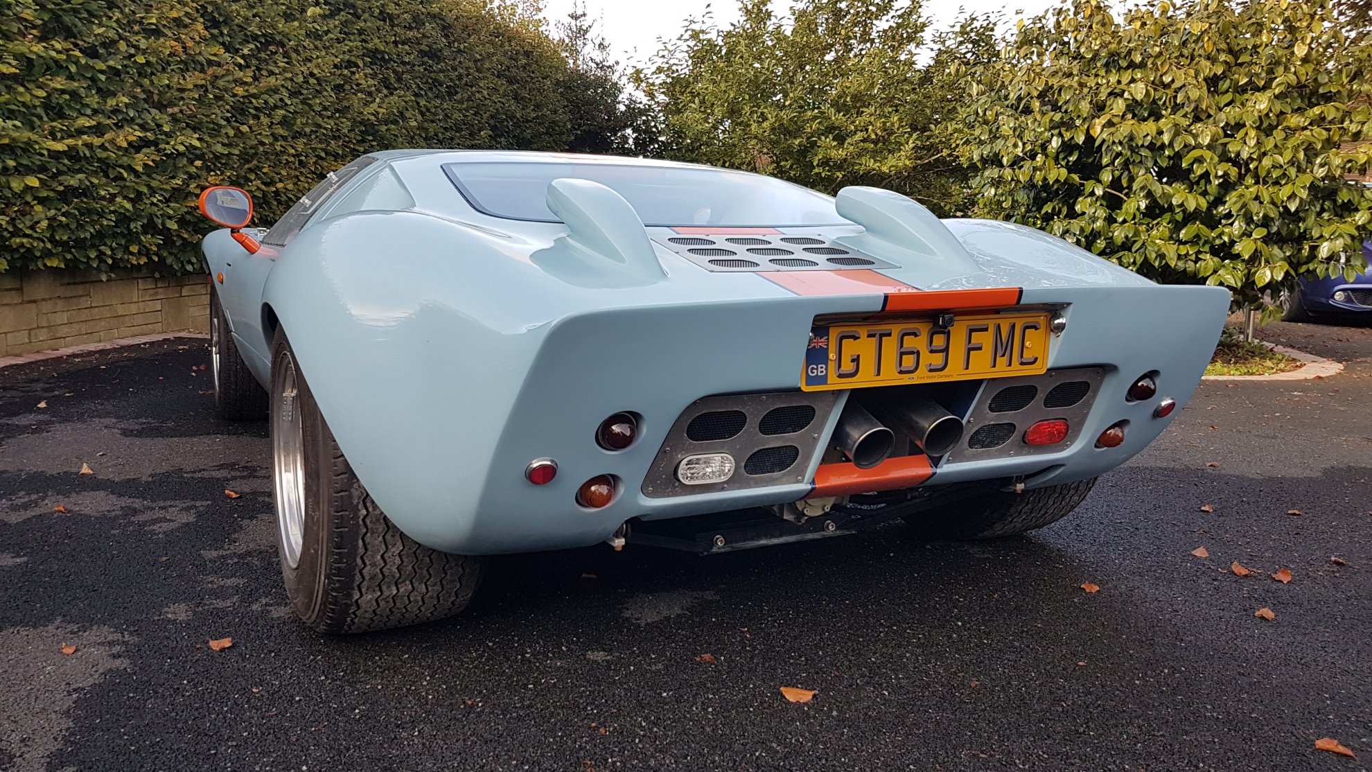

@Shed Racing @Andy318is If you decide on twin rear light setups, I'd be interested to hear what height the lower lights end up at. I'm pretty sure it's a minimum of 350mm for UK IVA test (though you car has already passed, I guess, Andy?).
Rod Dittmar
Eddy,
The height of the bottom tail light on my RCR40 is 18 1/2" (470mm). That measurement is taken from the floor to the bottom of the tail light itself. Hope this helps.
Rod

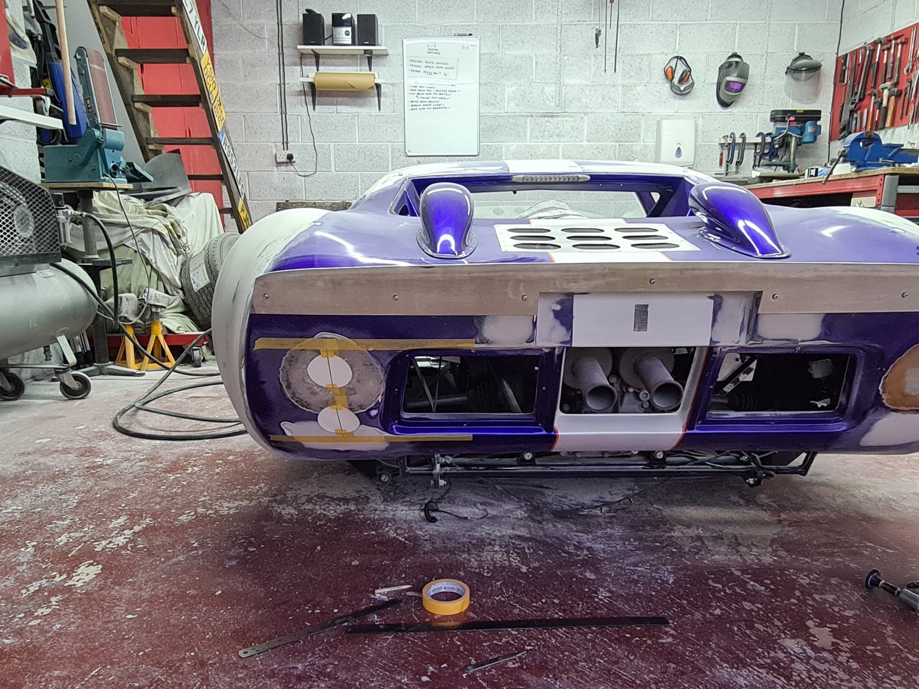

Andrew

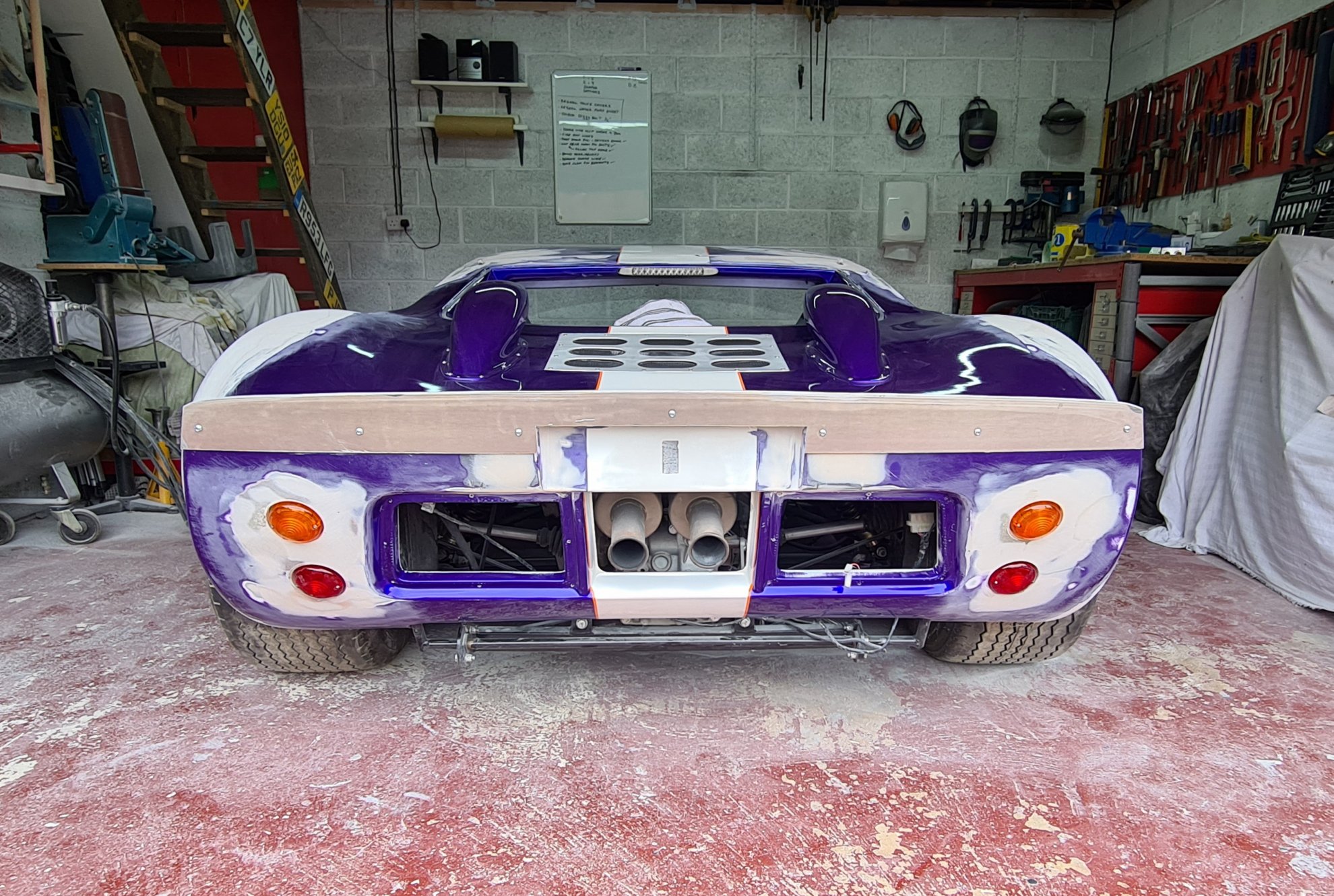

I'm just fine tuning using a couple reference photos as a guide until I'm happy with the look
