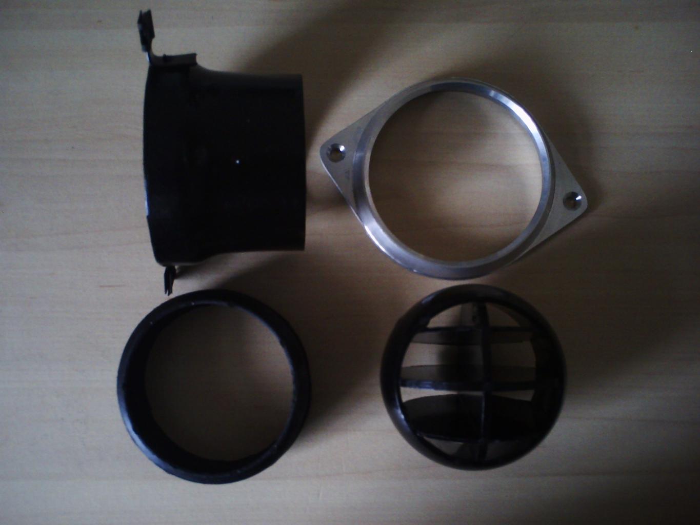

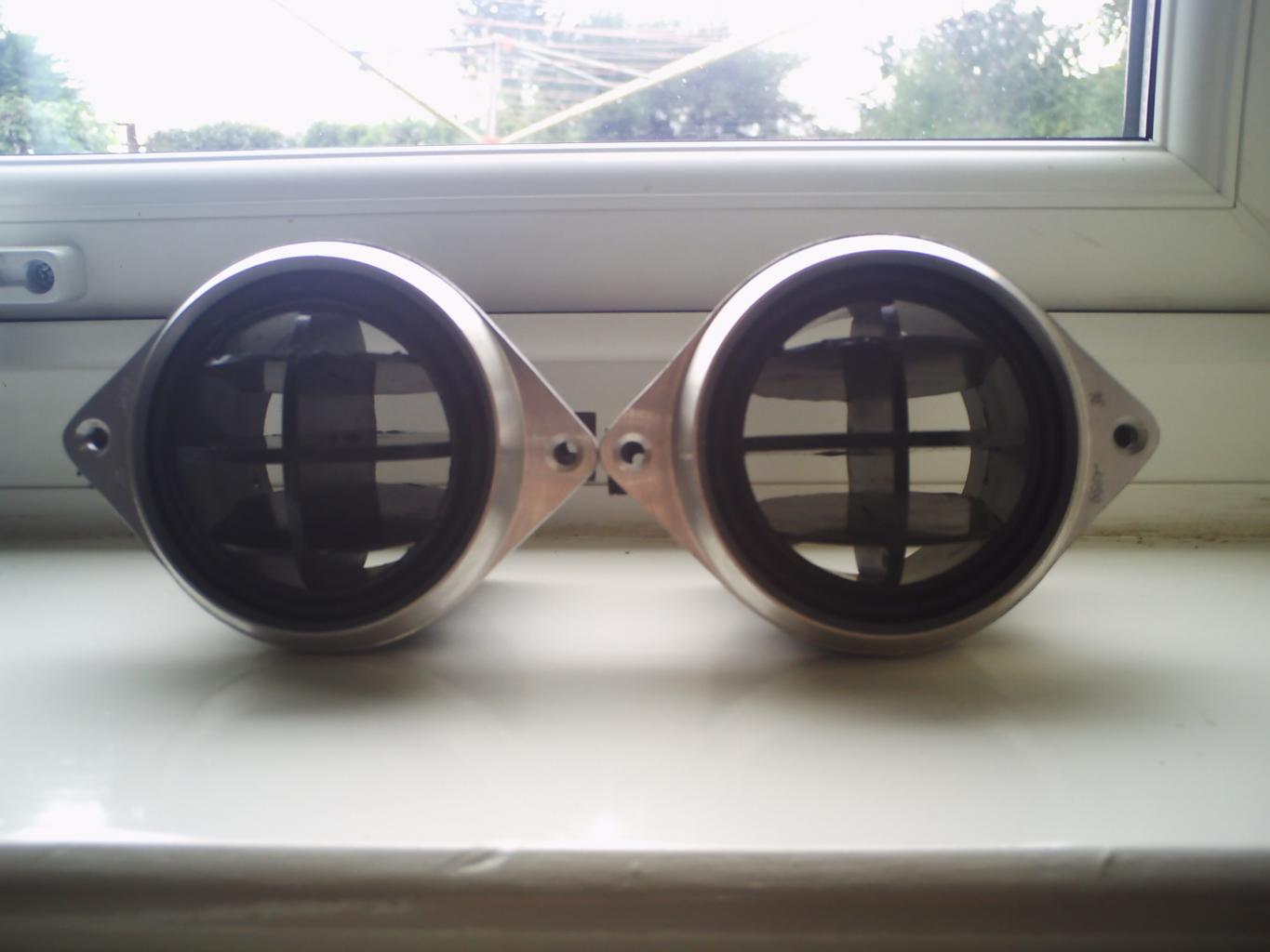

Fit these original style eyeball vents and job done !

Charlie u answered my next question already... I always liked the circle air vents (like the one on the 2005 GT), and wondered if that can be put in the Replica... obviously its yes since you just said it.
Thanks!
I mean interior wise anything can be done right?
I did fall inlove with the GT style seats, those nice silver hole things, the elegant looking dash with the gauges as they are... I mean... that can be done for the GT40 to an extent right?
