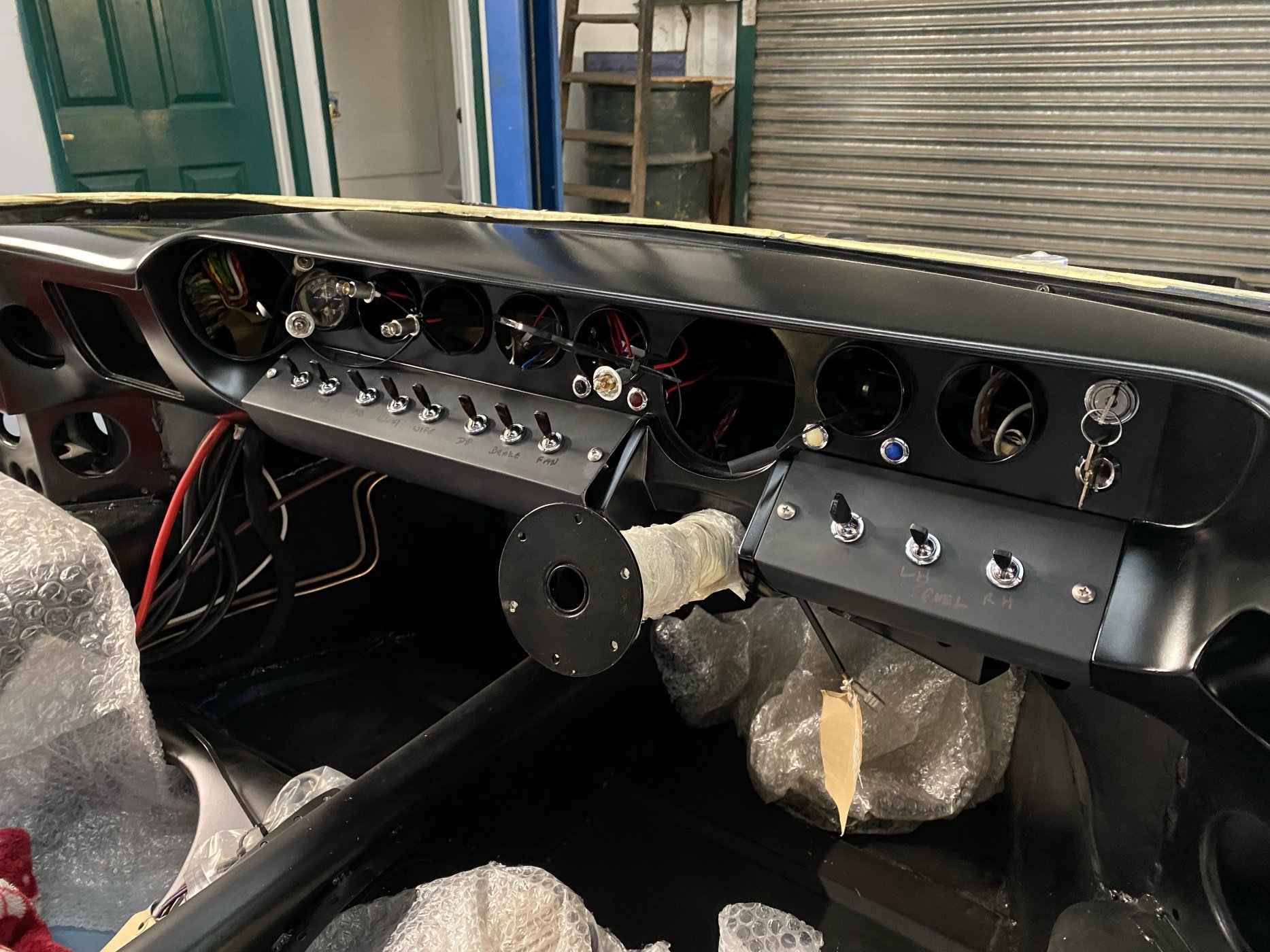

Hi,
Bought years ago new original type wiring harness for mk1 -65 289" historic race car, which is (slowly) being built, but it came without diagram.
I have SAE-papers for mk2, but somewhat surprisingly it`s diagrams doesn't help much.
The seller of the wiring harness cannot be contacted anymore.
The electrical work of racing cars is familiar for me, but it would make life easier and faster if I could get a diagram somewhere. To see wire colors etc.
Any tips? :)
-jjs

I do not recall the source of this, but it is supposedly a wiring diagram for a MKI.
  • Wiring MKI copy.pdf
Agreed Brian :),
And it worked for me, with just a few additions once we got into it.

Thanks Ray, I first try with diagram Brian sent.
I`ll be touch later if needed.
