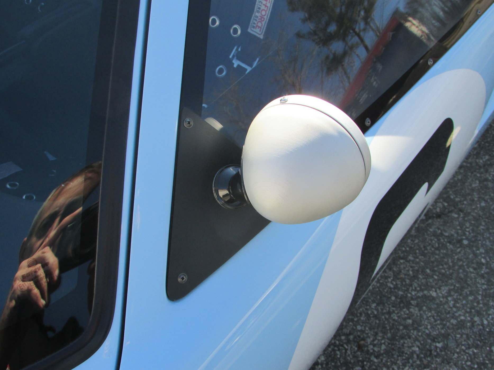

I am having Ray Dots installed like this. (this is not my car)

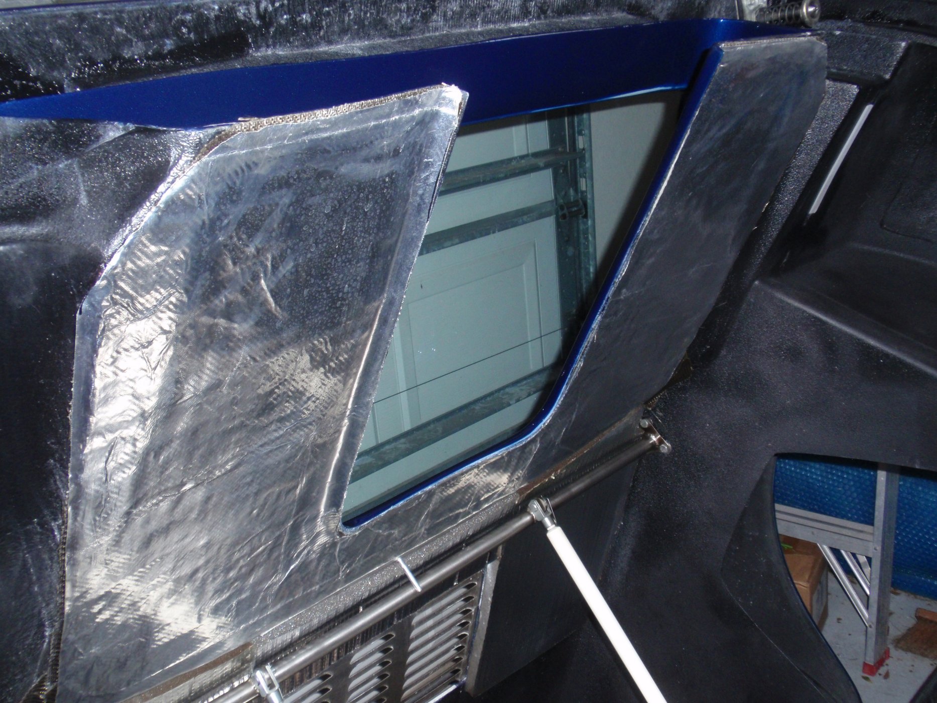

Insulate the area of the rear clamshell above the headers so the heat won't blister the paint --- or worse. After some experimentation, I use a base layer of Dynamat Extreme, then woven Lavamat with a DEI reflective layer nearest the headers.
