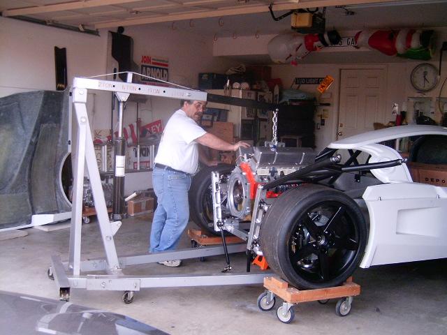

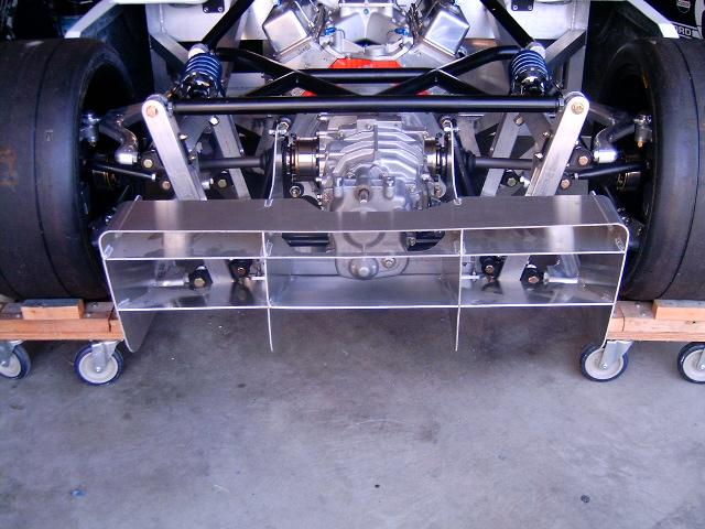

Make some of these. They are better than the metal ones you can buy because they get the car up off the ground high enough to slide yourself under to work on the very few things that are under the car.
You don't need expensive wheels either because there are so many the load is spread among them. 200lb capable wheels will do fine.
I made mine from some 1/2 inch leftover plywood doubled up and glued together. I've been using them for 20 years now and they might be the best use of tool money for both my GT40 and SLC so far. I actually built both cars on them.

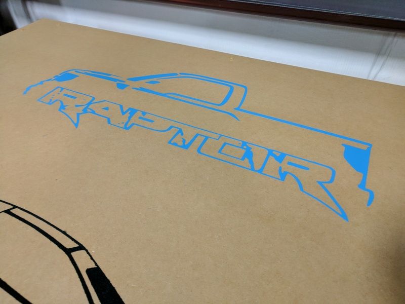

Over the weekend I added a few random designs I had already drawn up in CAD to another bench. I don't own the Raptor anymore, but like the design anyways. I did buy a gallon of some oil-based polyurethane to seal up the tops when I'm doing painting. I still have one more bench to add something too, just not sure what I should put on it.

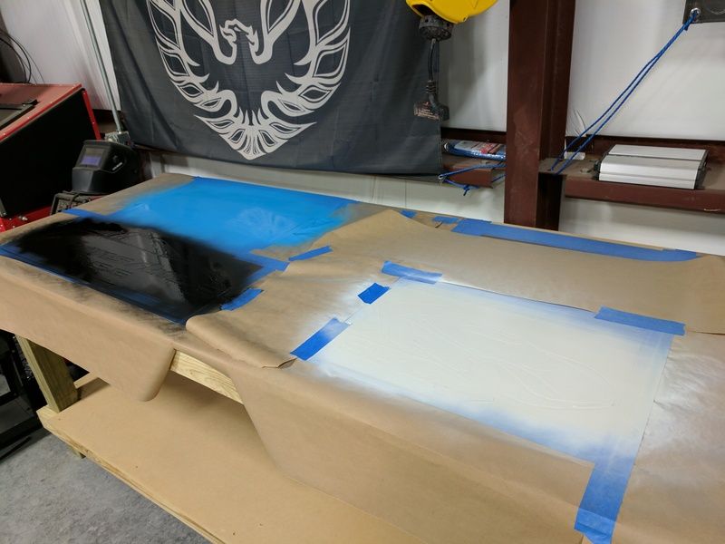

Bought some satin polyurethane, took a whole gallon to do 3 coats on upper and lower levels of these 3 benches. I'm going to get a couple more gallons to seal up the other 5 benches I made.
Apparently silver/chrome paint of Superlite logo does not like the poly, it started smearing when I was putting on the first coat. Rest of them I had no issues. It looks worse in pictures than in person, it's still easily readable at least.
