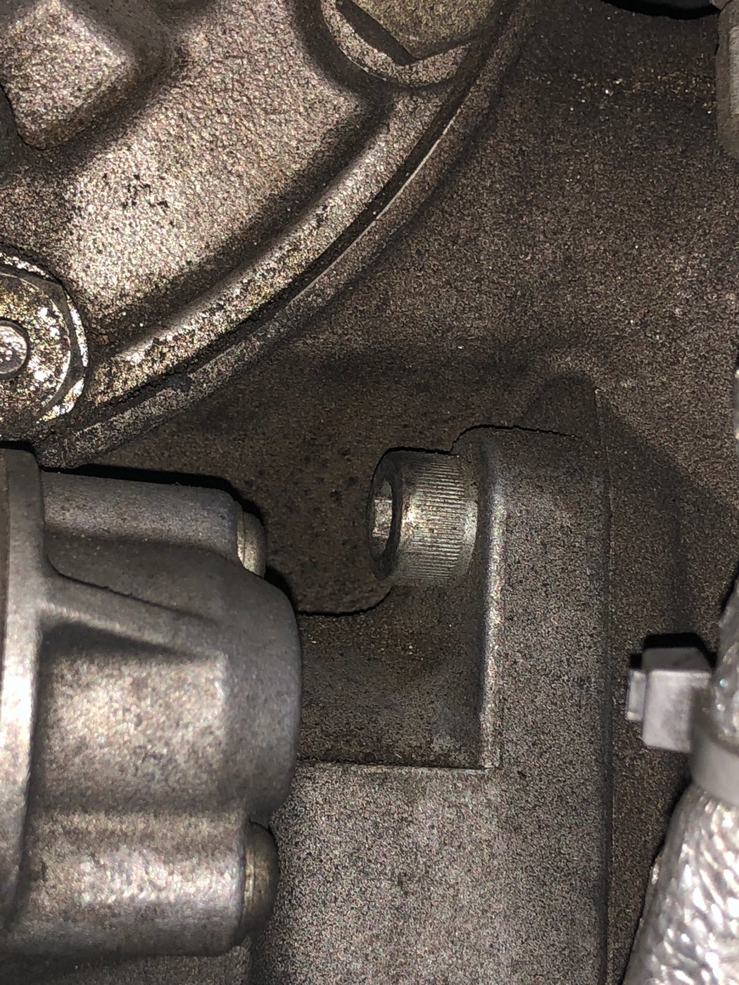

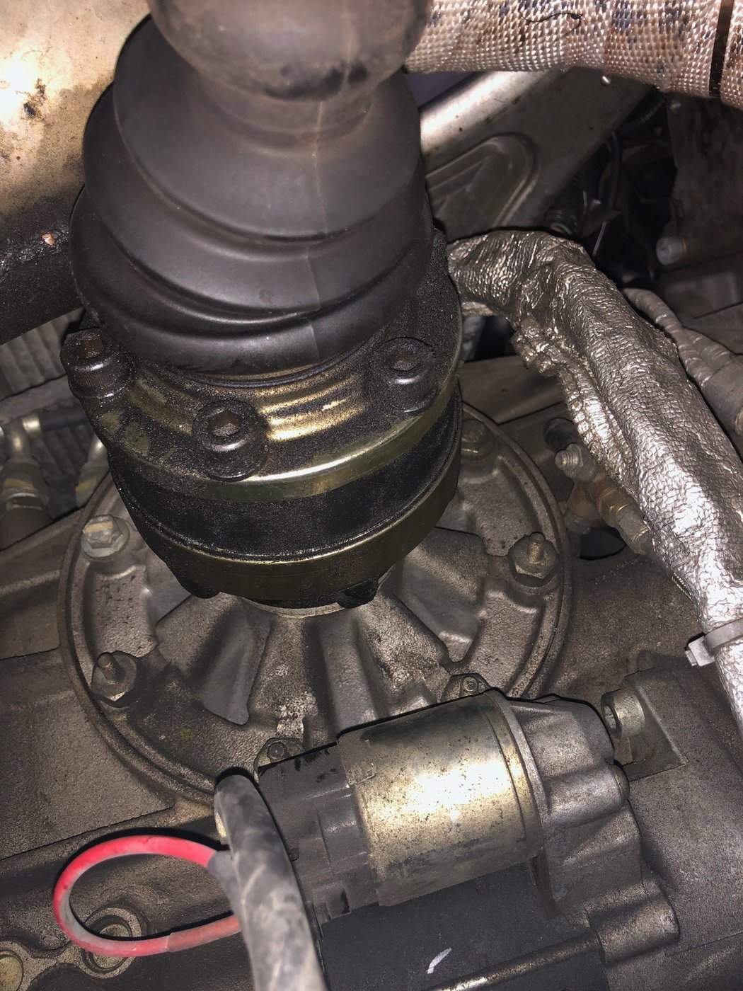

Small problem with top bolt. No convention ratchet or socket will fit. Can anyone confirm it’s 8mm? Also and ideas about removing welcome please.

Kernie, I won't be home until Monday, or Tuesday, but could check for you then. My advice is to buy some of these Metric Bondhus allen wrenches.
http://www.bondhus.com/bondhus_products/tool_categories/l-wrenches/briteguard_stubby_double.html
DO NOT BUY cheap import versions for this job. These allen wrenches have a 100 degree angle and are ball ended on the short end also. Cheap versions often break the ball off in the bolt, and then it is near impossible to remove the bolt.
Exclusive MaxTorque™ ball end:
• on short arm allows access to screw heads located in tight spaces straight-in or at an angle
• delivers 50% more torque than conventional ball ends
• inserts into screw and works at a 125 degree angle
Standard Bondhus ball end on long arm inserts into screw and works at a 15 degree angle.
Extra long length provides for greater torque
If no one else gets you the info by Tuesday, I'll get it for you.
