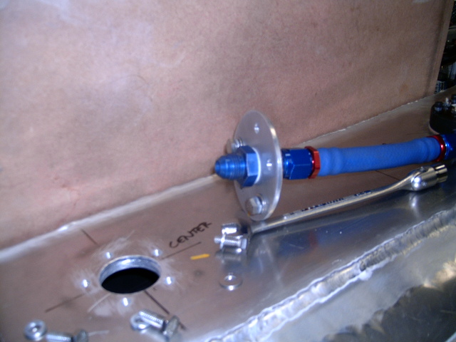

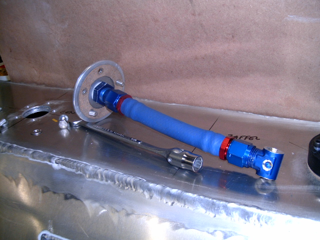

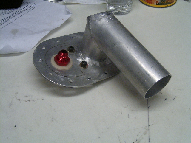

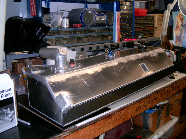

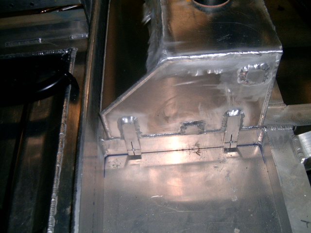

Here's what I think. It's not the mainstream opinion. I don't like ANY penetration of the fuel tank that will allow a full tank to leak fuel due to gravity if a hose or any other component down stream attached to it fails in any way. Not every leak can be prevented but this one can.
When I first Iooked at my fuel tank I saw a huge fuel leak if a hose failed due to the bungs you guys are talking about being at the bottom of the tank. I covered them all up and welded a the plate in place.
All of my connections enter the fuel tank from the top through either the fill plate or a second fuel delivery plate. The pump must pump up hill to get the fuel out of the tank.
Should the car get upside down. All the openings have roll over protection.

Neil

My tank has three transverse bulkheads in it that divides it into 3 sections. All 3 sections drain into the center one via holes at the bottom rear. It also has a sump in the center section that the pump draws from and it holds about a 1/4 gal. So far the tank seams to draw all the fuel out before I see any low fuel issue, so I think I have addressed any potential slosh problem.
