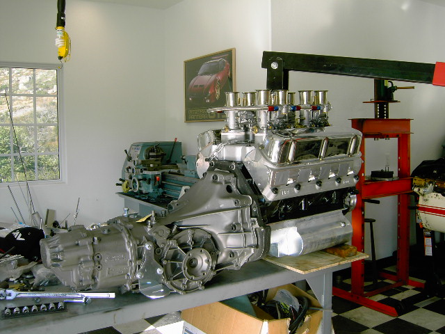

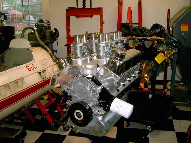

This is going to be a very nice car, T & L 347, Weber 48 IDF's, Audi trans, wide body Gulf trim, 17 " wheels.
The CAV comes with all of the needed adapters, including the clutch and flywheel, for the Audi trans.
I will post pics as the project goes forward,

Update on this build, engine and gear box is going in today.
The CAV comes with the adaptors, clutch flywheel and bolts and other than an interference problem between two adapter bolts and the flywheel it all went together perfectly.
Dave
