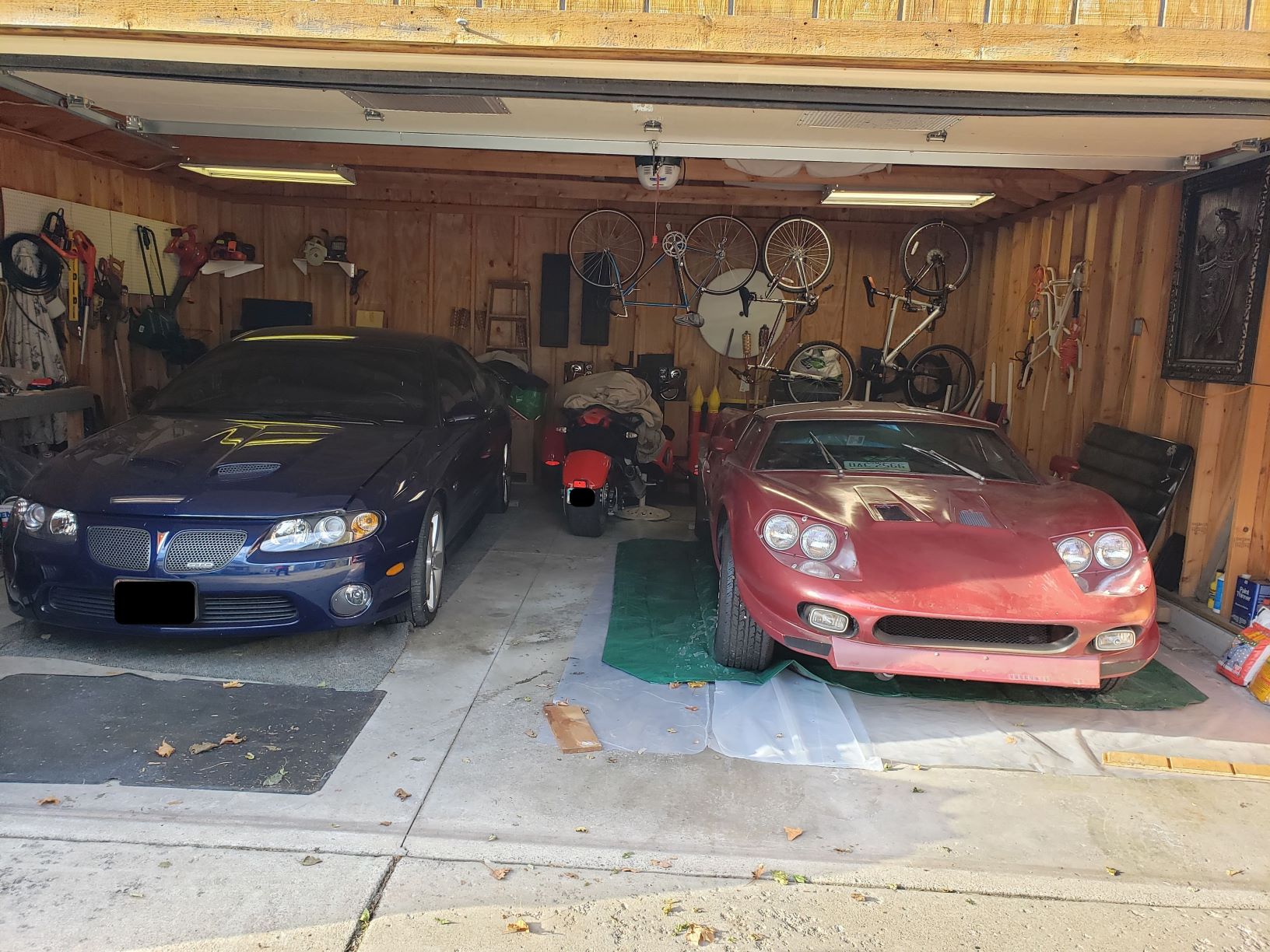

Just wanted to say "hi". I saw a few threads on Fiberfab Kit cars. So far not much is out here that I can find for forums. Anyways, my dad gave me his Valkyrie that he completed and titled in the mid '70s. It is the slightly longer, molded in front spoiler full ladder frame but not tilt back model. Dated, needs some TLC but I still love it and can remember him building it.
Thanks, my uncle did them back in '75. The car sat garaged for at least 25 years but you know how that goes... not much wear and tear but age.
Neil

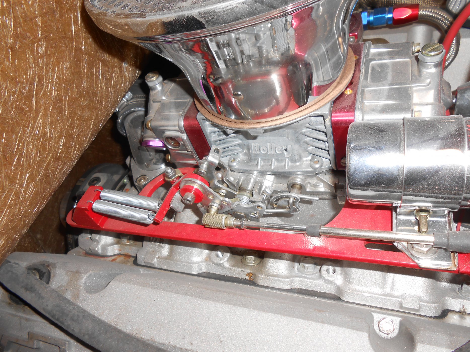

I've got the mechanicals pretty well figured out on mine, just doing the final bodywork and assembly. I used a morse cable for the throttle with a sand rail gas pedal from EMPI. it seams to work well. I have a 4 pinion posi 4 speed trans axle with 3.70 gears. Word on the street is it should be good for close to 400 hp.
That's great then you're coming along good. Thank for the info- its a cable on mines now but it binds and will need to be done over. I was going to try something different like hydraulic or an electronic servo-type but that doesn't seem realistic at this point. For the diff, do you mean the 4 spider gear or "Crown" kit in a 'Vair transaxle or something else? I'm a stock '70 LT1 350, so I should be around 370 HP. No way I can do a ZF, etc. If you don't mind, what brand swinging pedals did you use? Are you running the 'Vair front end or did you go with a rack and pinion? Thanks

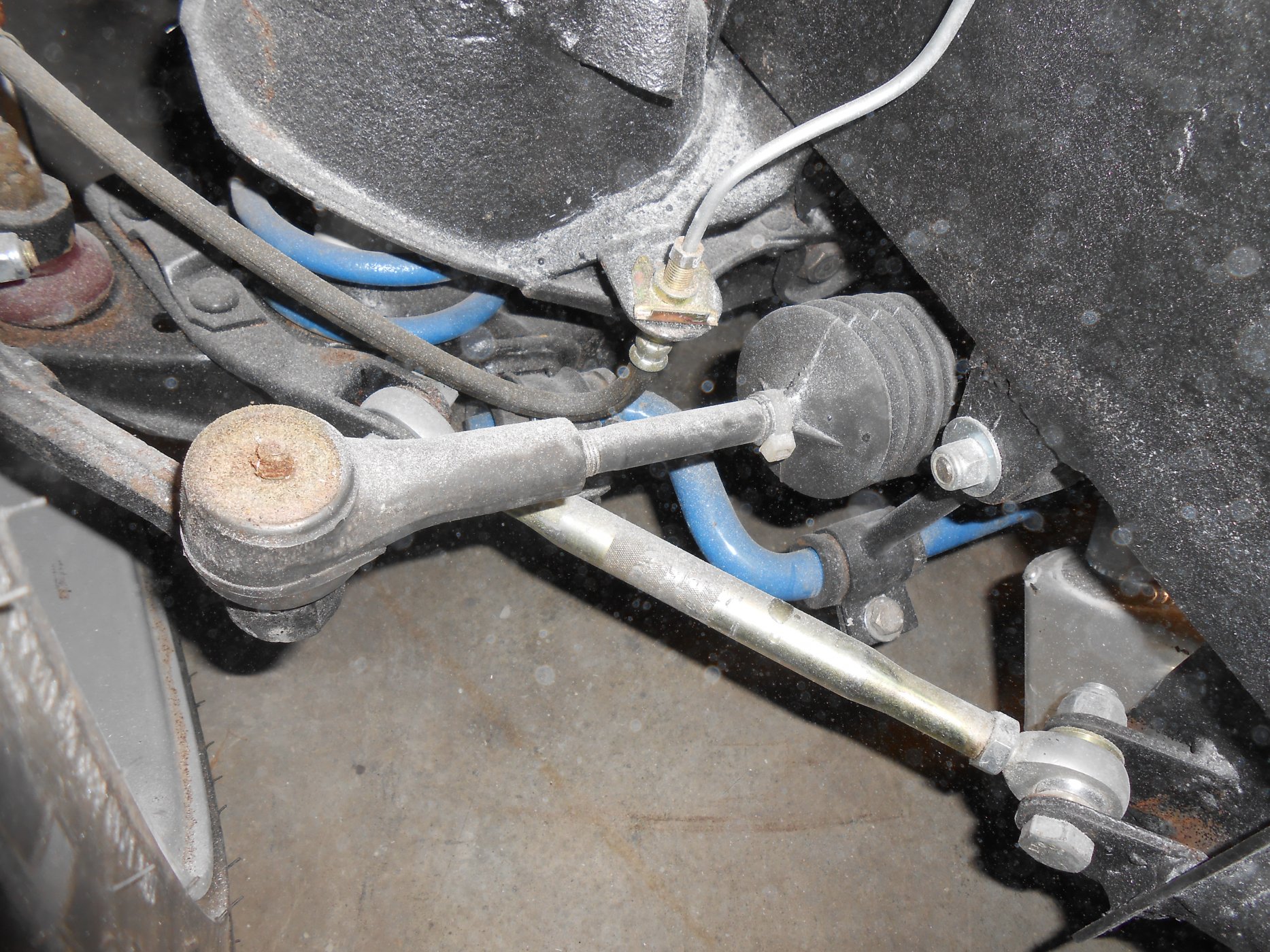

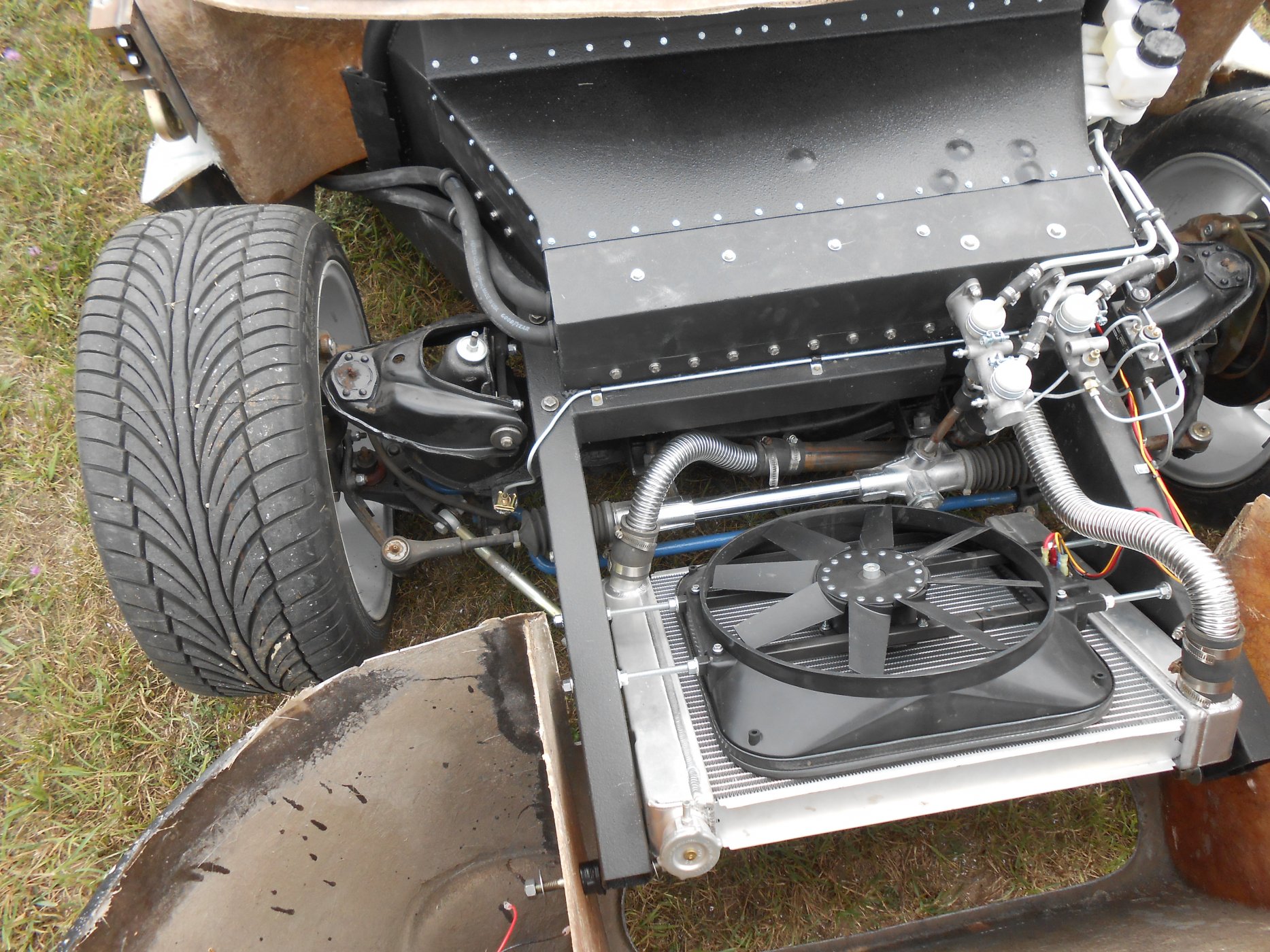

Oh, and by the way, Idid go to a Mustang II rack and pinion, just had to redrill the steering arms to the correct taper for the ford tie rod ends. super easy.
Thanks for sharing, I'm taking notes. I think that's the way to go instead of trying to restore the 'Vair front end stuff.
Added a couple photos so you can see how I did my front end/ lower arms and rack and pinion, threw in one of my carb linkage too.
