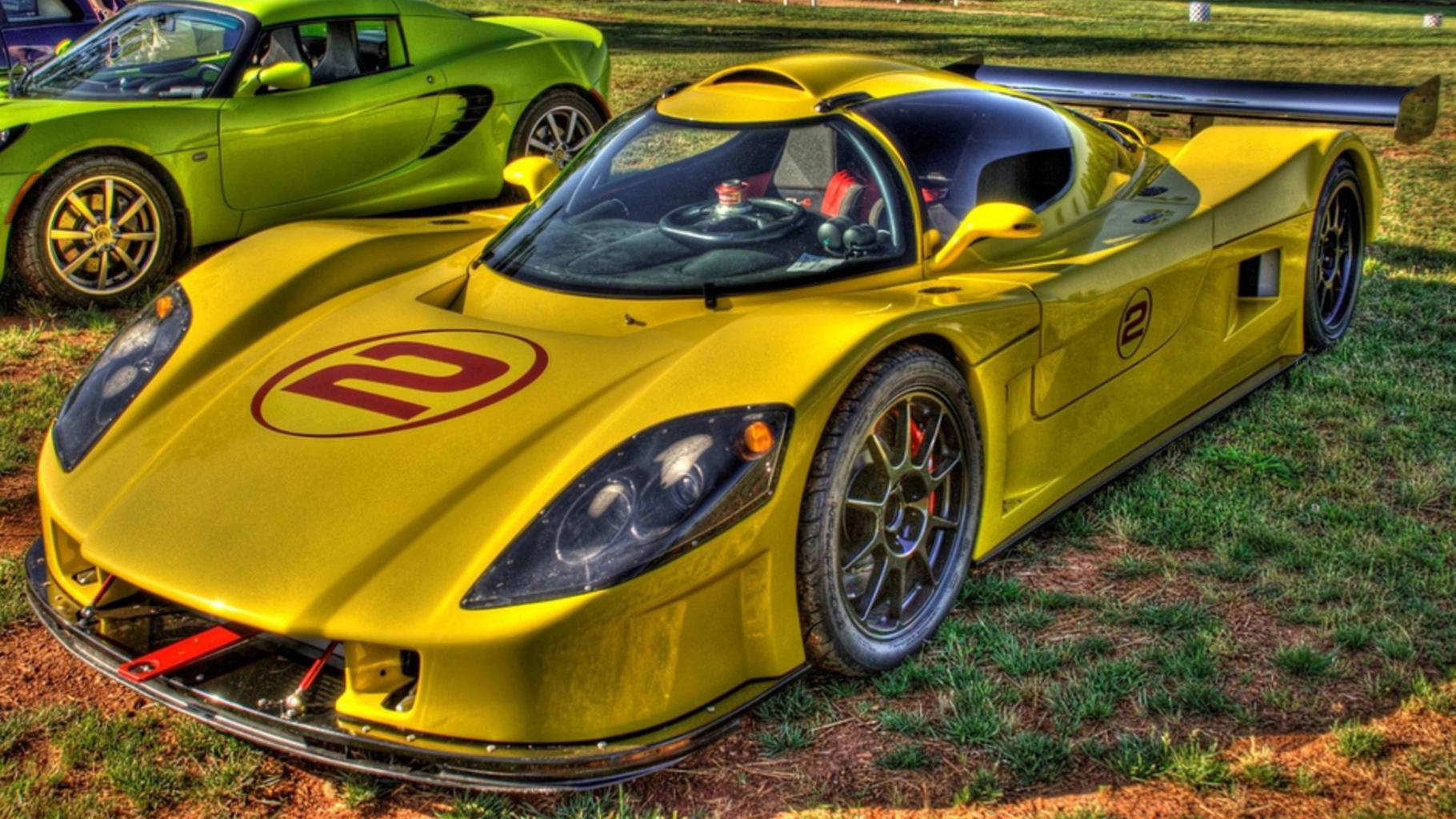

I found it in someones flickr account and I imagine they did the PS work. I only downloaded and doctored it to make it suitable as a desktop pic. I have a high res version if anyone wants it.

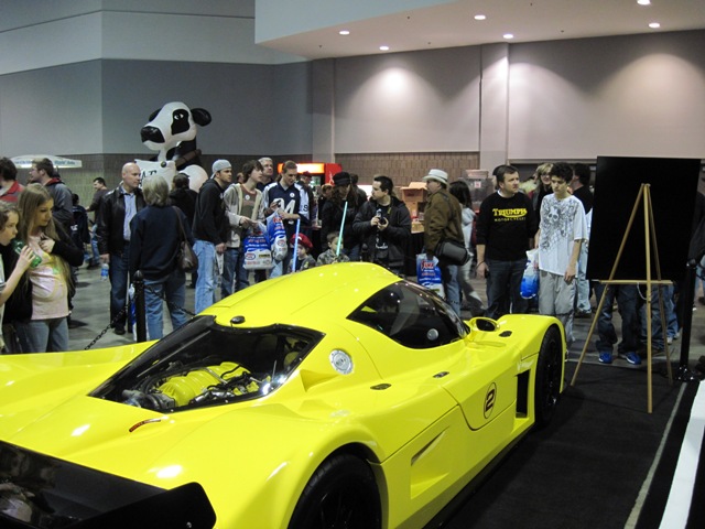

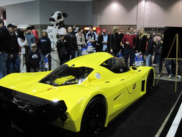

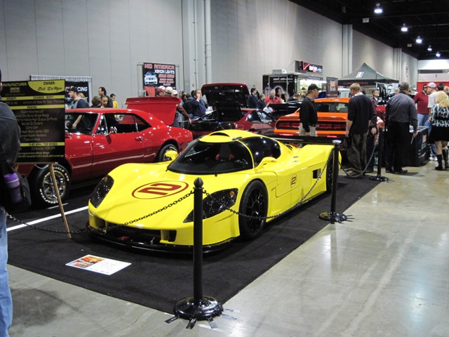

There you go Dave that is my car. I am almost positive that picture was taken at Road Atlanta at the Walter Mitty event. That is really a cool look. I do have a picture made when we were at the World of Wheels in 2010, which I sent a copy to Fran, of my car with 3 different views with the number 2 as a phantom in the back ground which also really looks good. I have one hanging on my wall in my office which I catch myself staring at it instead of working all the time. By the way we won first place for best exotic in that show which is the biggest car show here in Atlanta held once a year.
