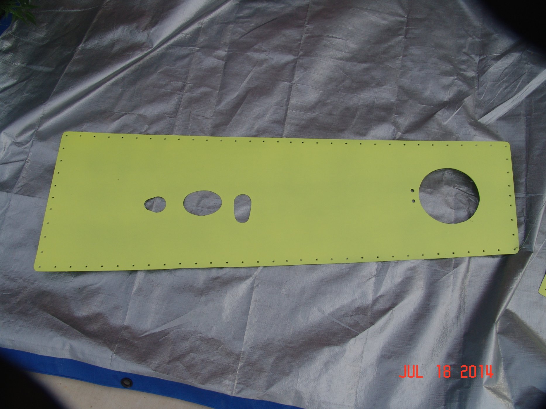

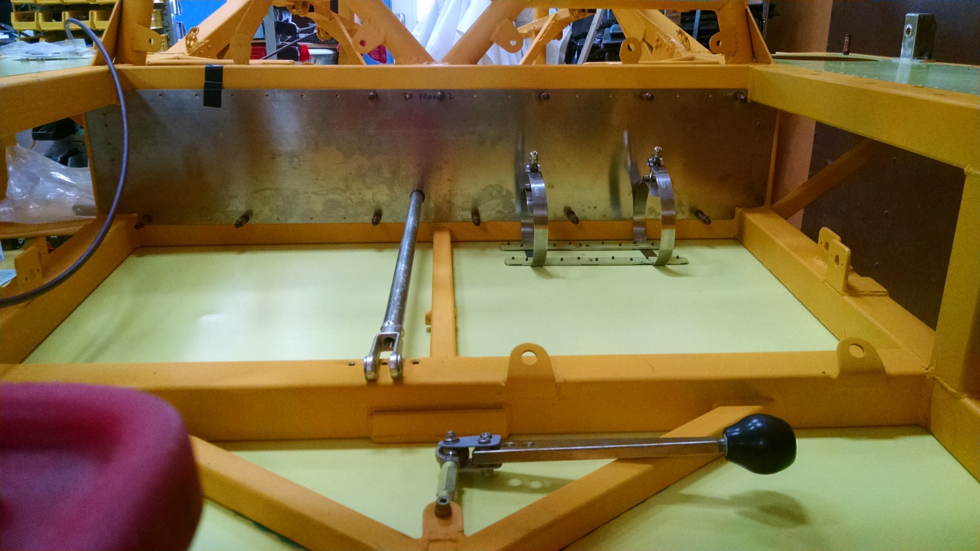

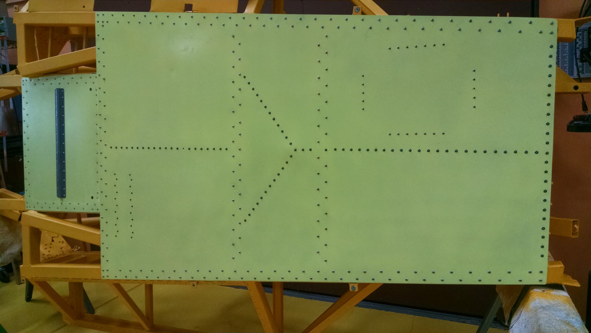

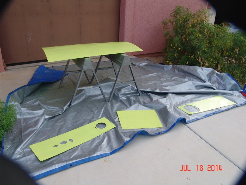

Nobber, there is a 4th choice.
Instead of a 2k spray can epoxy primer use a good two-part epoxy primer and a $9.99 (on sale) spray gun from Harbor Freight. After use, clean it or throw it away. The 2k spray cans work well but when you are going to cover anything but a small area they are not economical. Do not forget to prepare the aluminum panels by lightly scuffing them with Scotch-Brite pads, wiping them with a solvent such as MEK, acetone, or denatured alcohol, and then wiping them with a phosphoric acid etch and then rinse well with clean water. Handle the panels with nitrile or vinyl gloves to prevent transferring oils from your fingerprints on to the clean panels and then spray on the primer after the panels are totally dry. Having all panels prepared and ready to paint helps things go quicker.
I used, and recommend the 2-part epoxy primer from Aircraft Spruce made by PTI Specialty Paint & Coatings, gallon yellow: p/n 09-00932 and gallon green: p/n 09-00933. These are for a "kit" that includes both components, resin and primer. Not everyone likes the look but, to me the green or yellow finish together with well spaced rivet patterns adds a bit of aircraft panache to the car.

I would paint the panels after they are drilled and test-fitted. Painting them after they are riveted in place would be a masking tape nightmare.
