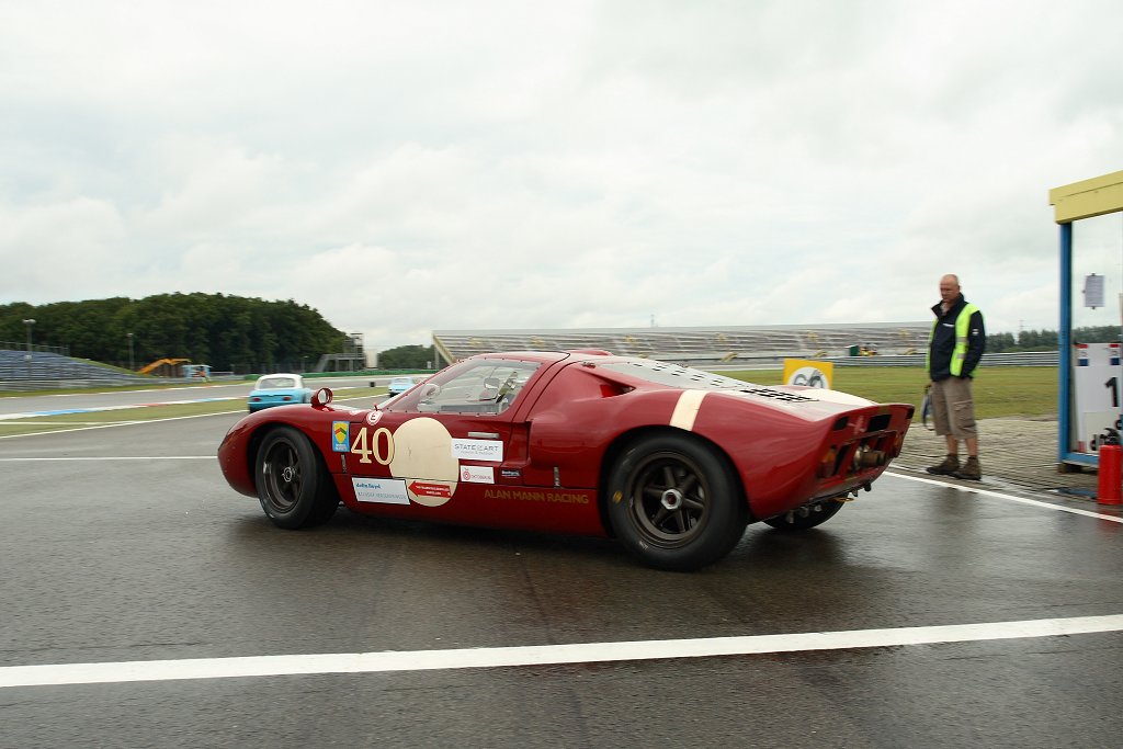

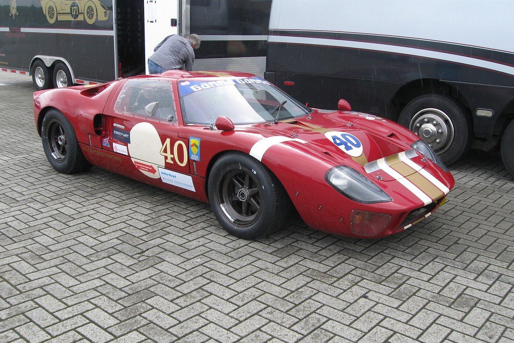

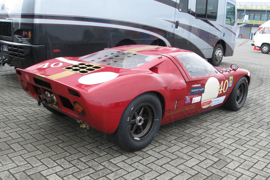

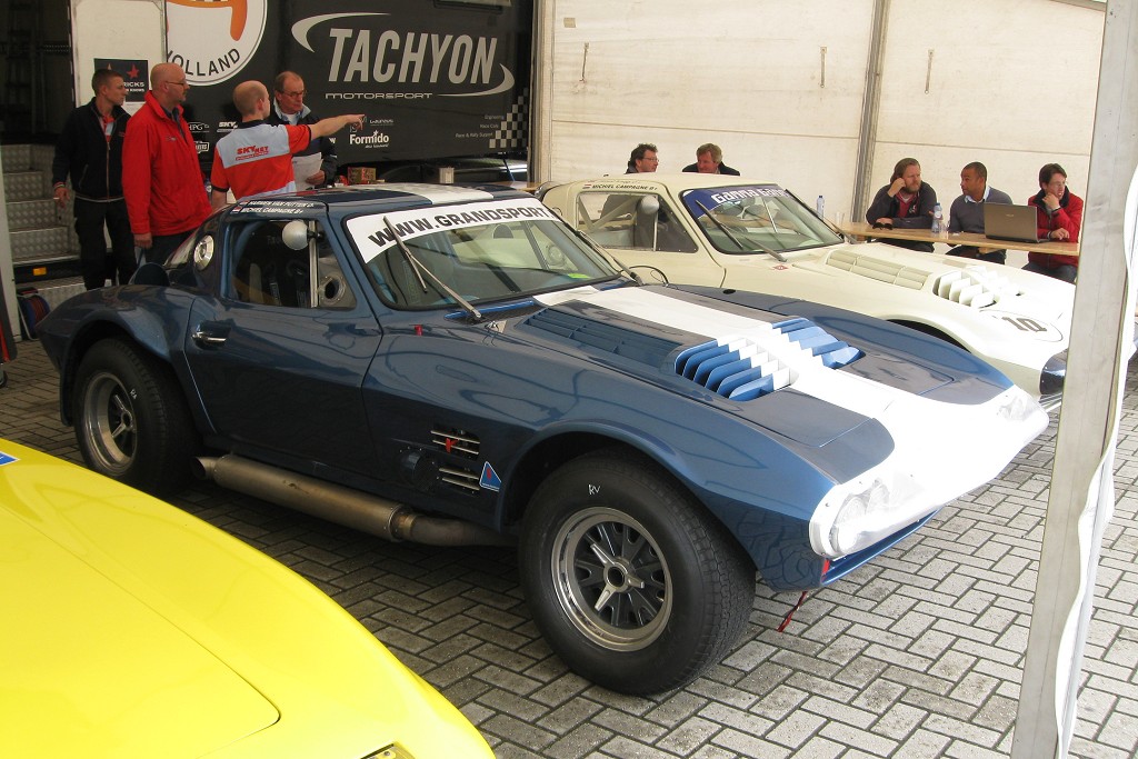

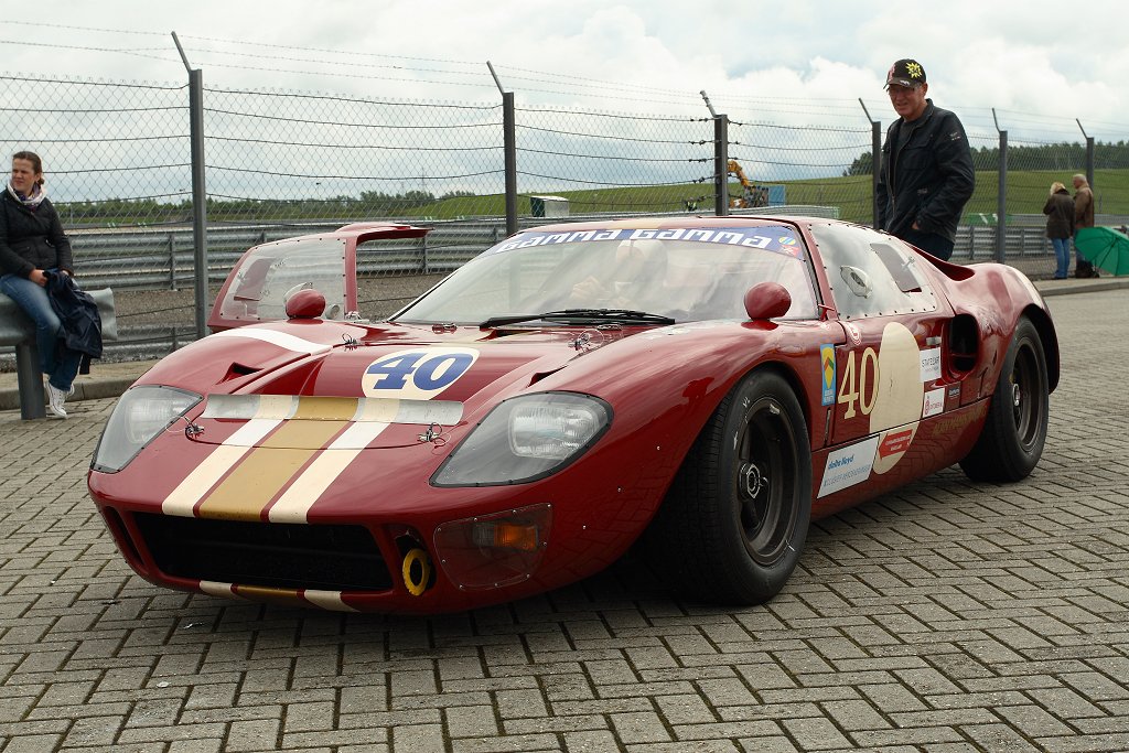

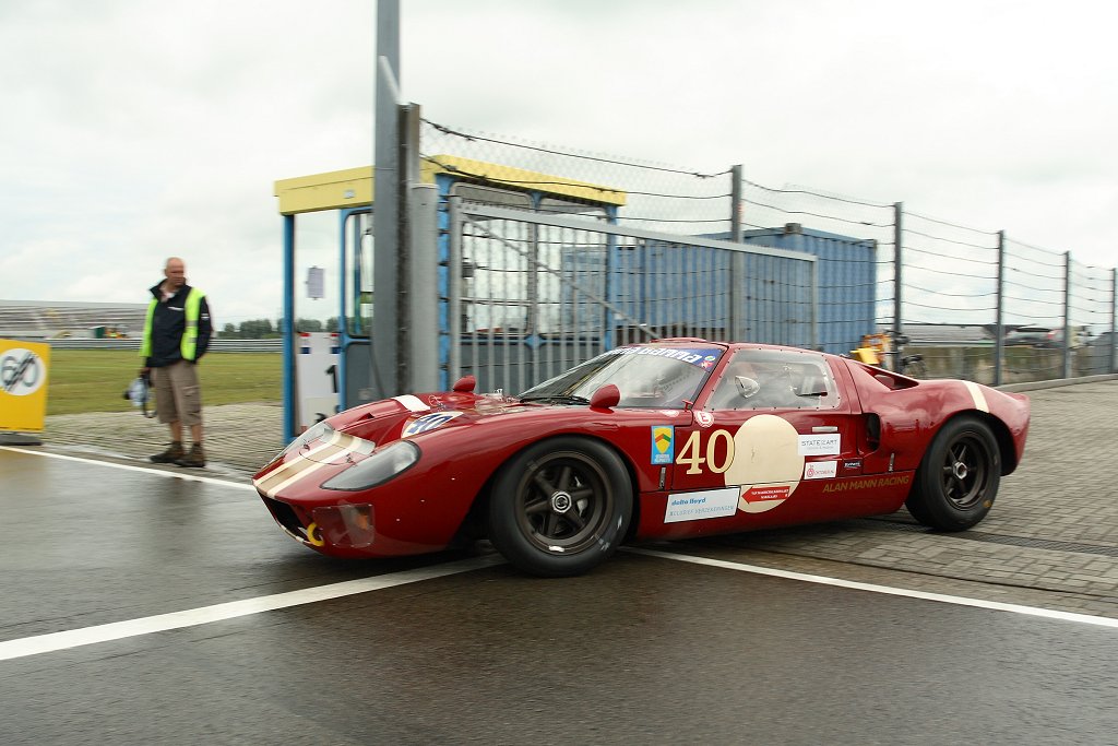

Pictures of 1023 at historics in The Netherlands
This weekend the Dutch Historic Championship will be held at the Dutch TT circuit, famous for it's World Championship Motorbike event, and chassis 1023 will be raced there as well.
These pictures were taken today at free practice and also show two Corvette Grand Sports. Thought you might like to see them.
John

I seem to recall a thread elsewhere on this forum where this red car is described as a Superformance car rather than the genuine article. It does appear to have SPF characteristics (exhaust etc.)
Does anybody else remember that thread?
I think the Gran Sport Corvettes are SPF replicas as well.
http://www.superformance.com/corvette.aspx

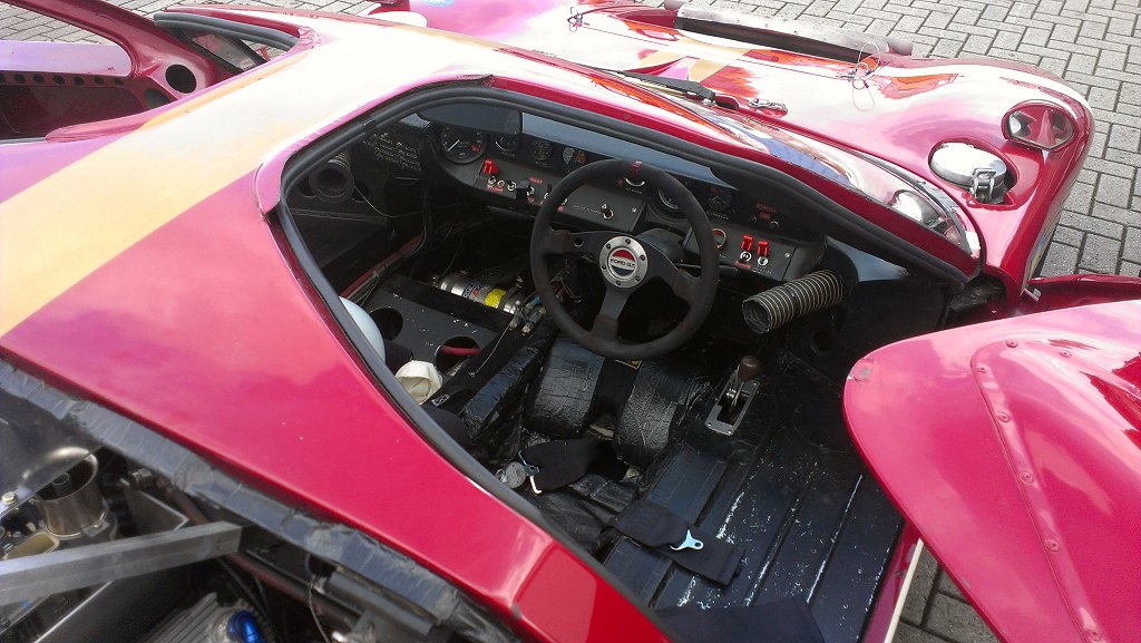

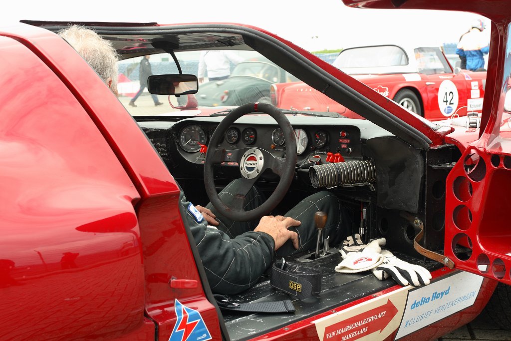

Don't know about this particular car. I was told by the owner that this is the ex-Alan Mann Racing GT40 number 1. He has owned the car since 1981 and is still racing the car in Europe.
John

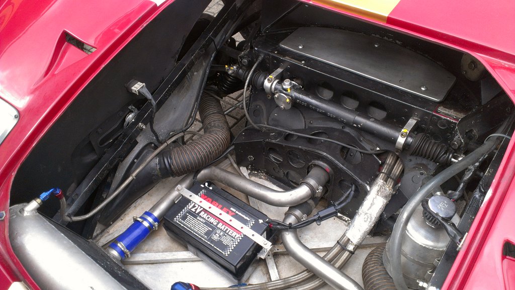

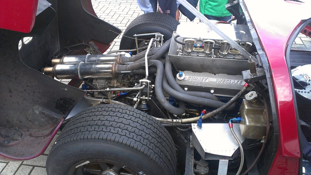

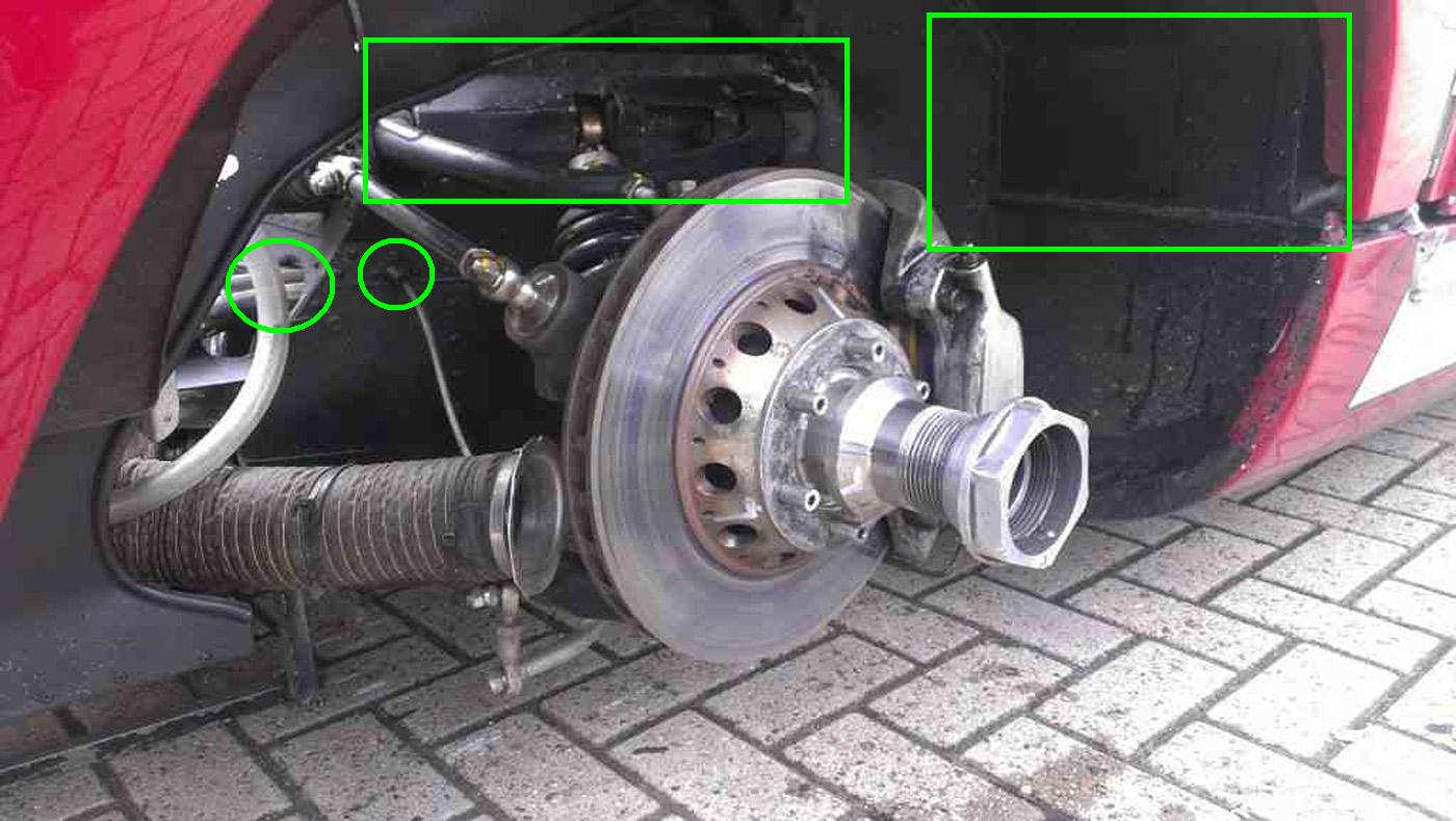

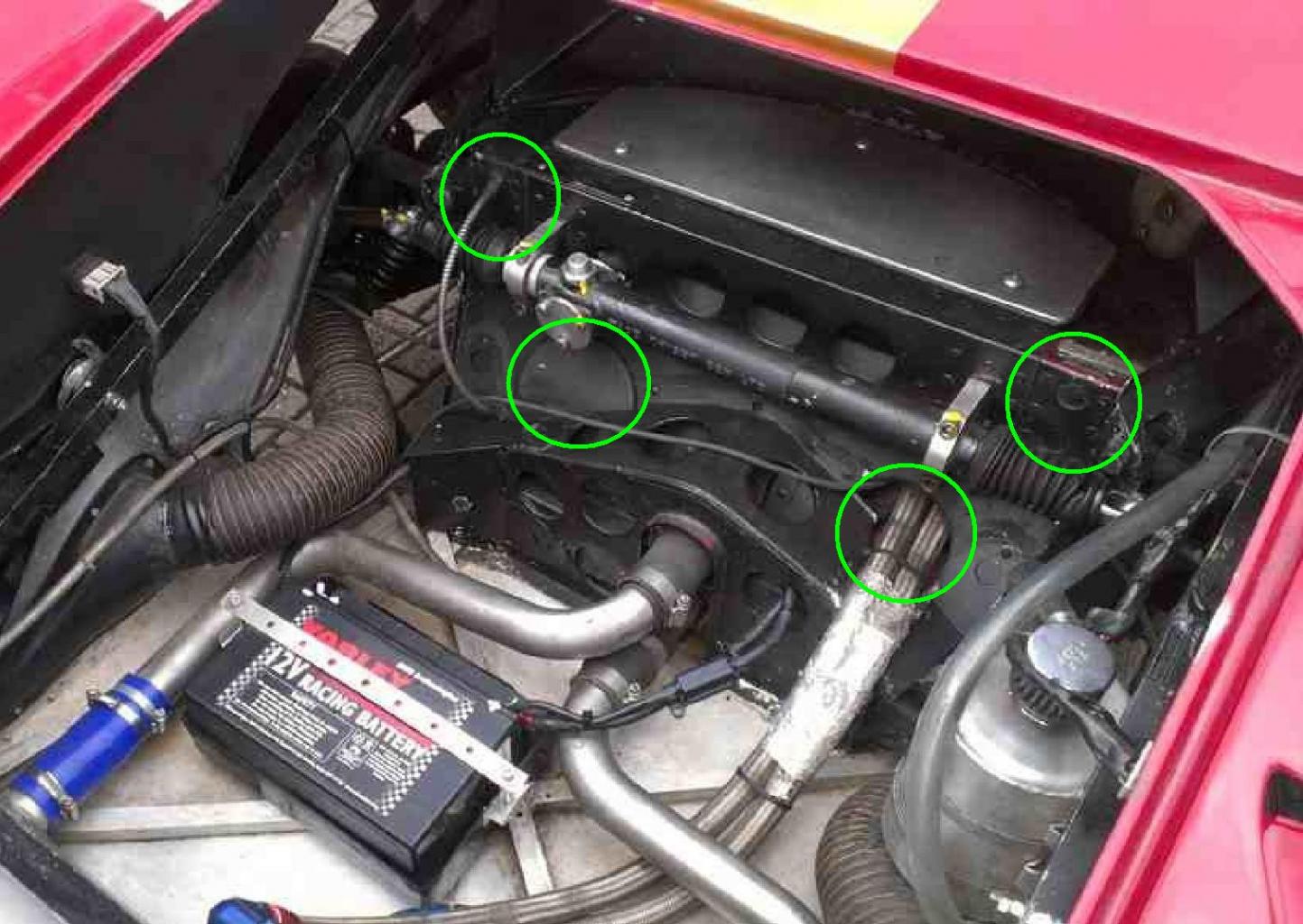

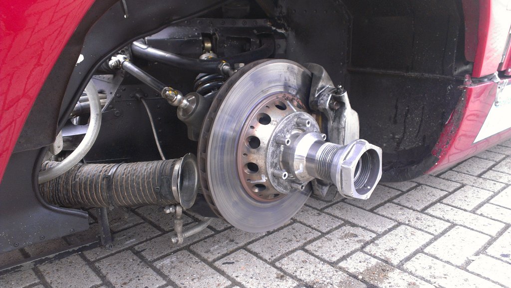

We did have a look under the front bonnet this afternoon and it has what looked to me the original chassis plate stating GT40 P 1023 and another plate from Alan Mann stating number 1. Unfortunately I do not have a picture that shows the chassis plate or plate from Alan Mann, but a friend took some pictures with his mobile phone.
John

The Grand Sports are not SPFs, the first street production cars are just coming off the line now, the comp cars are build by Duntov Motorsports rather than at Port Elizabeth.
The GT40 does not have some of the SPF features, the steering rack is different and some other small details make it something other than a Superformance. I hear there there was some outfit called Ford/FAV that built some of these a while back......................
Last year the owner was black flagged at this circuit for noise regulations, so he had to do something about that this year. So he had this exhaust fitted.
Nope. These are two continuation cars build and numbered with permission from GM by the person who has the rights for Europe. The road versions will be done by Superformance and have nothing to do with these racers.
John
These two racers were built in The Netherlands by Tachyon.

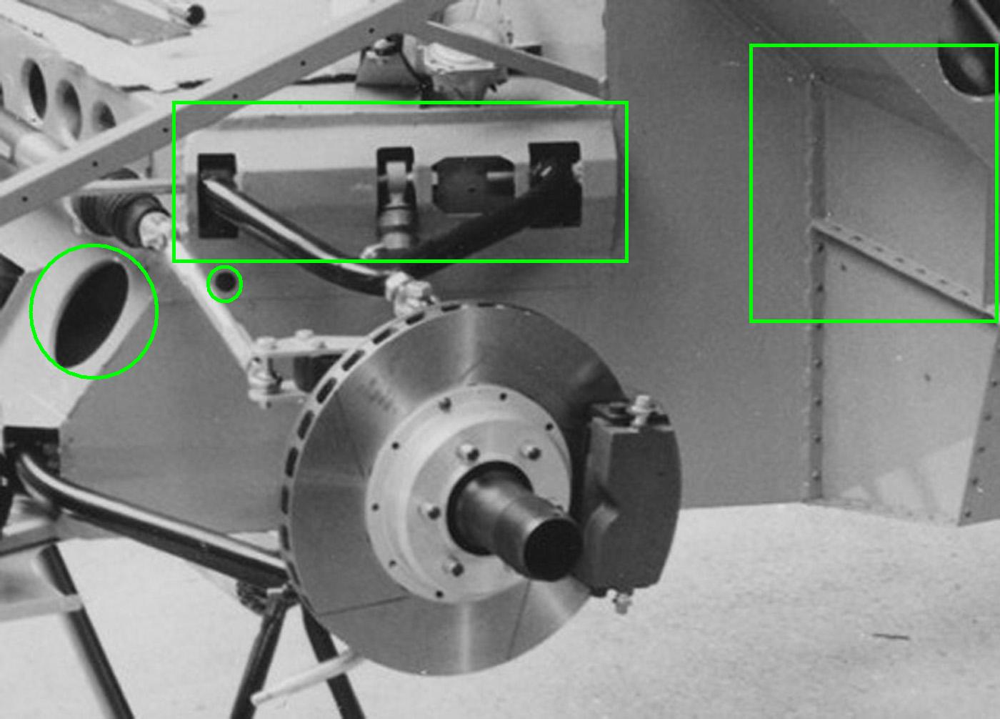

And so while we wait to find out if it is indeed 1023 which is heading for the Netherlands Historics or the Sbarro fake “1023”, let’s switch attention to Mr.Stummeyer’s red and gold car.
And as none of you will be surprised to learn, it has absolutely hee-haw to do with Alan Mann’s lightweight AM GT-1. You may find this hard to believe, but similarly to how Pierre Bos has laughably modified his Sbarro fake “1040” to try to incorporate some of the correct details which I have been pointing out for years that his car was totally devoid of (none of the modifications, by the way, having been done anything like correctly, so what was the damn point???), Georg Stummeyer’s “AM GT-1”, which he claims to have owned since 1981, is a Mark V which he in fact bought in 1993, not 1981, which has had modifications carried out to try to tart it up and fool people into actually believing it is a Ford GT40. It is not Alan Mann’s lightweight AM GT-1. It is a feebly-modified mark V.
How long have I known it was a mark V? About 3 hours!
I had long known Stummeyer to have been involved with two Mark Vs, but though I also knew absolutely that whatever the car he was claiming as AM GT-1 was nothing of the kind, I did not know until today, thanks to John’s photos, that underneath the façade of Stummeyer’s fatuous claims to AM GT-1 was still the Mark V he was racing beforehand! [I have to cover myself at this point and say that for all I know it could, though extremely unlikely, be a different Mark V, but Mark V it is.] I have found loads of photos on the Internet of the car, but very few have shown the chassis even to the slightest extent, and even those few photos have been posted at far too small a size to be able to see anything that helped. I even saw the car race at the Nurburgring OGP in 2009, and I never got the chance to see any details. I did get to see it race, and by God he races it well. It looked and sounded fantastic. But I knew it wasn’t AM GT-1. AM GT-1 has been owned by Rex Myers since 1982, and should very soon be emerging from restoration by Racing Icons, who were responsible for the outstanding restoration of Mark IIB GT40 P/1047, which put in an appearance at the Le Mans Classic on its way home to Japan. Wish I could have been there to see it!

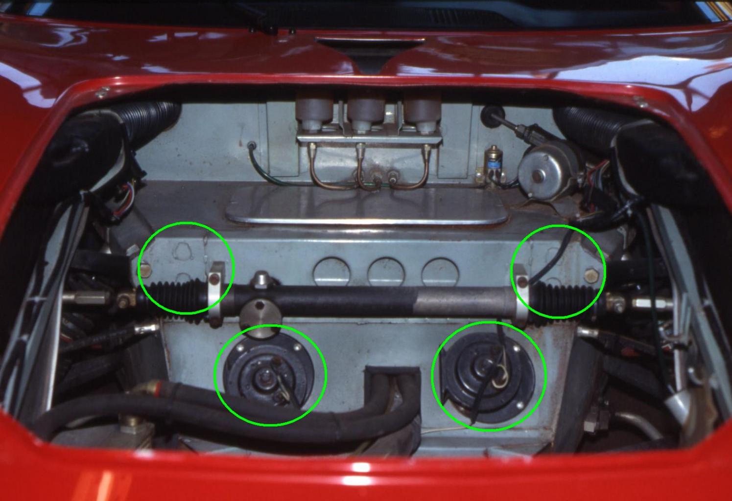

Anyway, now, however, thanks to John’s photos, I know the truth, which hopefully the following few photos will illustrate well enough. I’m using John’s photo of the front of the chassis followed by a photo of the first Mark V, GT40 P/1090, then John’s photo of the left front suspension followed by a photo of one of the early Mark Vs. In each pair of photos I have circled (or “rectangled”) just the main Mark V elements visible.
It astonishes me that he can think that by adding roughly GT40-type front structure, and by adding exceedingly inaccurate pseudo-genuine-GT40 curved structure and side panels up in front of the screen, that he turn his car from a Mark V into a Mark I. I consider this kind of crap to be extremely insulting!
Between his ridiculous fiddling around on his fake AM GT-1, the similar farfing of Pierre Bos on his fake 1040, last year’s appearance at Nurburgring of a fake 1029, the fake 1041 (also, I think, a mark V), the fake 111 allegedly rebuilt as a coupe in white and blue…….etc., etc!
When is all this crap ever going to stop?
Answers on a postcard please……

Original or not, it was great watching the car in action and in the dry it really flew past all the others, including the Corvette Grand Sport with 550 hp+.

I'm supprised that I have not noticed this before, the MarkV tubs are very plain, and simplified compared to the Original tubs or even the SPF tubs.
Rick Muck- Mark IV
GT40s Sponsor
And the MK V uprights front and rear are nothing like the FAV units. If you have ever been around a MK V (and I have, P1116) it is very easy to distiguish from an Abbey/Tennant tub.
Sad that despite having a grreat car in the MK V, people must still boost their egos/wallets with a load of crap.
