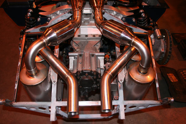

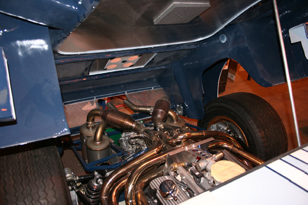

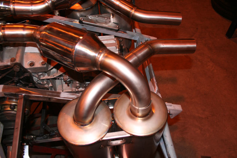

John, attached are a few pictures of how we have set up the exhaust system with cats in my car. The wxhaust boxes have been placed in the area where the luggage carriers were located in the MK11. It is hoped as well as meeting IVA requirements that it will enable entry at some of the quieter trackdays. Time will tell as I am just waiting for the EFI to be mapped so we can get accurate emission readings and noise levels. Also need to look at heat shielding for the cats which has not been done yet.
Dave
