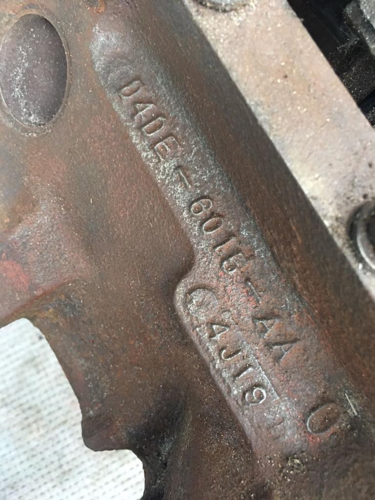

That's a wealth of information cheers for that I had looked most of that up just wasn't sure what to expect that kind or year to put out emissions wise yours is also a lot easier to read than the flow chart in the IVA manual
The 78 I was looking at is d8ve first four I'm guessing V is mk2 mustang
Casting/Manufacturing date code: 6 B 10
6 = 1966 (Note: You will need to identify the decade via part number on the component first)
B = February
10 = 10th day of the month
First Character = Year within decade (i.e.: 0 – 9)
Second Character = MONTH (see below)

Thank you that's great ,are the date codes with the part numbers on a pad near the starter mounting at the back of the block?
Regards Mark
Regards Mark
Hi Mark,
They are near the starter number think they are on their own, lay on my back under the car to read them.
Mick at Southern GT for the appropriate fee can sort you out an official dating certificate for IVA purposes.
p.s. Mine where not that easy to read, I spent some time trying to figure out what one letter was until I realised it was just a casting anomaly.

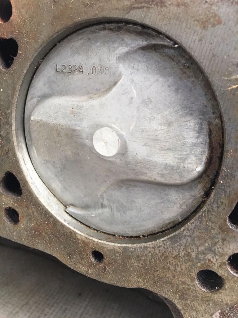

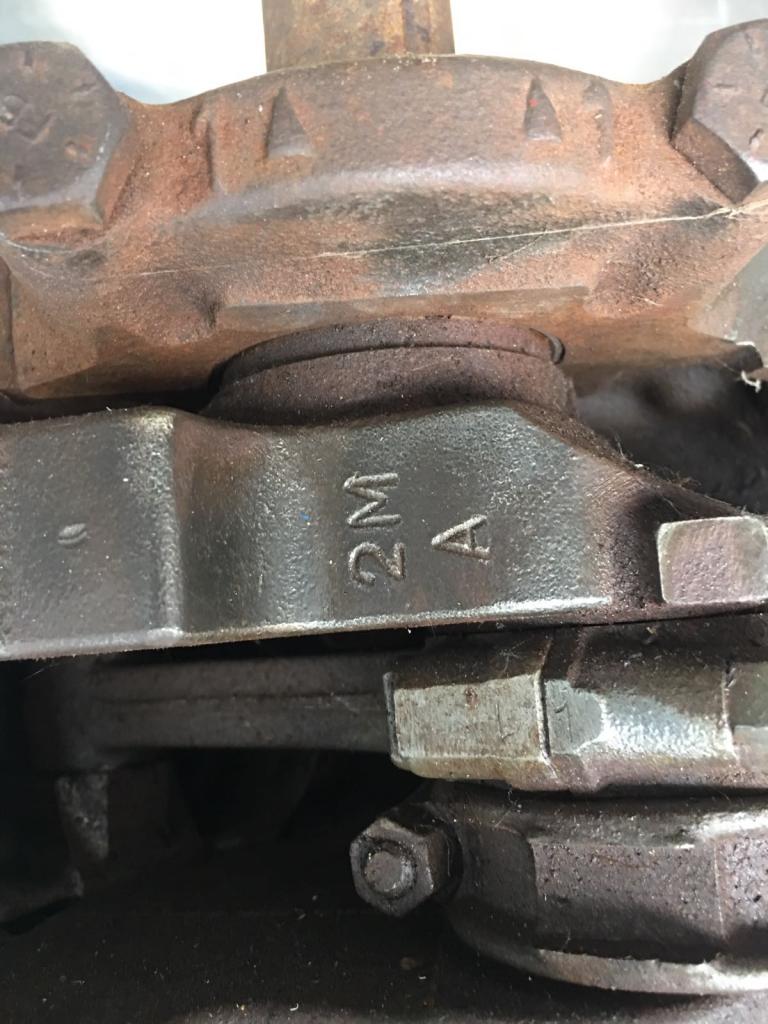

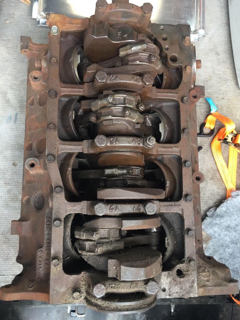

Ok guys been to collect body and all sorts from southern gt and also motor no 2 ,anybody she'd any light on the crank and pistons

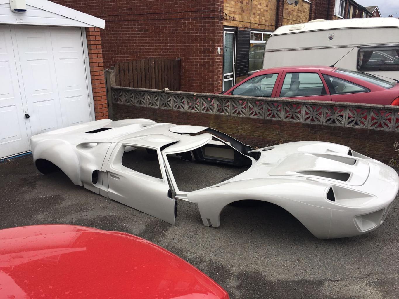

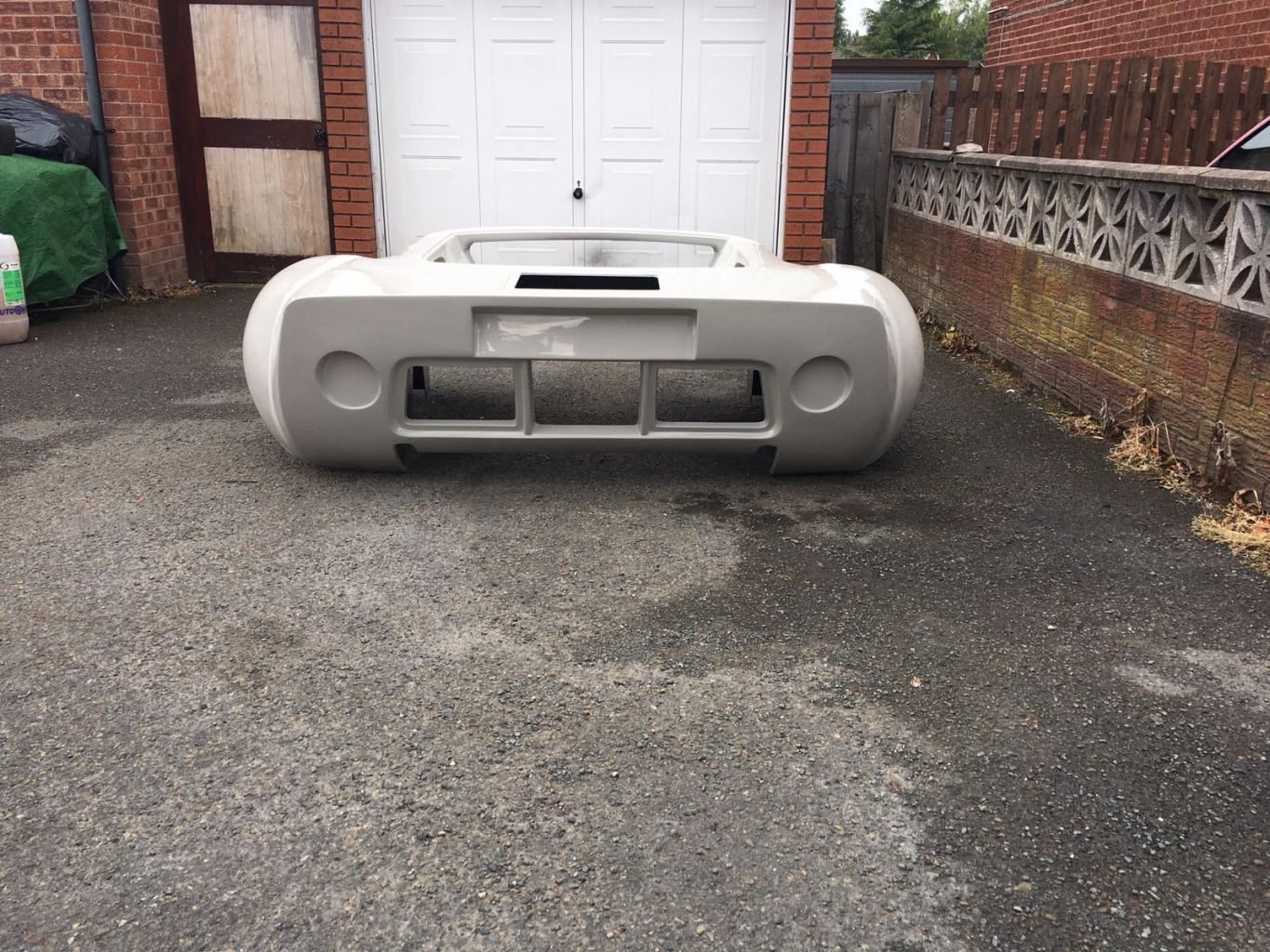

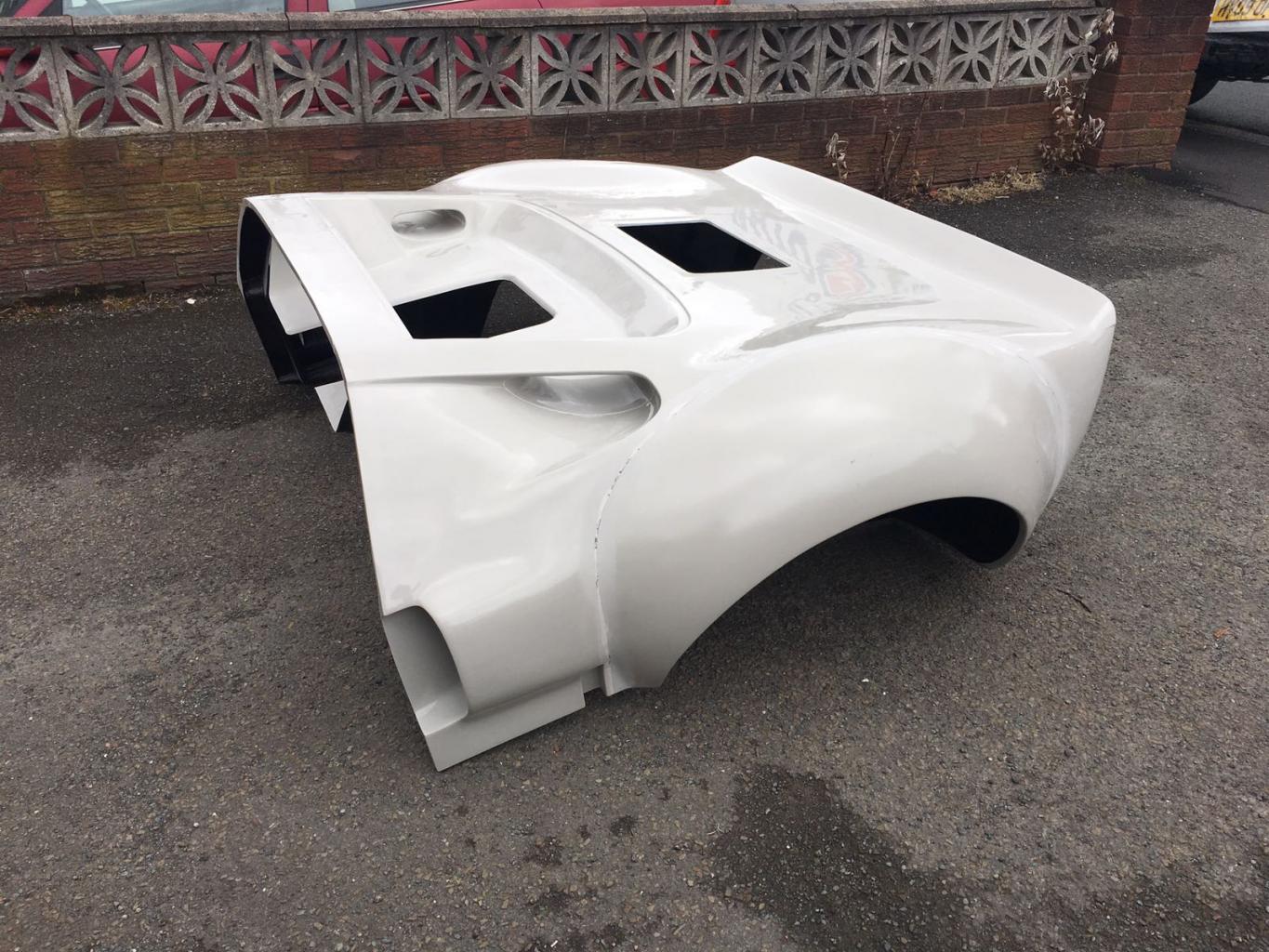

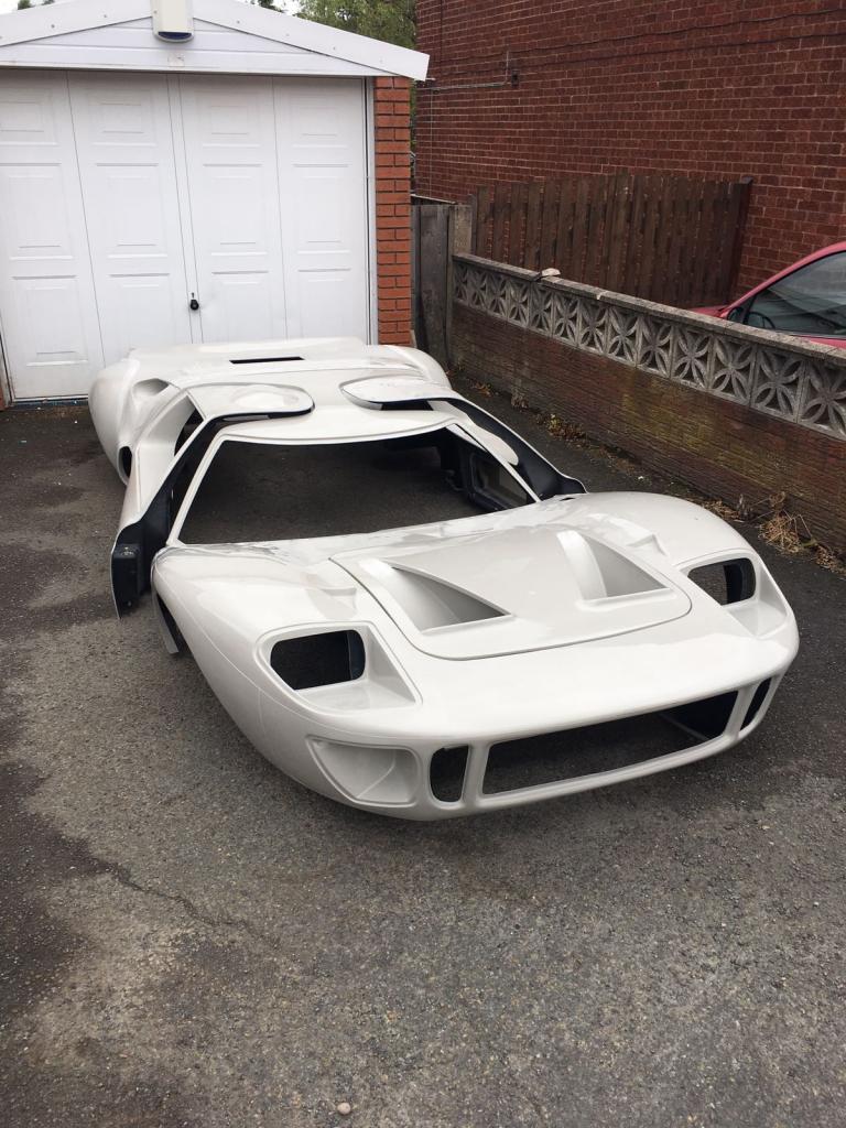

Body looks cool ,and seems very good quality, very pleased
Pistons are for boss 302 heads, crank is 302 cast iron, will depend on rod length ( should be 289/B302 5.155" long ) and whether you wish to build boss style engine as exh ports/bolt pattern will require one of headers for GT40 application. Block would require extra coolant passages drilled to work with boss heads.
BTW IIRC those pistons have a history of cracked skirts in service so check carefully.
It's from southern gt but I am pretty sure it one of lee dawson,s ,it looks pretty good to be honest, I have built 6 Cobra,s and seen a lot of fiber glass body's and this one looks like it's been built by someone who knows what he is doing ,he also fitted the bubble and wider wheel arches ,if you want any more pics just give me a shout or call around if your ever passing ,will have to start a build thread one day.
