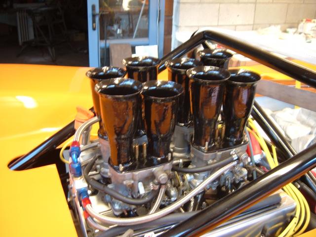

For my little bit of input, I am running a 3.5 ltr Rover in my Mclaren replica and whilst I will not be racing it, it is a track car only so will get a fair bit of stick. The 4 twin choke 40mm Del Orto`s came straight off 2 Alfa 33`s and sat in the box waiting 5 years to breath. All I did was clean them up, check them out for jet size which as standard Alfa, turned out correct for a starting point and ran the things. They were a little rich ? (black plugs) and I had balanced them before running some 30 laps. Tomorrow the car gets dyno`d so we will see how far out they are. The car was very driveable even though I had one choke slide in upside down so that was probaly the rich part. The motor has got the highest cam that you can run with hydrolic lifters plus all the good bolts etc.
