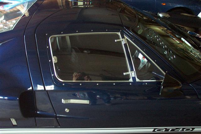

Hi Simon,
Perhaps you could have a look at the MKIII window option that DRB (GT40 Australia) offers. In essence, it is a f/glass frame that supports a fixed "quarter window" at the front, & a hinged main window - hinged at the front, with a "flip-over latch" at the back. This lets you have the back of the window opened up about 90mm - heaps of air flow. But the really nice bit is that you can just lift off the latch, & then swing the window out and lift it right off.
I survived one summer in Oz with both windows out (before I got the A/C working) - a life saver !!
The attached pics might give you a bit of an idea - if you would like better ones, just let me know.

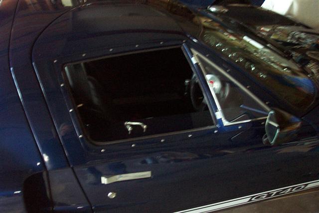

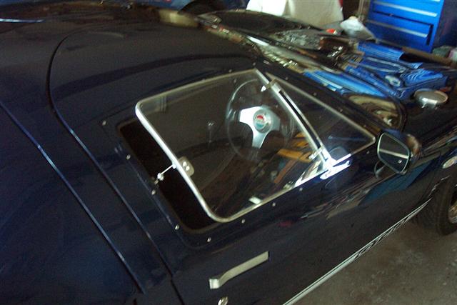

Hi Howard,
Pics of side windows attached :
Kind Regards,
Peter D.

Thanks Peter, I think I could come up with a homemade version using a standard lexan side window. How about making a drivers side with a large hole much like the original swing out small one. Then use a set of front hinges like yours and a single small screw and nut at the rear.
This would be something that could be retro fitted on existing side windows but just enlarging the hole.
Thanks again for the pictures.
