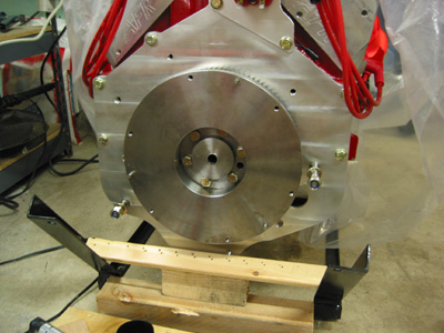

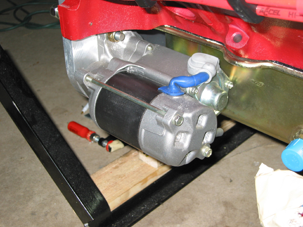

I think this would work if I could find a starter that is both shallow and small in the girth around pinion area. I've got a spare hitachi-style chevy starter (pictured below) and if I use the starter head block as a sacrifical peice I can get the pinion head of that into fairly tight spaces, but even then I'm going to have to scallop the dry sump oil pan significantly (also pictured - don't be fooled by the negative image - the extra width is on the starter side unfortunately).
You guys that have done this before - is that what you did?
Thanks for your help,
Cheers, Andrew

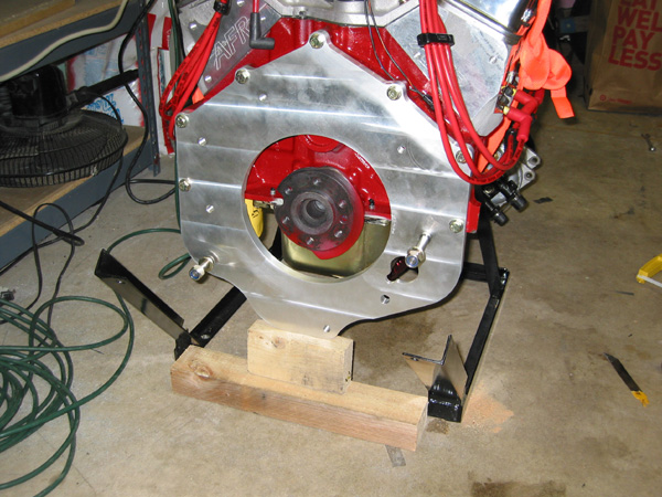

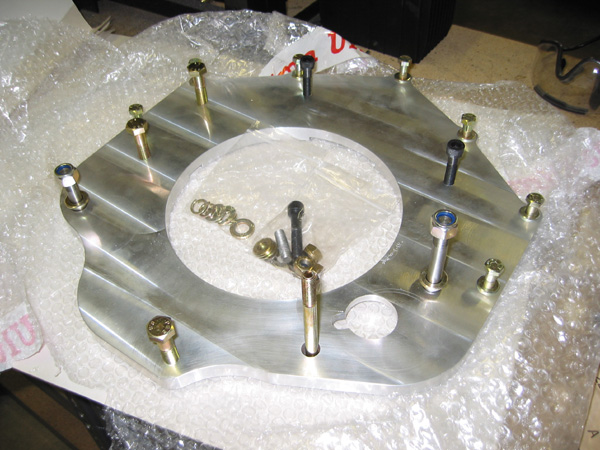

Hi Andrew, Hope these pics mite give you some ideas
Hi Andrew, I have the same problem with a 930 / LS3 engine in my race car. The starter is in the way of the lower suspension arms. I will ask Chris (Flatchat) if he could design a similar adaptor for the 930 / LS to solve this problem. The above adaptor is for the G96 getrag / SBC.
