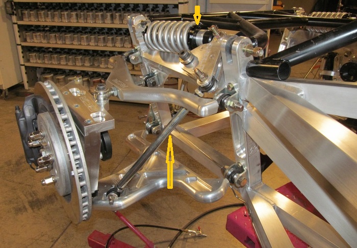

Hey guys here's my question (see picture-arrows), I'm used to adjusting ride height by the turn shock collars. The coupe has an adjustable strut bar also connected to the bottom of the shock bell. Can someone explain the differences in adjusting one or the other, caveats and/or purpose of that strut bar having adjustment. All my other rides have had more conventional set-ups.
Thx, Mike

IMO, loosten the strut bar locknut, adjust the shock collars, tighten the strut bar nut. All the strut does is provide a linkage to the shock pivot.
One of the joys of a push rod suspension is you can adjust the ride height with out upsetting shock and spring settings, merely by adjusting the length of the pushrod.
john

Thanks Michel - nice description on a fairly technical matter. I've now goggled push rod suspensions - it sounds like corner weighting is an integral part of setting up it correctly. I'm frugal and like to learn and do my own stuff - rather not pay somebody hundreds of dollars and get lackluster results anyway.
Here's my dilemma: to get the ride height close on the rear end, left to right, the driver side shock collar/adjuster is fairly compressed compared to the passenger side. I haven't touched the push rods yet but they are quite close in adjustment (threads showing) left side to right side. Anybody else finding the same circumstance. BTW I'm measuring the ride height off frame points not the fiberglass body or skirts and use 12"x12" floor tiles to level all four tires.

I noticed the same observation on my rear suspension as well Mike. I'm just not at the point of dealing with it yet.
According to page 26 in the SLC Build Manual, adjust the push rod first. With the suspension in full droop, adjust the push rod length so it is about 1mm from touching the upper A-arm. Also ensure that the left vs right push rods are the same length.
Then adjust the coil-overs to get achieve proper ride height.
