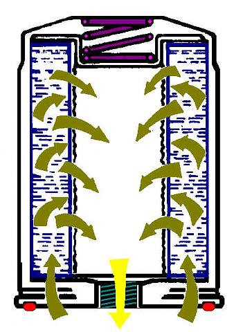

The flow of oil in a filter should be from the outside to the inside. You'll probably have to see which port on the adaptor goes where by blowing through it, etc.
