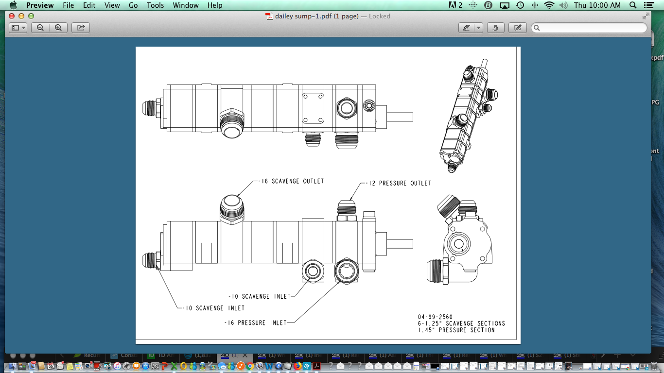

That actually helps alot! My dry sump actually has 5 fittings!
  • dailey sump.pdf
Steve, my pump doesn't have any scavenge inlets. My guess is that my pan has all of the scavenge lines CNC'd into the pan and that the layout of the SBC requires external hoses. Are there two -10 fittings on the pan?

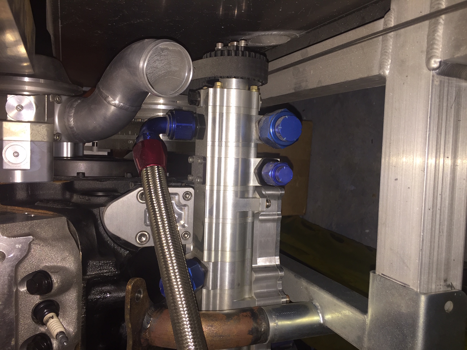

Here's a picture of what I have
Scott
Steve, I saw that picture in the PDF you attached, It only shows the pump and not the pan. The scavenge inlets have to pull the oil from somewhere. That's either the pan or the engine. I assume the former. Look at the pan for two -10 outlets. Based on the orientation of the inlets, one is likely at the rear and the other on the side opposite to the pump.

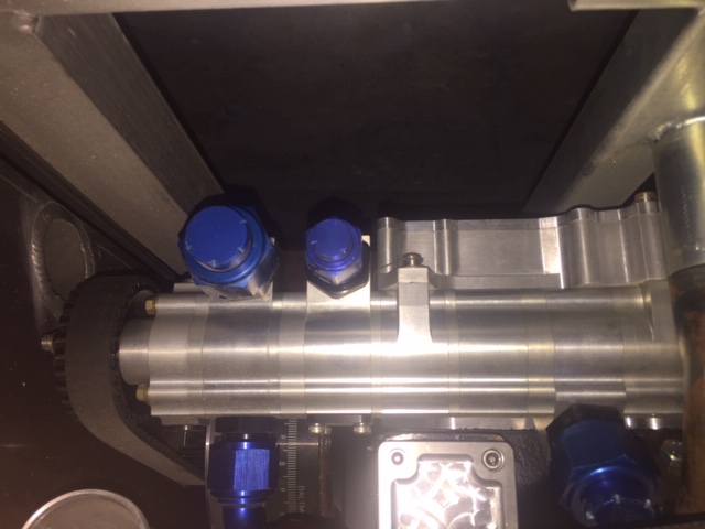

My pump is integrated into my pan. I have a couple pictures of the side. I can try and get some shots from underneath too
Scott
Steve, all of the Daily pans that I have seen have the pump integrated into the pan. If you can’t find two -10 sized outlets in the pan send Bill an email or give him a call. He quickly answered all of my questions.
Hi Scott, I ended up writing him. He sent me a diagram for plumbing the pump. I still have questions, but he didn't really seem willing to help beyond the diagram. I'll do as much as I can and then get some pictures and post them on the forum. I'm sure someone can help. Thank you for reaching out!
