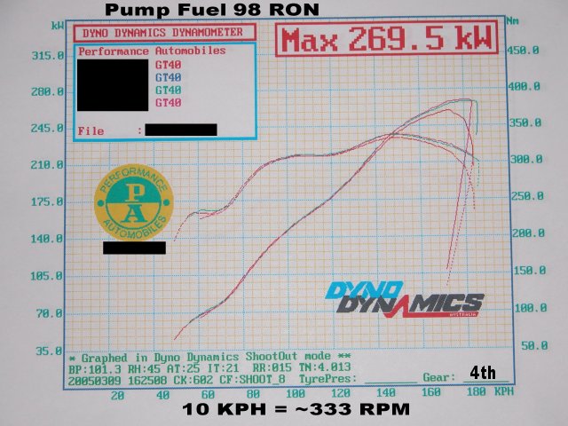

We did a base run on the car today. It made 269.5 KW (361.4 BHP) at the wheels. Hopefully a dynosheet will be attached.
It is an extremely tractable and flexible engine.
The figures are a bit short of what it should produce but I'm pretty happy for the moment. Hey it's only 42 KW short of what my little four cylinder produces. /ubbthreads/images/graemlins/wink.gif

Here's the dyno sheet for the GT (I hope)

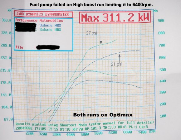

And here's that little four cylinder I was talking about. /ubbthreads/images/graemlins/wink.gif
Not too bad at all four wheels considering the fuel pump failure.
The engine is expected to run 35 PSI boost when finished.

What was the V8 supposed to be making at the crank? 364hp would be around 420ish hp at the crank. What are the specifications? Thanks much,

It was supposed to make 500 BHP at FW. It apparently made close to that on the engine builders dyno' but it had a different induction setup on it.
I think I'm at the limit of the throttle bodies and/or manifold that are on it.
It's not too big a deal if I want to get the power up as there are a couple of options I can try.
Another problem is that due to a misunderstanding between myself and the engine builder the car has a hydraulic roller cam which is limiting the rev's somewhat.
It's not quite the fire breather I wanted but it's extremely pleasant to drive, wonderfully tractable/flexible. At the moment I'm in two minds as to whether to change it or not. It really is a gem of a thing to drive ATM.
It's a bit more road car than race car ATM and I suppose that's not such a bad thing. It has meant that I'm less inclined to take it racing than I felt initially but it's still a very fast road car.
It has RF's Koni suspension in it at the moment and although soft is much more comfortable than I imagined it would be.
I think we can gain some in the tuning but we won't find it all.
I'm aware that being a Dyno Dynamics dyno' it reads lower than you in the US are used to (Dynojet?) so I don't know how it would compare on one of those.
As it is both engine and chassis are a delight to drive and I'm reluctant to change it into a more cantankerous harsher beast.
Basic spec's are 302 based aluminium block 364, forged internals, ported AFR heads, dry sump, 8 stack Motec injection.
Tim.

361.4 RWHP is pretty damn good specially on Dynamics (We do have them here in the US). My understanding is that you can add another 15% to that number for Dynojet. So about 415 RWHP for Dynojet.
You should have no problem doing 11s in 1/4 mile (assuming nothing breaks /ubbthreads/images/graemlins/grin.gif)

I'm pretty happy with the result for the moment.
As I said, the engine is an extremely good natured animal. /ubbthreads/images/graemlins/smile.gif
I didn't do any special dyno' preparation so the car had cat's, socks and mufflers fitted. No tuning was done, it was just a base run.

Modern hydraulic roller lifters are fine to 7000 rpm or more so running your engine to a higher limit should not be a problem unless the valvespring/cam grind spec is too mild; I notice on your dynoplot that the power curve appears to have peaked. Perhaps swapping the cam for one with a bit more lift and duration (but still an h/r) would give you the extra rev range you want?

I think the throttle bodies/manifold are limiting top end.
The engine builder doesn't seem to think I should push the engine any higher with this cam anyway so it seems that if I want to get more out of it it's going to mean changing all three items (and associated hardware). /ubbthreads/images/graemlins/frown.gif
