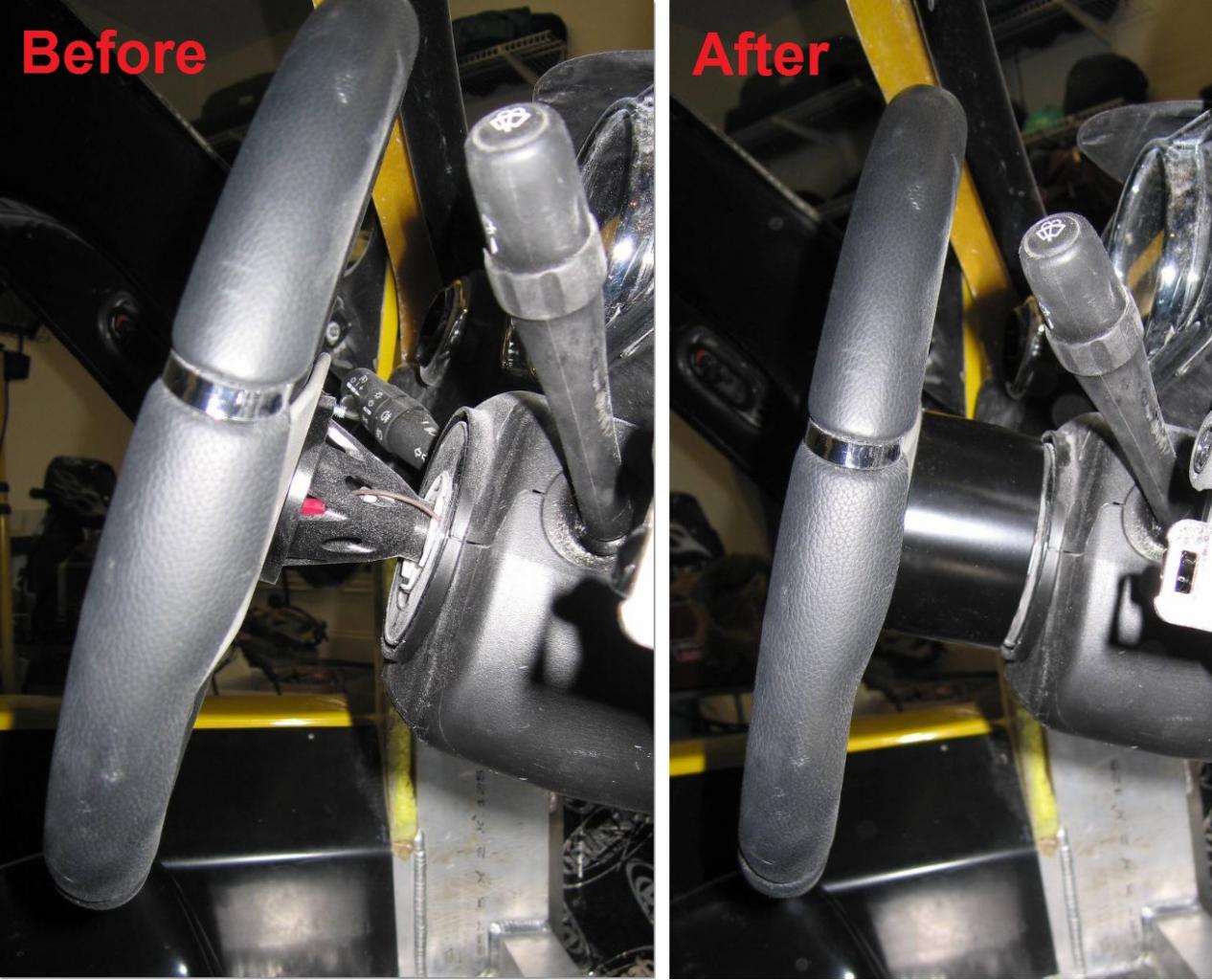

I used the Pfadt C6 steering wheel adapter to mount my Momo wheel. It works fine, but the adapter is a little ugly.
I had some 4" pipe left from fabricating my exhaust, and that was the perfect size for a cover. Just weld a flange on the end to fit the 6 hole steering wheel mount, shoot a little paint and Vualla...a cover.

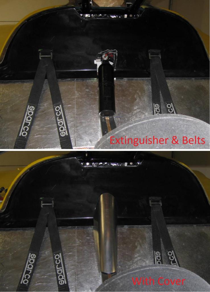

Here's a shot of my waterfall panel. I mounted a fire extinguisher between the seats, and then hid it with a cover that align with the center console. The cover is mounted with Velcro so it can be removed quickly if there is an emergency:flameon:
I decided to go with a 3 point safety harness. That allows a bit more shoulder movement to look over my left shoulder in traffic, and it cleans up the firewall as well. The harness is wrapped around the rollbar behind the firewall panel.

Bill, another quality job of fabricating the fire extinguisher cover; :thumbsup: however, the fire extinguisher appears to be a plastic valve model. With all of the first class quality work that you have done on your car, I'm a little surprised that you wouldn't have gone with a quality metal valve fire extinguisher on something as important as fire protection.
Because you have a cover and the extinguisher gauge is not readily visible, I would suggest adding a visual inspection of the fire extinguisher to your maintenance check list. :idea:
Even though I have given up on my project, I love following your blog and all of the innovative ideas you've incorporated into your build!
Jim
Hmmm, this is the first I've heard of that concern.
What's wrong with a plastic valve?
Bill, plastic valve portable fire extinguishers are notorious for leaking. The next time you are board and want to amuse your self, go down to your local home improvement store and peak into the boxes of the brand new plastic valve fire extinguishers sitting on the shelf and count how many gauges actually indicate within the “Green Operating Range”. I'm fairly confident that you find a disproportionate number of “leakers”.
These are brand new units never put into service. Imagine the number of problems when one of these units has seen service in a hot bouncing, vibrating car or boat.
Additionally, there have been numerous incidents of operators and service technicians be injured. For this reason many fire extinguisher service companies in the U.S refuse to service/recharge plastic valve portable fire extinguishers.
Here is a link the the Consumer Product Safety Commission Kiddie recall notice:
Kidde Recalls to Replace Fire Extinguishers Due to Failure to Operate | CPSC.gov
Although Kiddie is probably the largest manufacture of plastic valve fire extinguishers, American LaFrance, BECO, First Alert and others have had problems.
St. Clair Shores, MI - Official Website - Product Recall Information
Personally, I would opt for a quality metal valve extinguisher.
Hope this was helpful.
Jim
This is a Kiddie ABC extinguisher. I had this unit in my last hot rod, so its 3-4 years old now and still well within the green zone.
Guess I was lucky and didn't get a leaker.

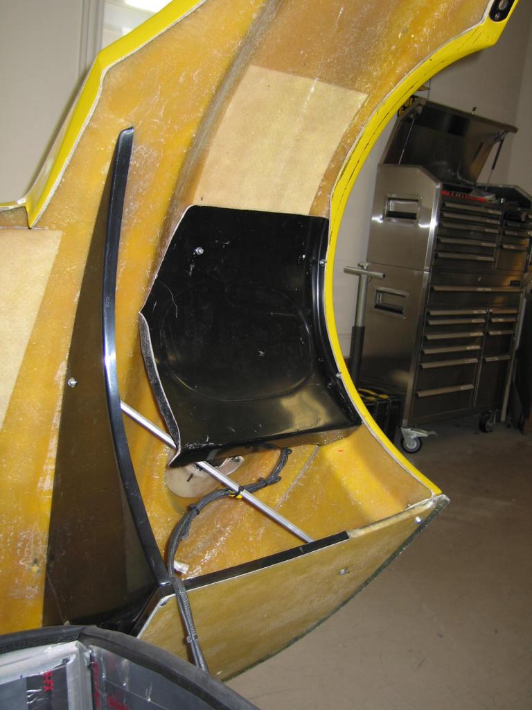

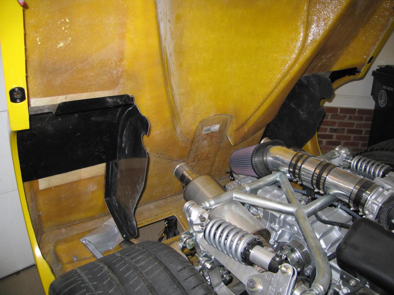

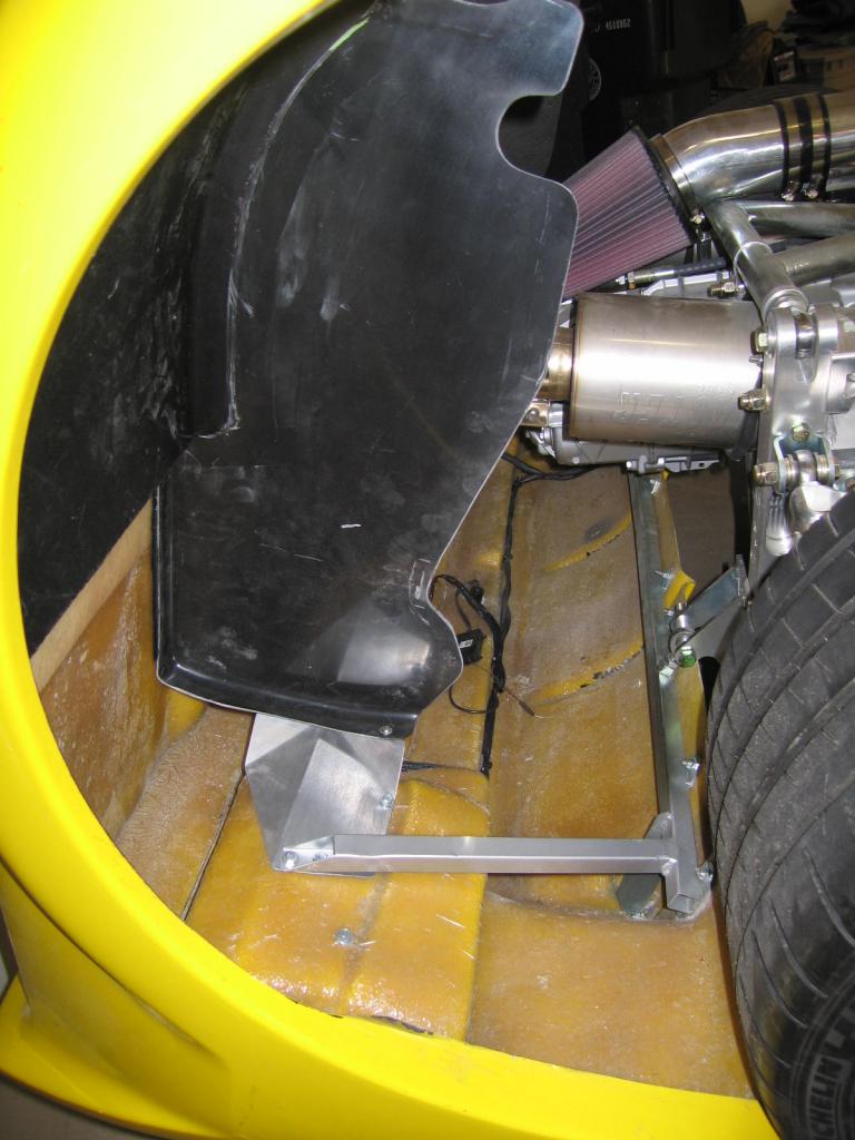

Sorry I haven't posted in a while, but I've been heads-down in the garage making progress on my SLC. One of the things I recently completed was the inner wheel wells.
Rear wheel wells: The rear wheel wells come in 2 pieces, a flat backer and and curved barrel section that goes over the wheel.
  1. Start with the curved barrel section: Trim the outer lip to fit the body and then bond it to where it contacts the body. I applied 3M 8115 panel adhesive to the lip and the top of the curved barrel section. I applied a liberal amount of adhesive to the top to spread out the load. Overall, I used just about 1 and 1/8 tubes of the 3M 8115 adhesive, so buy 2 tubes.
  2. Then bond the flat backer piece: The flat backer is made to fit the track tail. I have a street tail so the flat backer needs to be trimmed to fit the contour of the front curved barrel piece. The lower edge also needs to be trimmed to fit around the upper A-arm and shock cantilever. Then I used the same 3M 8115 adhesive to bond the backer to the inner lip of the curved barrel section and to the underside of the tail. The lower rear corner of the backer is unsupported, so a bracket is needed there. I made my bracket wider just to block the sight-line when looking from the rear grill thru to the wheel well.
The inner wheel wells add some strength to the tail clam. I also welded uprights to tail's existing steel structure for additional strength. The tail is much stiffer now and the reduced flex means you can open the tail from just one side now.
Front wheel wells: I did not have the front inner wheel wells, so I cut a section from the rear wheel wells and repurposed them in the front. They are mounted via threaded click-bond fasteners so the can be easily removed.

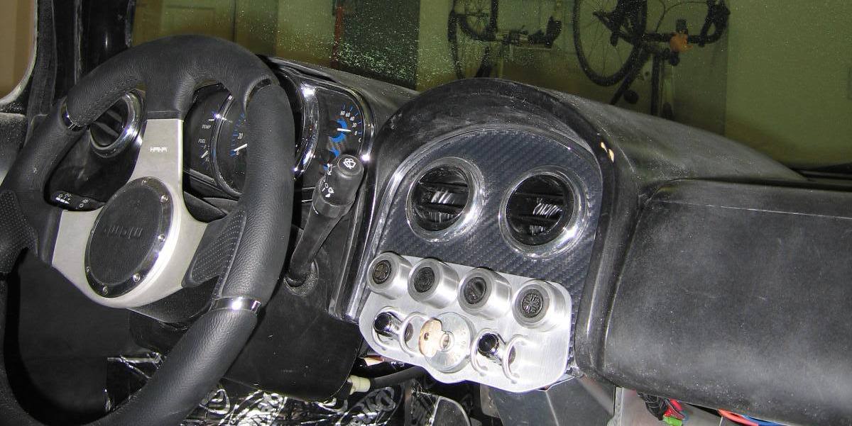

I finished the center dash panel. Along the way I did 23 drawings/mock-ups before I refined it down to something I was satisfied with. Yea, you could say I over-thought it :bigcry:
I completely cut the center section out and replaced it with a 1/8" aluminum structural panel. I then covered the panel with 3M Carbon Fiber Di-Noc and trimmed the perimeter with 1/4" Aluminum extrusion from Clayton Machine Works. The HVAC vents are from Billet Specialties. I swapped to the same Billet Specialties vents in the dash's outboard pods as well, so all 4 vents match.
The controls are all mounted on a separate brushed aluminum panel below.
  • The panel is made with hidden mounting tabs. so it easily slides out for maintenance.
  • The toggle switches have billet handles with blank onix tips, as well as aircraft style switch guards.
  • I decided to go with an ignition switch vs start button. This is because the ISIS system draws 0.3Amps when sleeping and will kill the battery within a week or so. The ignition switch is from a 1997 Miata and is part of a matched key set, so the doors lock with the same key. Here is a video on how to make the Miata doors lock.

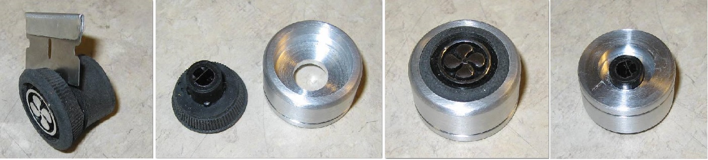

  • The HVAC control knobs that come with most aftermarket AC units are pretty ugly. So I machined some decorative knobs that go around them. Once part of the rubber is cut back, the original knob is bonded to the machined aluminum.
