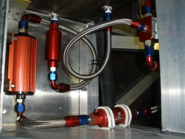

I copied the fuel system on Fran's mule before the car was delivered, but the Aeromotive 1000 is really meant for 1000HP, i've got half that. Some local engine builders say they see these causing vapor lock in 5-600hp mustanges. The fuel is going around in a returnless loop, getting hot in the Texas sun. I've noticed Fran has downsized a little too. His has a fuel cell, mine doesn't. Aeromotive makes a pump controller to avoid vapor lock. i may end up adding it.
My neighbor asked if i was trying to disguise a meth lab in the car, he said the plumbing looks highly suspect!

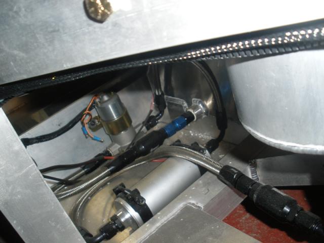

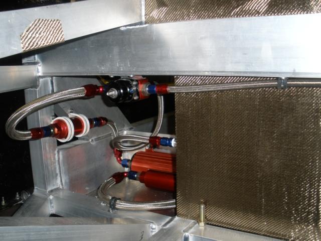

Not as cool as Tim’s fuel system but came out ok. I like the way the regulator is set so you can see the pressure gauge and still adjust. Plus the AN 6 exits the regulator under the 2” x8” firewall support away from the belts. I used the Aeromotive isolation boots, $25, and threaded them into the crossmember support. I’m not big on mounting to the underside of the chassis, just worried about a rock taking the fastners out. What do you think?

Don't think you'd want a fuel cell - who wants to have to replace the bladder every few years. Blah!
Btw, ideally the pump should be mounted lower than the tank - is that possible in the SLC, or is that the lowest you're going to get?
Hey Cam, did you tank come with everything cut&welded in - i.e., fuel out, return, sender, and fuel vent?
Yah, that's tha lowest i can get it and still tighten the bolts! The fuel pump inlet is about level with the npt fitting outta the tank.
I still have to vent the tank and thinkin about bringing it over to the filler neck. Is that about the best place to vent?
Those Holley pumps will lift fuel a long way. I know they say to put it lower than the tank, but try it out with a bucket of water in your garage. I did, those Holleys will easy lift 7 ft and soak the garage doing it.
Cam, I think the position of your pump is okay. I plan on running my vent almost directly upward from the tank fitting to the top of the bulkhead and using a screened S.S. marine vent fitting.
