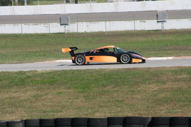

Here is the stance of the car at just over 150mph on the straight. It was crazy how stable the car was. I wasn't even over 6000rpms in 4th!

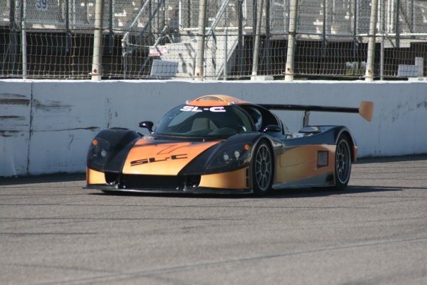

This is hard on the brakes coming into a tight turn onto the NASCAR oval.

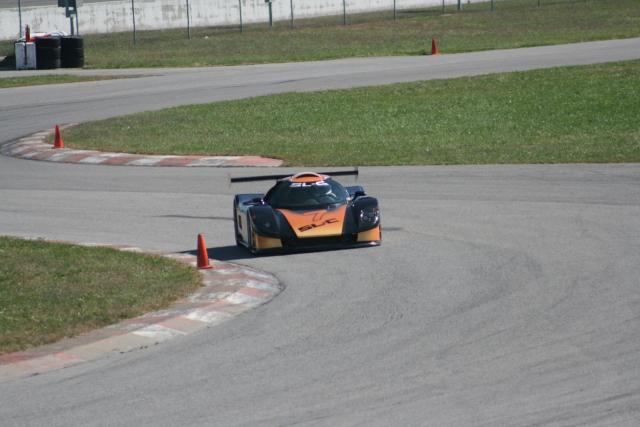

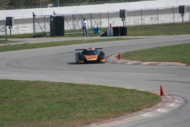

This is a fast chicane. The car is rail flat and really feels smooth and solid as the weight was transferred left to right.

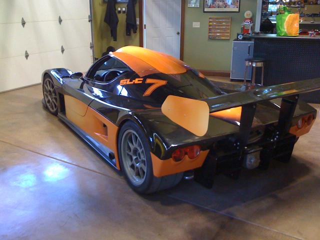

Dean, You mention the adjustment on the bars. My car is not adjustable at the front and I am just about done with the rear. The rear will be adjustable. can you add so information on the anti roll bar configuration on the car. Pictures would be very welcome.
Also tell us more about the updated suspension package as well as the aero updates. How about so good pictures of the rear of the car with the raised wing.
Howard Jones
Dean, You mention the adjustment on the bars. My car is not adjustable at the front and I am just about done with the rear. The rear will be adjustable. Can you add some information on the anti roll bar configuration on the car. Pictures would be very welcome.
Also tell us more about the updated suspension package as well as the aero updates. How about some good pictures of the rear of the car with the raised wing.
Howard, Fran has the car in Detroit so pictures are limited. I will see what I have. The bars are adjustable by drilling more mounting holes in the arms to allow you to make the bar stiffer. The bars should still be set in the neutral position, meaning that when the car is on flat ground, there is no tension on the bars. The suspension upgrades are what the current cars are using. This car had some old stuff that Fran wanted to replace before the event. At least that is what I understand to be the case. It is no different than the current models.

Hey, I know you were testing the NEW wing and some under belly pans for the car. So what do you think?
Actually I think I like the old wing better than the High wing on the track car..
What do you guys think?
The higher wing, moving it forward just a bit, coupled with the fender vents and
ducting of the splitter would move the center of effort towards the middle of the car and should result in better balance at very high speeds. I will likely not be driving at
race speeds as mine is a street car, however, I do like the higher wing position.
Perhaps I'll play with some end plate shapes on my SL-C too.
