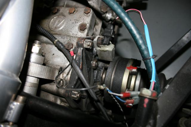

Grady, all of them including the one from Utah (speedhut) use any pulse input. I bought the triggering unit that screws onto the ZF transaxle speedo output and it leaked. So I sold it to Kirby so he can have leaks on his garage floor and made my own. All you need is a cam or crank trigger and put it by anything that rotates. I used the ends of my bolts for the CV to transaxle bolts. Here is a picture, excuse the road america track grime. :)

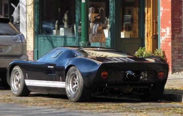

The pictures are here just for fun. The first one I took in downtown Coeur d'Alene, and the other one I took a couple weeks ago and they help lower my blood pressure after I have to think to hard about stuff like this.

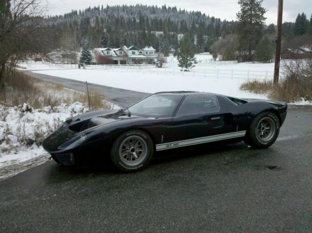

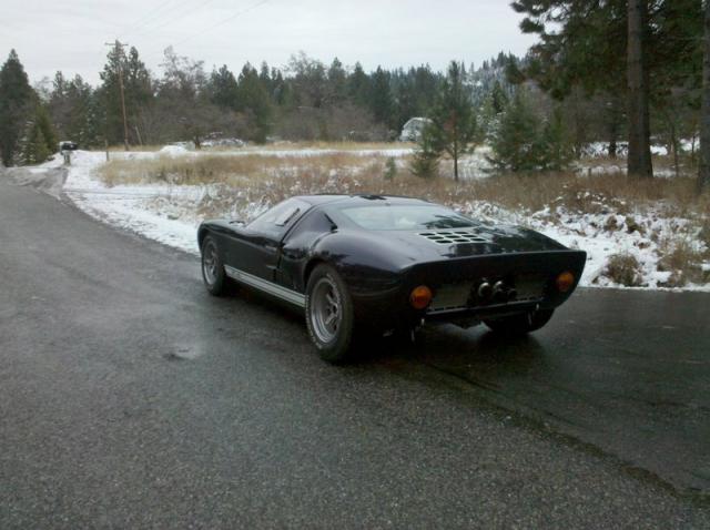

Jack at 6% sales tax I'm going to wait as long as possible. I did take it out for a short ride today, big mistake. Ice is not fun in a GT40. BTW not my house just where I happened to turn around. They have a nice driveway, I live on a goat path compared to this.
