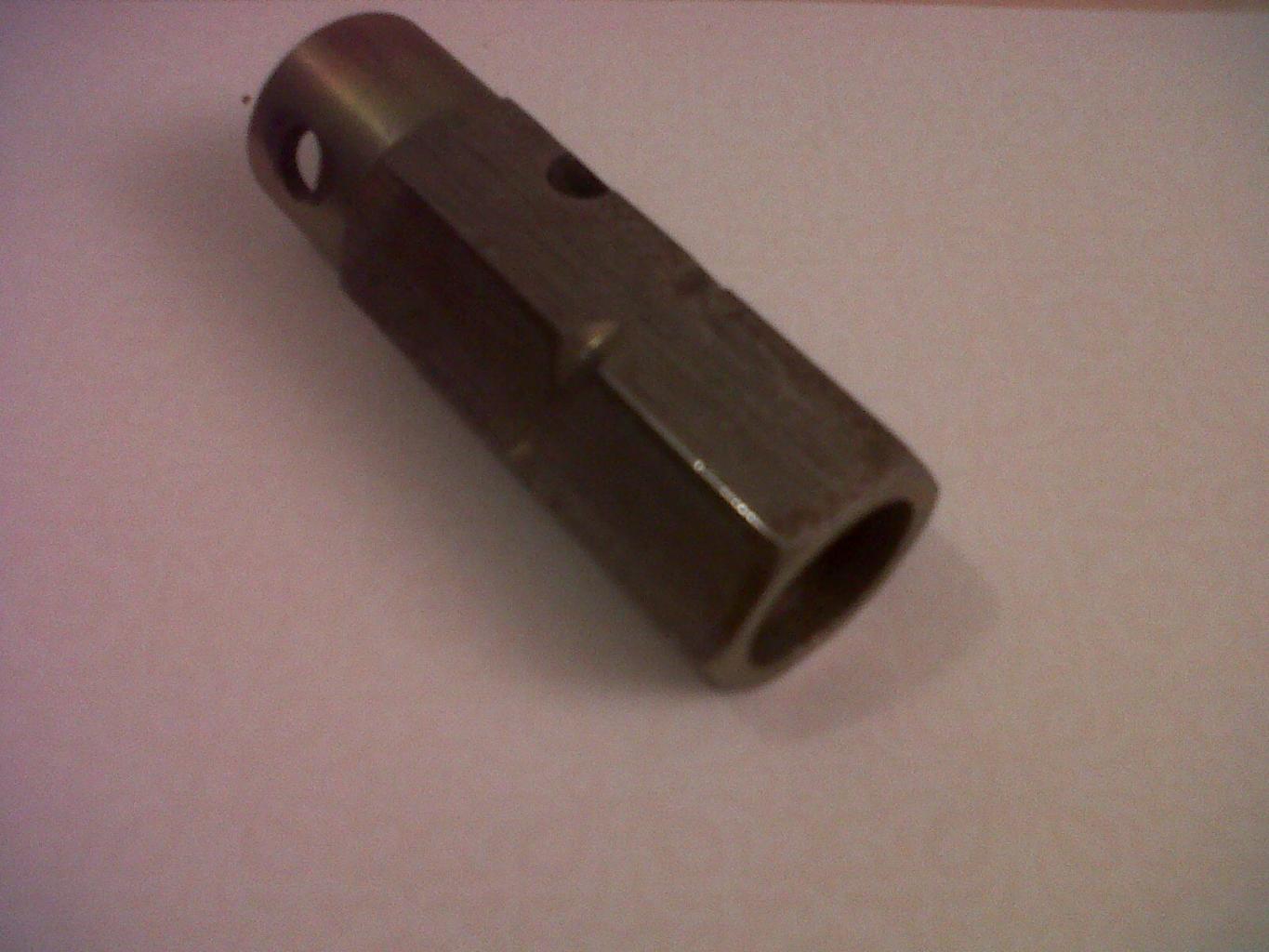

Just fitted a Corsa C EPAS column in the '40, the top of the column has a 22.5mm splined (male) shaft. I want to fit a steering wheel quick release sleeve to this. The sleeve I have has hex head (about 1.5" across the flats) that locates into the steering wheel, and has an internal hole diameter of about 20mm, that mated with the previous column. So I may have to get a new hex sleeve made to fit the steering wheel and mate with the column. I have a couple of options:-
1) get new sleeve made with a hole 22.5mm diameter (no splines) that simply slips over the shaft of the column and then roll pin (x2) that in place. Question, would roll pins be a good idea in this scenario? I'm worried about the roll pins gradually closing through time and failing.
2) do I go the whole hog and get new sleeve made with 22.5mm diameter internal splines that simply slips over the shaft of the column and then roll pit that in place?

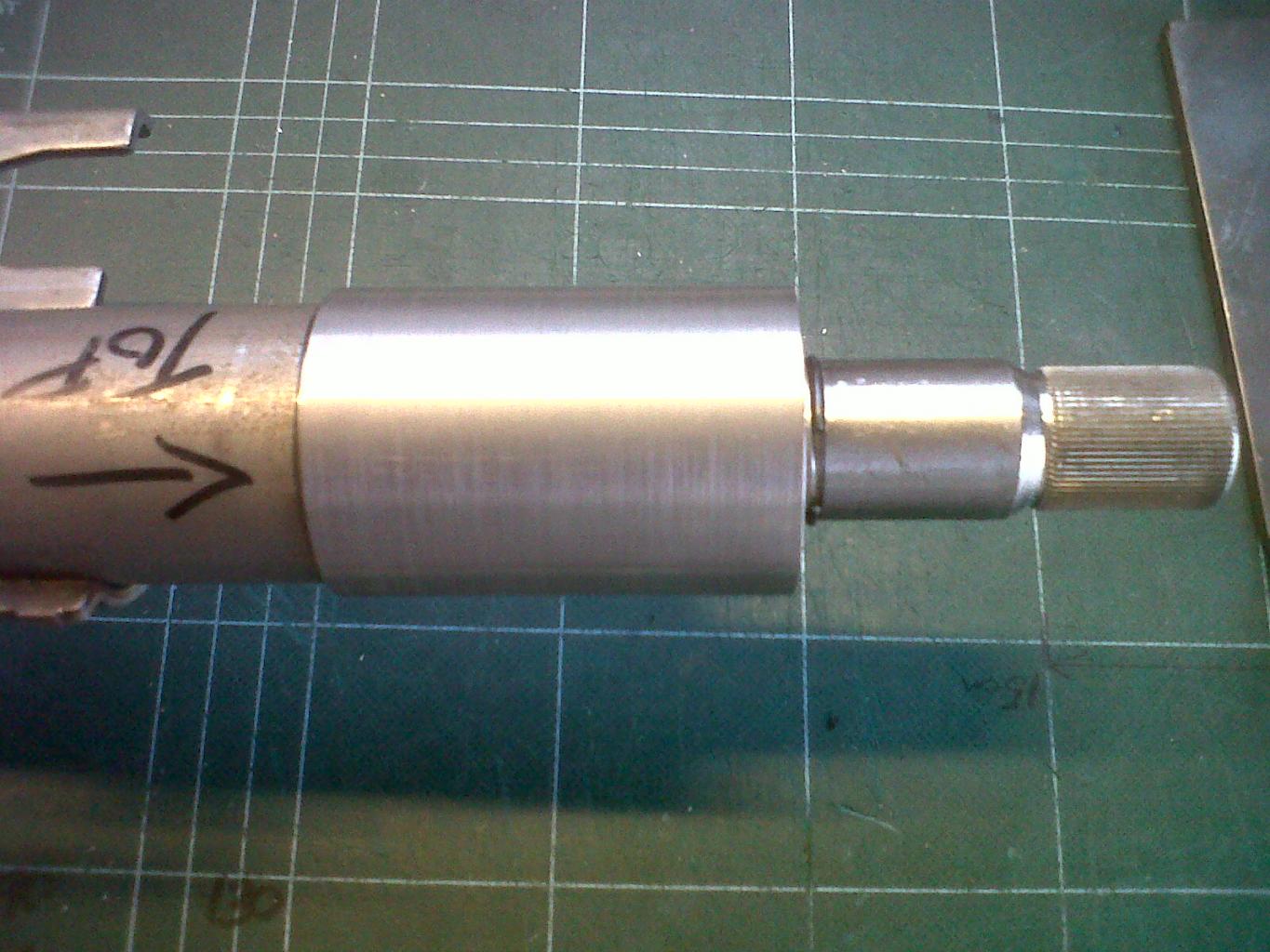

As ever a picture tells a thousand words so:
The motor (sorry its from the wrong end), you can just see the (white) plastic ring on the splined section.
Then on there goes this (taken before I pressed it together and welded it up).
And finally the shaft in place

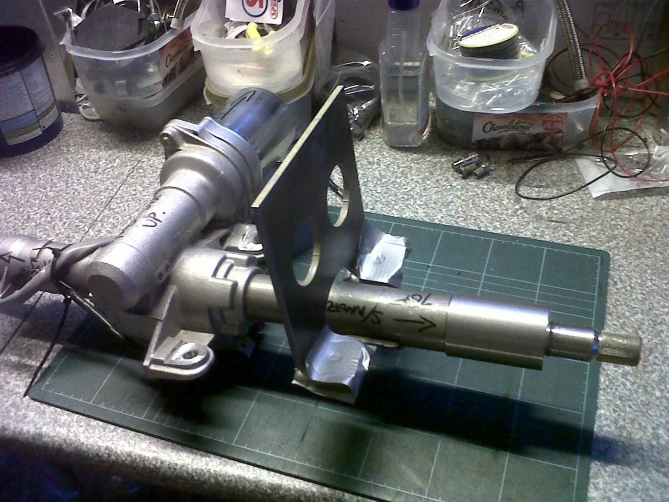

Thanks guys, not sure I understand it all, only 'cos I'm blinkered to this issue. The C column seems to be a bit different the, anyway in my case I wanted the top bracket (wings) so left them on, however I removed the plastic top part and the cast alloy bearing housing (with the steering lock) the plastic was moulded around, this meant I had to get a new bearing housing turned up, second pic.
So what I am left with is a 22.5 splined shaft end which needs to mate with one or other quick release (QR) sleeve.

Thanks David, I don't have a lathe, I get all my turning done in a workshop which has the advantage of professionals doing it, the disadvantage that any design iterations are time consuming.
Does the top part of the column (with the wings) just pull up and apart, is this the portion held in place with the plastic insert, which if it is, I now fully understand the above?
Would you advise against the use of pins, say roll pins to mate the QR hub to the top shaft?
I don't know the top column (with the wings) attaches on the 'C', on the 'B' it's bolted on but in the picture I found of the C it looks like slide in. It looks like there isn't quite the same setup on the 'C' and the end of the column should just slide off (with some encouragement).
I wouldn't just use roll pins, they're fine to prevent something from coming off but not suitable for this kind of application where they'll taking all of the steering force and will wear and break leaving you with no steering.

Thanks guys, I was/am reluctant to use roll pins, as I was worried that as the outer QR sleeve is not splined, the torqueing left/right would close the pin(s) and it/they would fail. I have no issue welding the sleeve on, the only issue is taking it off again to maintain or replae the column.
