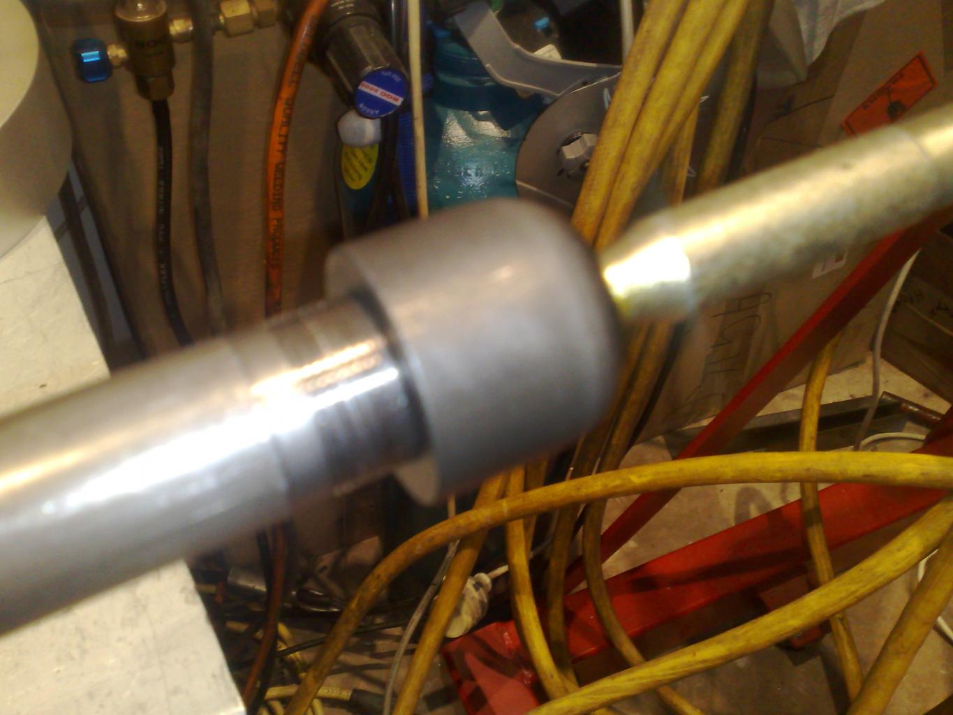

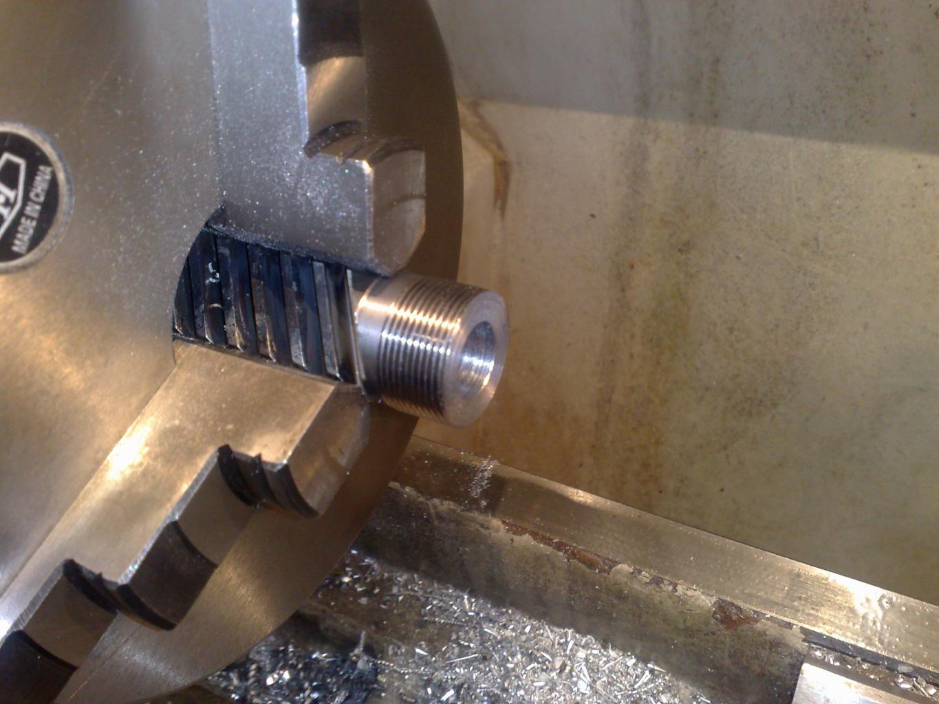

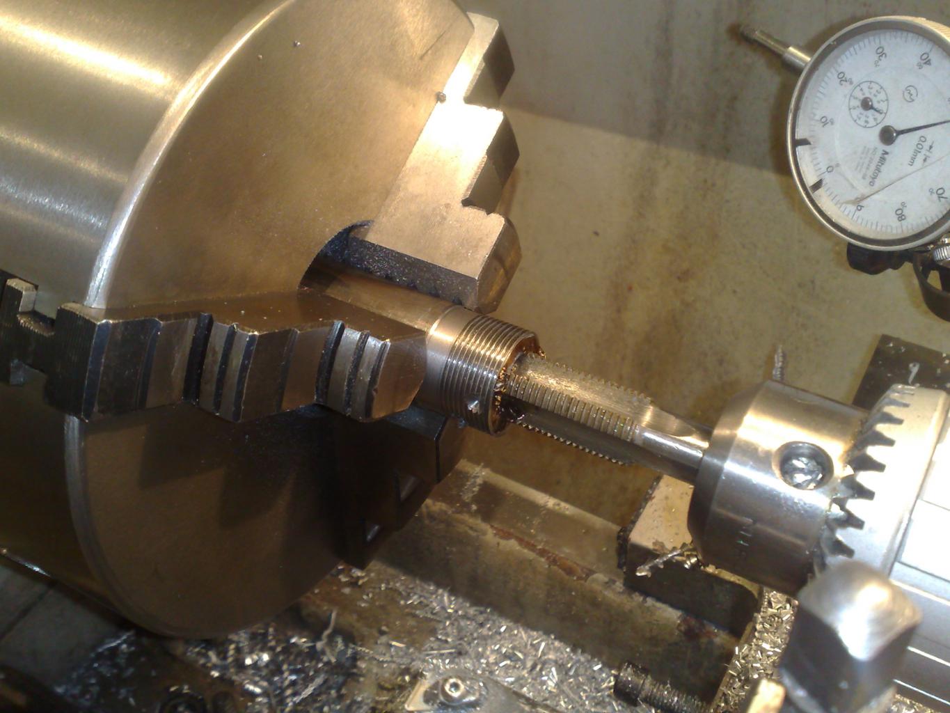

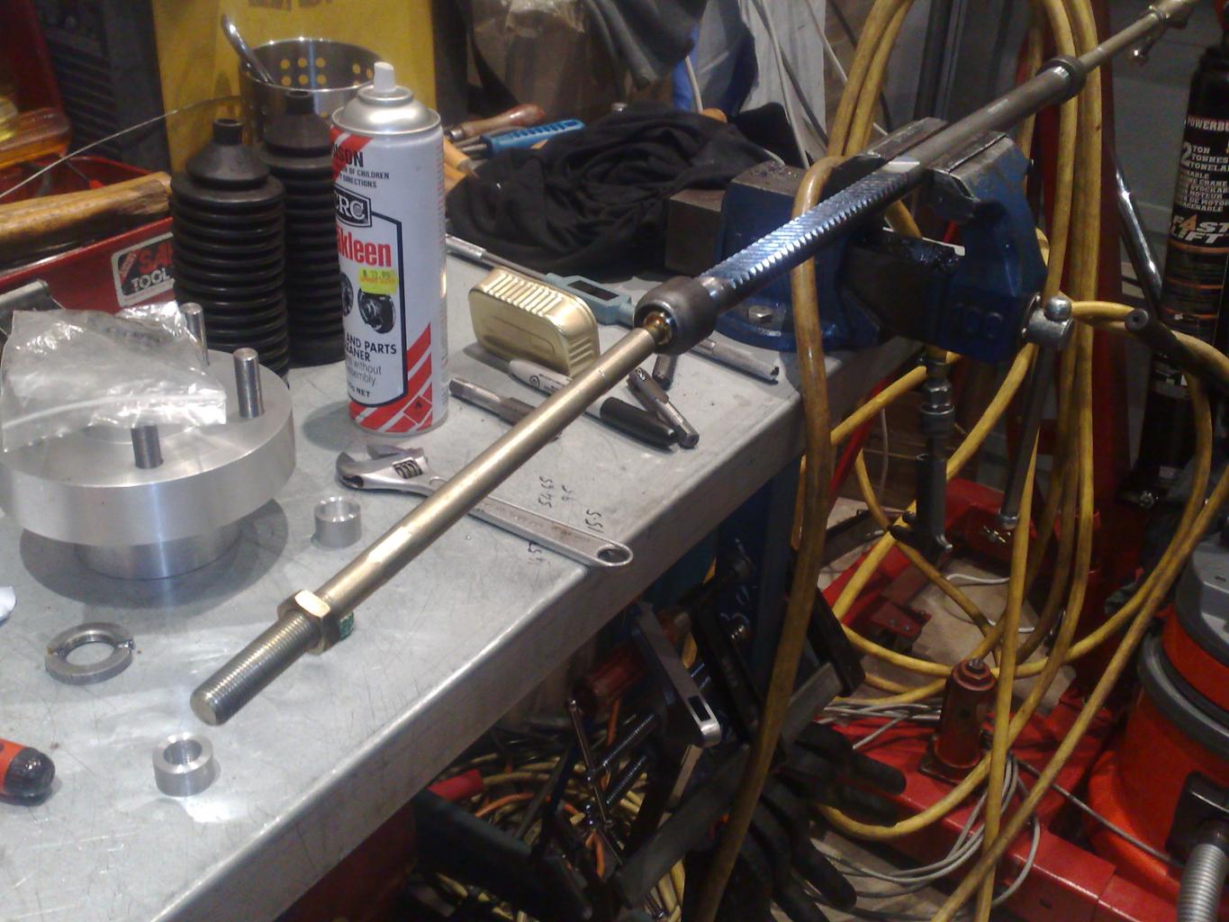

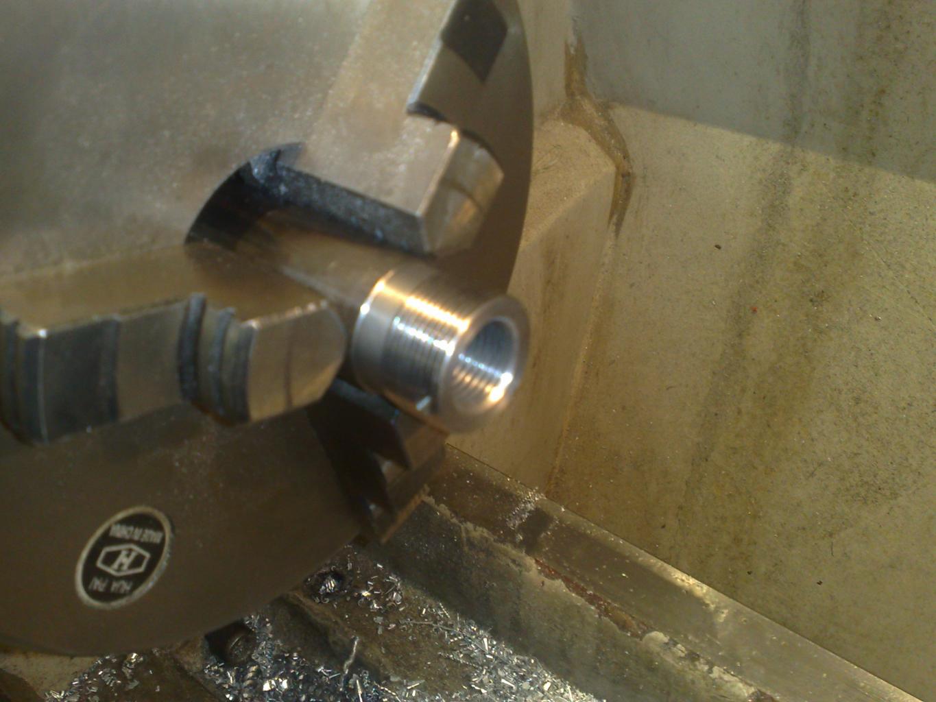

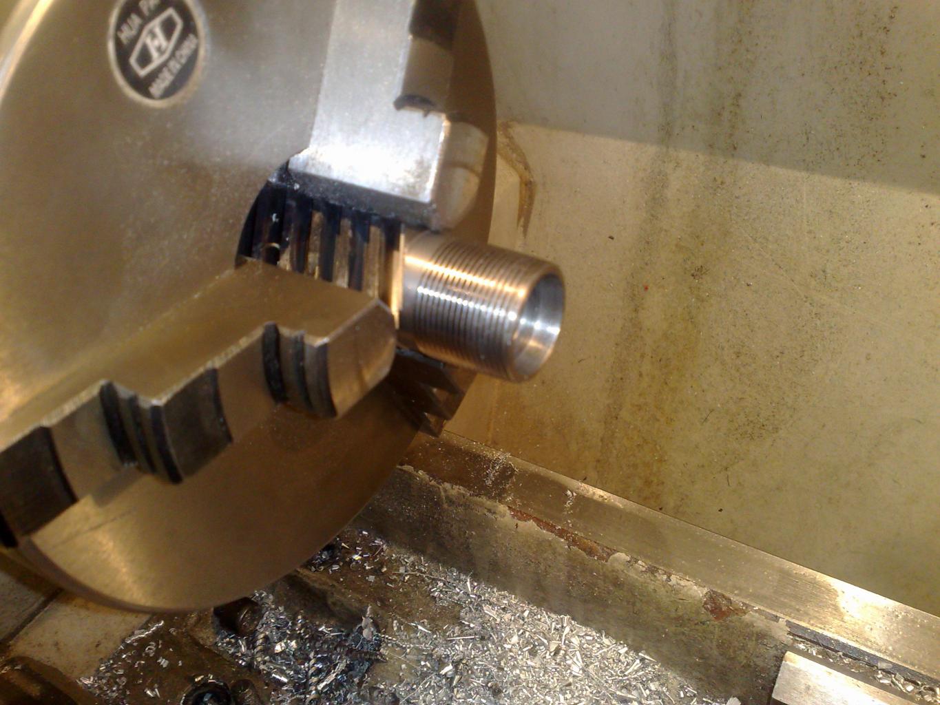

In case you were wondering about the mods I did, I have machined off the ends of the rack and drilled and tapped the rack for 16 X 1.5 mm Rack-ends as this seemd to be the most common size. I then used Ford Territory rackends and tie rod ends. The main reason for doing this was I was not keen on extensions to make the rack long enough.
The only thing ineed to do now is create a 7 degree taper in the arms I have.
I though about doing it in my mill-drill by holding it in the dividing offset by 3.5 degrees but cant get a full rotation so looks like I will mount it in the lathe by tacking it to a bit of round bar and boring it.
Since I am starting with unmachined arms I decided to put the tie rod ends in from the top of the arm which will let me move the rack up a little further and keep it out of the way of the pedals. Unfortunately i will have to go through the hassle of checking the bump steer etc.

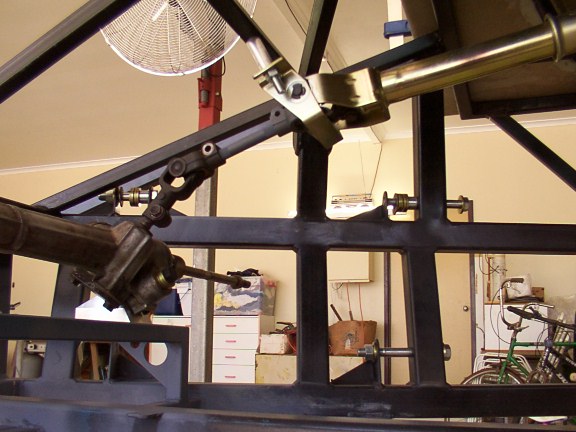

Here it is anyway, I scanned it at work.
I had to extend the width of the pivot points (~2" per side) to help with bump steer. Factory RF's used an earlier model rack which was wider.
I also raised the rack the same way as yours and rotated it to get the input much higher (to clear the pedals).
Moved it ~2" rearwards to increase Ackermann.
