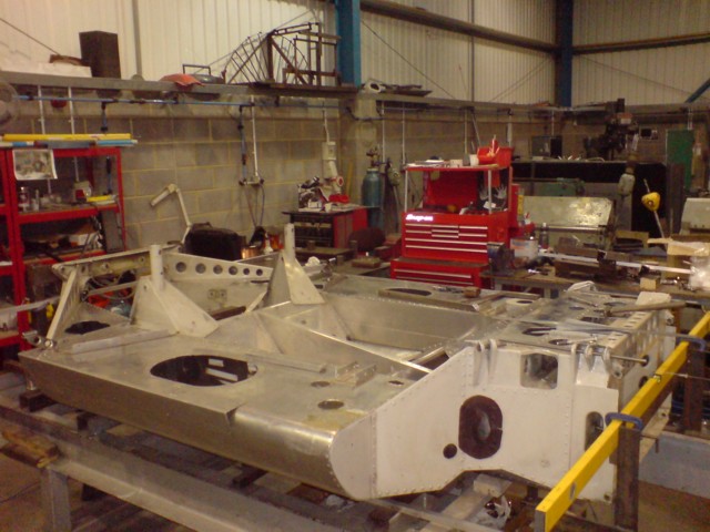

Pretty happy with the way the tub has turned out to date. I'll post some pics once the front end is back on. Needed a minor rework to get it spot on.

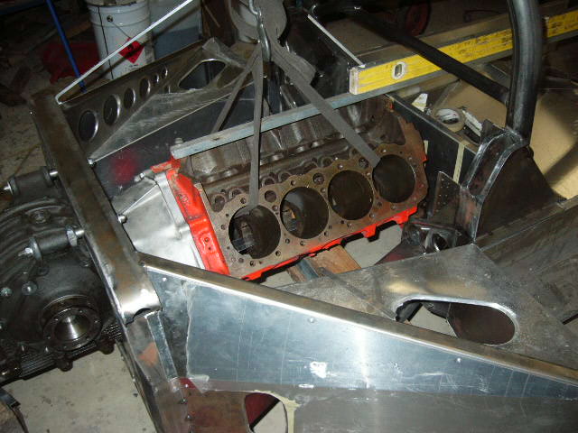

The engine mounts are made of tubing with a flange welded to it. I have GOT to find them or a photo of them as they are not easy to describe. They mount to the chassis with single long bolts. Maybe MK IV J6 t70 build thread would show something. The big engine mount bolts are shown in this picture but the mounts are not present....

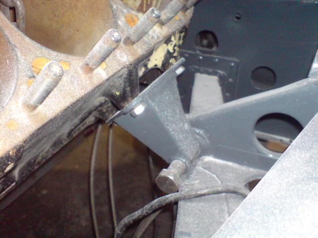

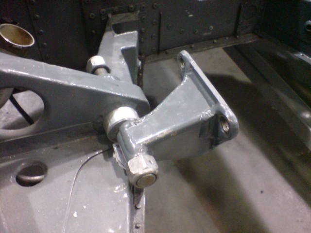

O.K. Remembered, so one pic of mount in-situ with block and other just of mount in chassis.
Johan. Seen a few 3b mounts like yours. Worst one had sheared the main tube completely. Our new ones, I think there is a pic in J Starkeys book, are much more substantial. Plus the radius rod joint locates in the vertical plane rather than Horizontal.
Regards, Darren

Thanks Guys,
The block seems to be sitting too low in our tub. These engine mounts confirm it. I'm estimating they are around 2" long. The rear bulkhead may need to go up a little or the upper gearbox mounts are drilled too low.
