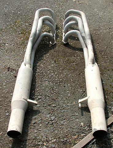

Hi have some formula 5000 headers might do the job for you they foul my chassis rails they are solid just need repainting and altering to suit. They have no silencers the pipes are equal length in the silencer like chambers (novel approach!!) have sent you a private message
sent one back at you, very interested.......

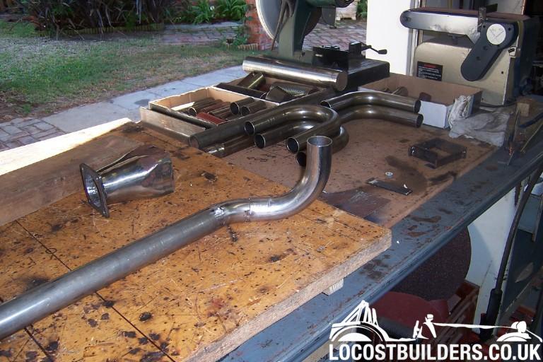

Those do look great, but I bet theres a tonne of work in them, do you have build up shots, or even a "shopping list"of parts! It would be a buzz having a set of headers like that on the project. How do they sound?
Yes they were a lot of work, but they do sound fantastic!
I used 26 off 90 deg carbon steel mandrel bends and laser cut 10 mm thick head flanges. Pipe welds are metal finished flush. Each header pipe is 850 mm long, (tolerance +/- 10 mm). Collectors taper to 2.5", fabricated from 3" pipe. Silencer cans are 500 mm long, made from 4" stainless thin wall tube, with 2.5" perforated tube inners. Carbon steel parts sandblasted and painted with matt silver high heat paint. Once they are proven I plan to ceramic coat them.
What I did:
Bought 90 deg mandrel bends in 38 x 1.6 mm mild steel.
Had head flanges laser cut, so that pipes are fitted with a butt joint to flange.
Bolted flanges to head with wood plugs fitted sticking out of flanges to give me a positive, but movable location for the first bend.
Drew circles on plank of wood the same diameters as inside and outside radius of mandrill bends.
Marked off angles 15, 30, 45 etc, on circles to use as a template to ensure I always cut the bends true to the pipe bore.
Made up first pipe for #1 cylinder as this had longest straight section by tacking elbows, cut elbows and straight pipes together. Try to cut to exact angles where possible.
Cut #1 pipe to desired length, using calculated length along mean pipe radius to determine total length (straight length+x deg+x deg etc).
Now that position of collector is established, by trail and error join #2 pipe to collector, by joining bends in more than one orientation where necessary.
Don't cheat by cutting joining planes not perpendicular to pipe bore.
I found it easiest to work from rear to head, and keeping the flange to pipe joint loose till the last join.
Repeat for #3 and #4 pipe.
Depending how keen you are on keeping the pipe spacing more or less consistent and parallel, this can drive you crazy.
I found it helped a lot to make some square frames from flat bar to fit around the 4 pipes where they ran parallel, to keep them in position while tacking bends
Once all pipes are tacked up, remove from flanges again.
Weld up all pipes fully, using TIG if possible, or MIG.
Metal finish if required or desired
Reassemble manifold, and do final head flange to pipes and collector welds. Remember to fit closing plate between pipes at collector.
