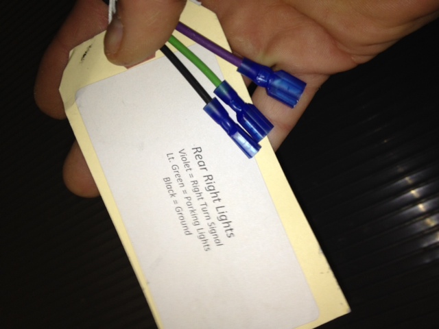

These are the only connectors I have for the tail lights.

Once you cut the four connectors from the rest of the trailer wiring kit (which is now garbage) you are left with the connectors that plug into the lamp sockets as supplied with the lights. I am not using the ISIS wiring so I had to buy the 4 connectors for the Dakota lights.

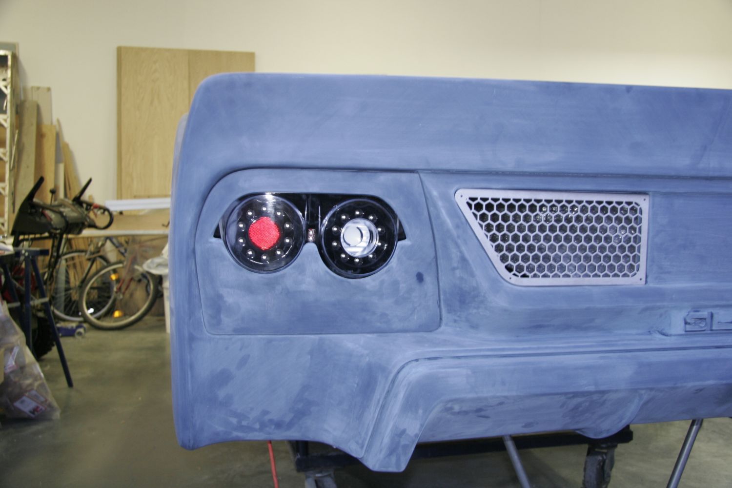

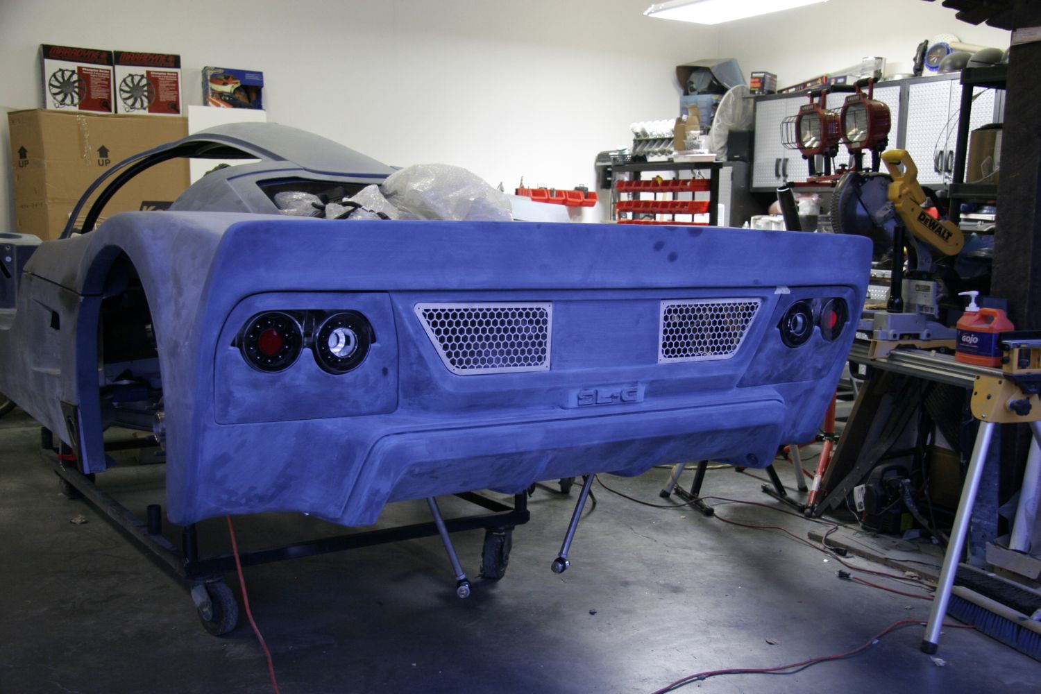

Ok the LEDs showed up here what they look like.I have them just sitting in there so they are kinda crooked. if you haven't cut into your covers yet to fit lens that Fran sends you then you will be ok. They fit the same in the rear clip opening, but not exactly in the cover I will have to do some glass work to make them fit exacly but they should look really good in a finished car.
Me Likey,,,,,, guess I just added $250 to the budget...lol.
Thanks for the pictures Grant,, You were right, they do look good.
