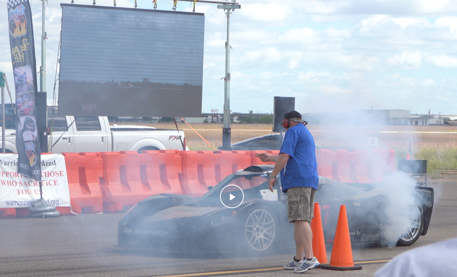

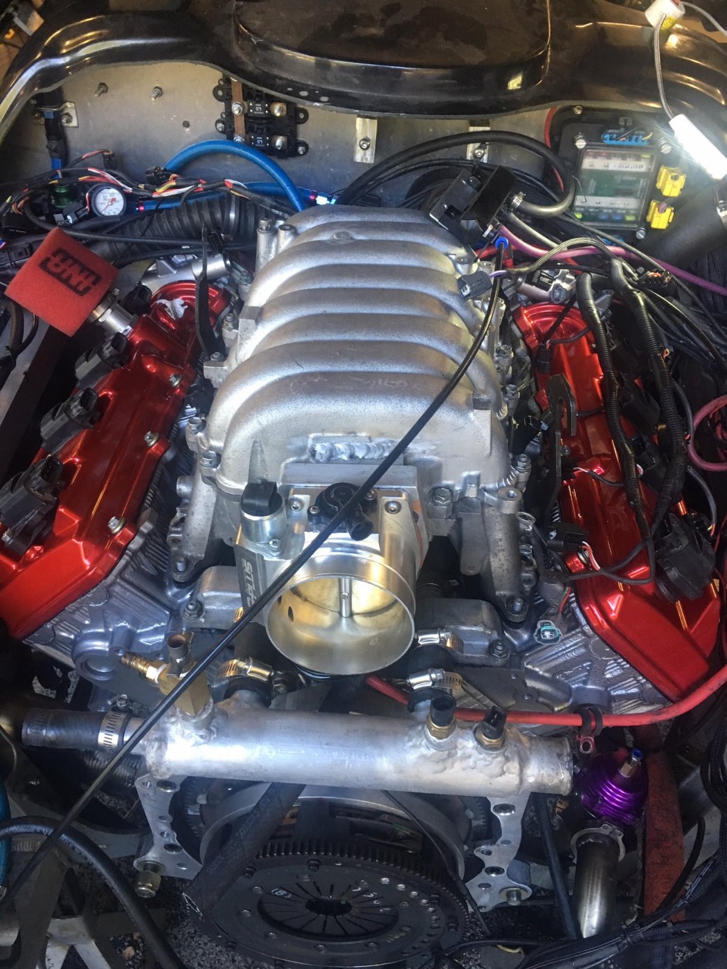

On Saturday morning, I decided to start the car a bit earlier to get some more heat in it and mis-judged. The car was at 260 degrees when I left the line. Before the 1/4 mile mark the engine lost power. I pulled to the side in case I was dropping fluids, and after I did a hose up front let loose and covered the windshield with water. Coasted to the first pull off area and was a couple of hours before I recovered the car and got it back to my trailer. Turned out the loss of power was because the throttle body came apart. It's an LS1 mechanical one. Good thing it decided to close under boost! All of the parts where laying on the trans-axle, including the return springs. Got it all back together (including drilling an indent on the shaft for the set screw), but not in time to make another run Saturday.
On Sunday I missed the 1-2 shift, hit reverse, then slid it over and got 4th, finally found 2nd.... Well that killed my speed. Was 108 in the 1/4, 148 in the half. The car was pulling HARD. Ran it to 7300rpm in 4th, shifted to 5th and ....nothing.... car just stopped pulling. So I let out, shifted to 6th and let the car coast. Coasted through the mile at 143. Turns out there was not really a problem. The car is taking a long time to recover boost after a shift (may be a BOV issue, and probably need to setup No-Lift-Shift). In 5th with no boost, it just did not have enough horsepower to accelerate. If I would have kept my foot in it, it would have gotten back on boost. Oh well, car is still in one piece!

The VEs look great. The intercooler is working great (IATs settled at 116 with 90 degree ambient). So I am confident the engine will like more boost (assuming it holds together). All was good with 20psi on pump gas. So with E85, more boost and some more aggressive timing I am reasonably confident this package will be near the 1000hp target.
